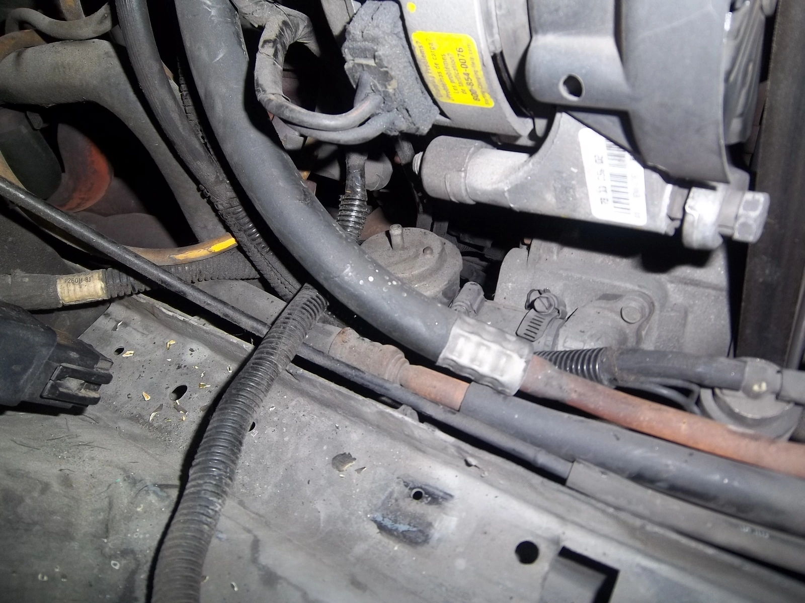

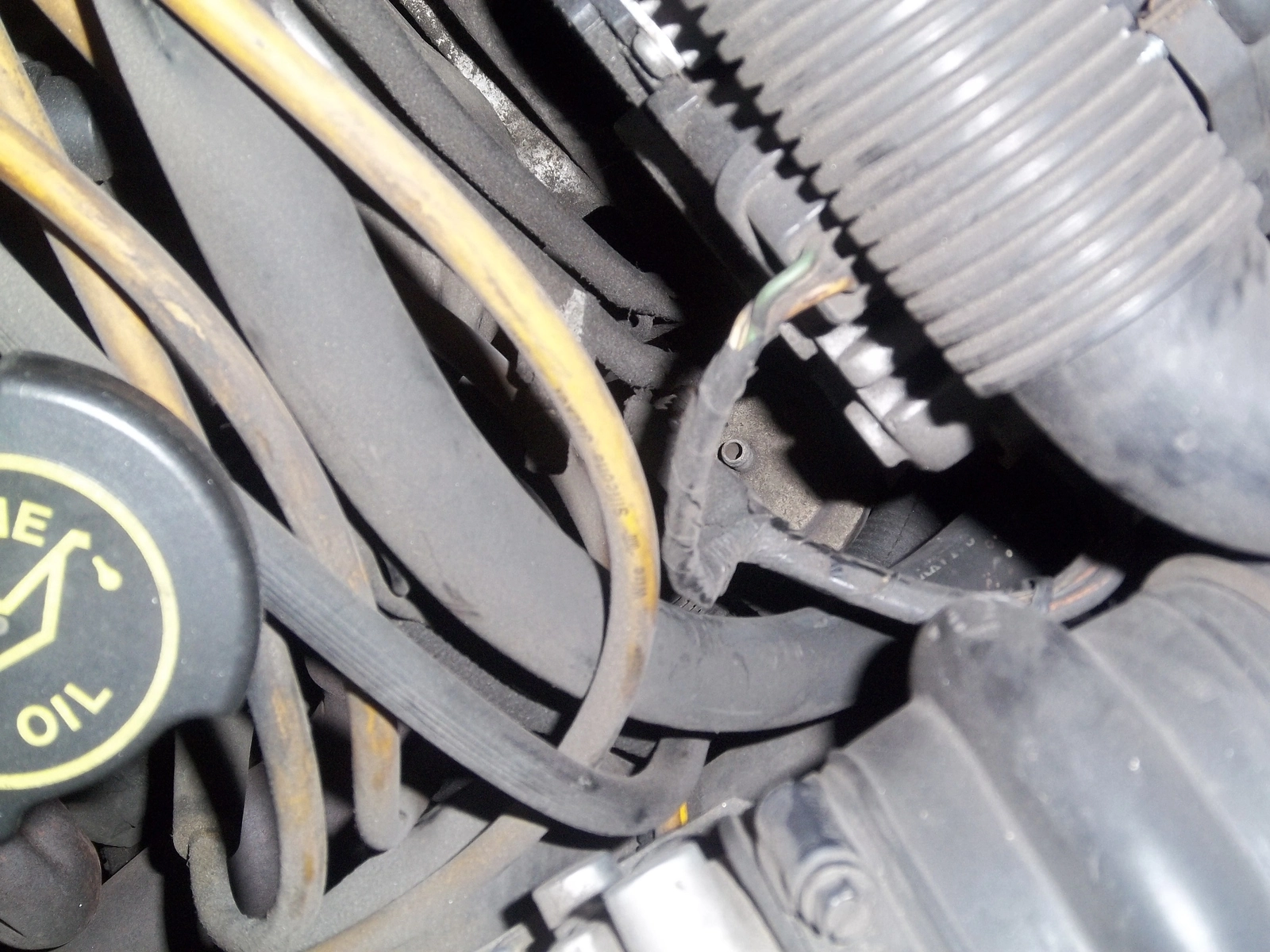

Can anyone please tell me where the other end of this puzzle goes. There are no lines laying around it and all i have found is what is in this picture. Any idea where the hose ends up from this part pictured? What is this part pictured that is missing a vaccum line? Any help would be greatly appreciated.

Is that the metal top of the air divertor or air bypass valve without a vac hose? The valve would be hooked to heater hose like hoses from the smog/air pump. The vac lines come from the TAD or TAB solenoid on the back of the passenger strut tower. If I am seeing the right part, Jrichker has posted the diagram to get you "lined" up many times.

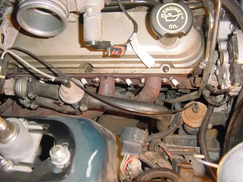

http://www.stangnet.com/mustang-forums/attachments/mustang-fix-005-jpg.68953/
one of these vacuum hoses fits there. they are cut to length and usually hold "memory" to where they once were hooked up.

I still have no located the missing line, the diagram is great but i checked both relays on the strut tower and everything has its place and no empty spots for another line. I know it must be something simple and im missing it but if you guys could take another crack at helping me i would be very thankful. Pulled the air filter box up and took a better look, still nothing. Here is a better pic.

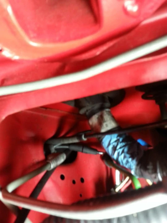

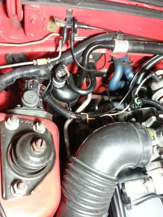

this is the mess of vacuum lines and i think the white one is actually the one you are needing to attach. http://www.stangnet.com/mustang-forums/attachments/mustang-fix-005-jpg.68953/

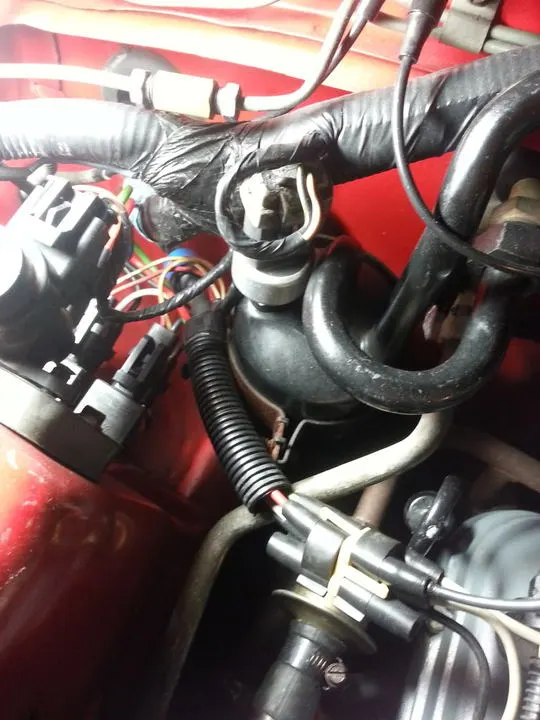

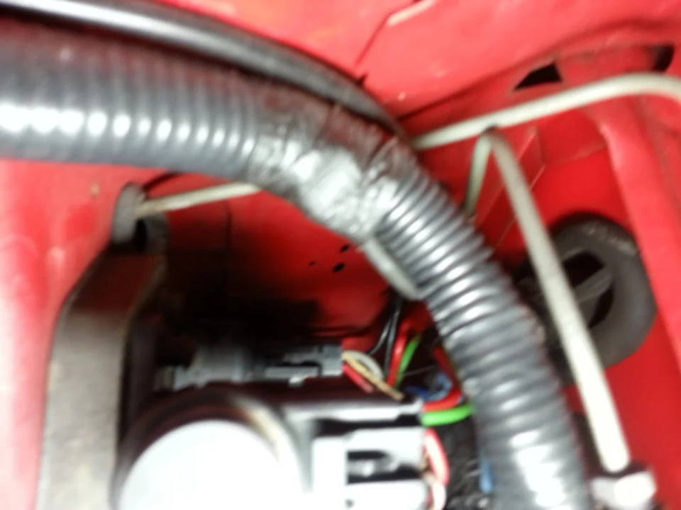

Does this pic help?

jcgafford said:
there are not 4 lines into the fender for the smog/egr/etc. it branches off for these lines.
In this pic, right near your intake elbow are the vaccum lines you need.
there are 2 white lines, and 2 black lines. They are hard plastic lines.
The two lines that take a 90* bend to the front of the car are the two you should be concerned with. They go to the two solenoids on the air pump air line. Follow them and you might see one just hanging...or it could be snapped off. In which case you can get a lenght of vacuum line, slip it over the broken tube and connect to the appropriate solenoid

Maryland Stang said:
Does this pic help?
THANKS for this picture! I have replacement parts waiting to go on. The PO took them off for racing or some reason, and I wanted to make sure they ran mostly the same as my old 79 had them run.
Not to hijack - BUT -Good ideas or Bad ideas? As close to the headers as the hoses run, has anyone thought about using silver, reflective heat shield, especially on the lowest hose that runs to the exhaust? It looks like the longest Z shaped hose is just waiting to be cooked too. I also wonder if Zip Ties from the hose to the strut tower might get a little more heat clearance.
Does this pic help?
great picture, thanks so much.
