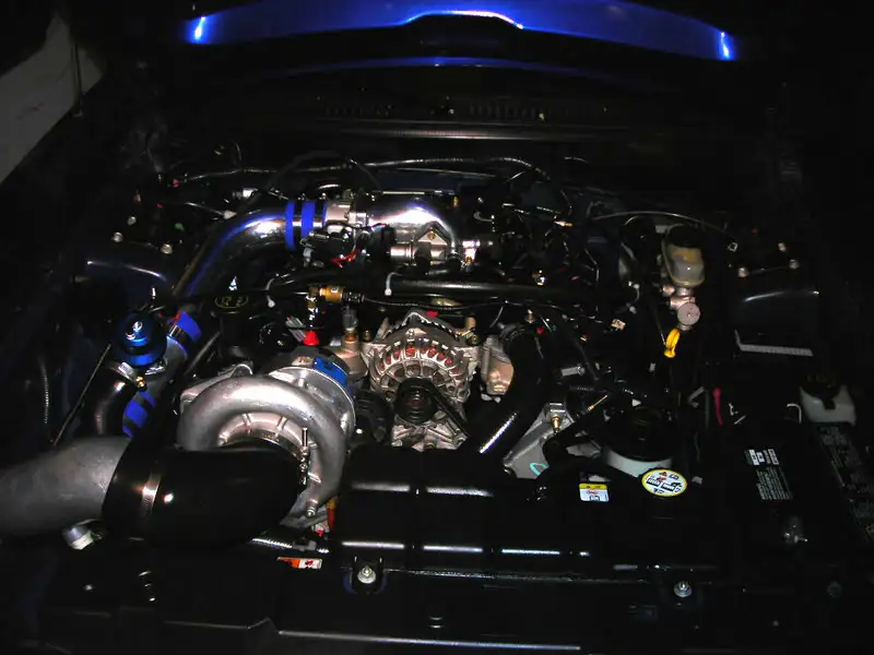

is the best! ever since i put on my FMIC with an HKS SSQV immitation valve, i had bucking/surging issues, put on the maxflow and BOOM!!!! all gone!!
that and i put on my bbk/roush 75mm tb!
PICS!!
dyno & gear fix tomorrow!!!
new TB with silicoen union that i had to stretch over!!!
maxflow valve and flanged pipe ($$$)
valve installed
teh motor :)
yeah yeah yeah bad lighting, blah blah blah my camera is real picky
that looks nice! how much did that cost and whats the difference between this and stock and was it hard to install? I notice that your intake is 2 piece, does that come with the kit?
as compared to the vortechs stock bosch valve? for the money, i tbetter be lightyears ahead!!!
when i put on the FMIC i installed a different bypass valve, since the stock one uses hoses and barbed fittings.
by two piece to you mean the lower/upper plenums? thats how every 4.6 is designed. plastic lower, metal upper elbow, then the TB
the only issue with that vlave is that the discharge is SO big, and the inlet into the power piep is small
on a side note, i was GOING to race this weekend, but since i had to drop $700 at a shop today to find out that at 380rwhp i almsot pegged the MAF, and ran out of fuel. which i pretty much already knew........
