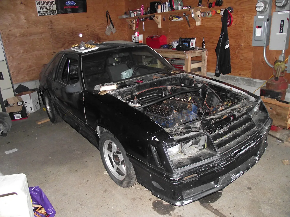

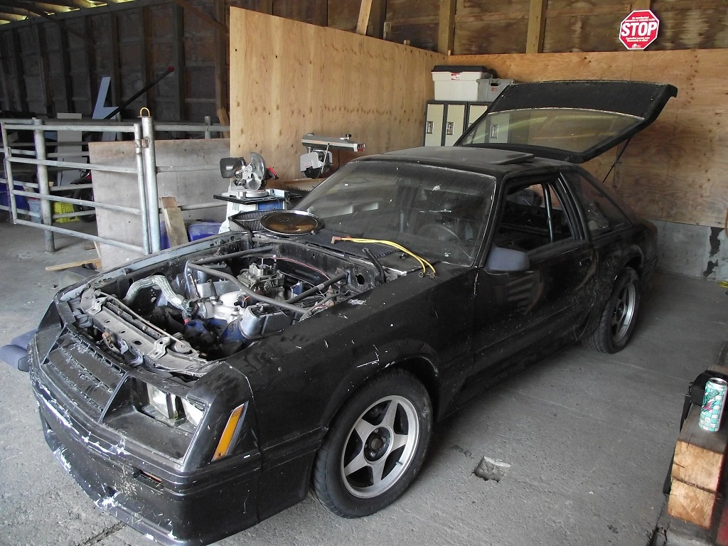

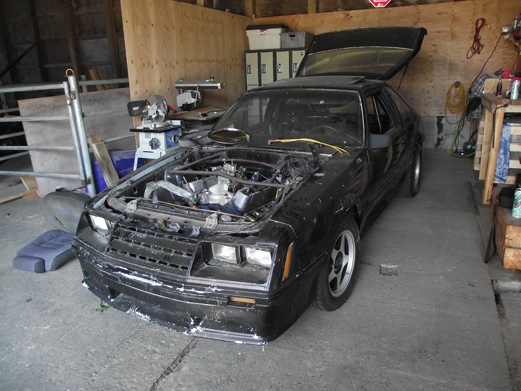

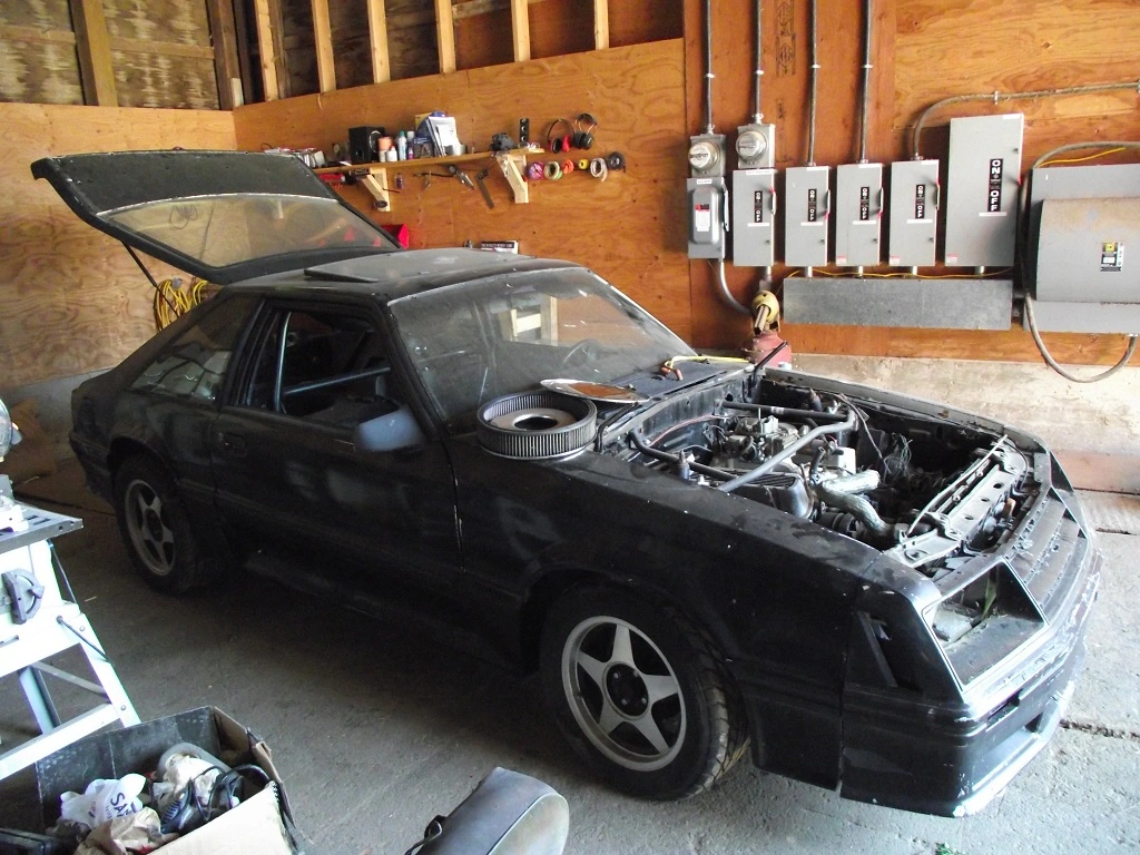

ok so this was the first day I got it, had been sitting outside for a bit.

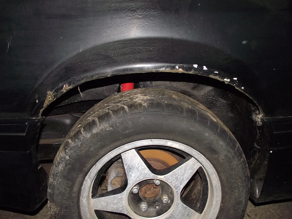

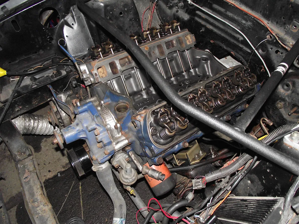

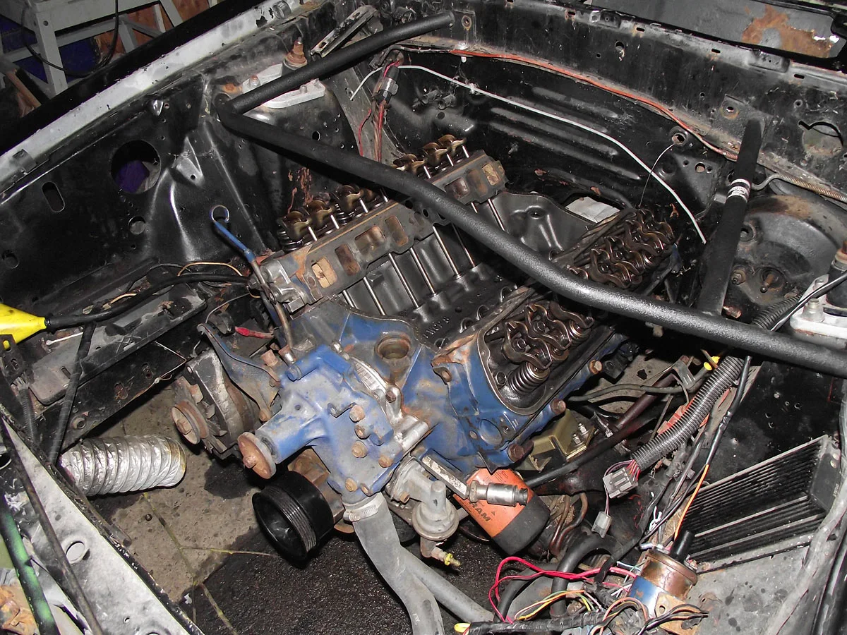

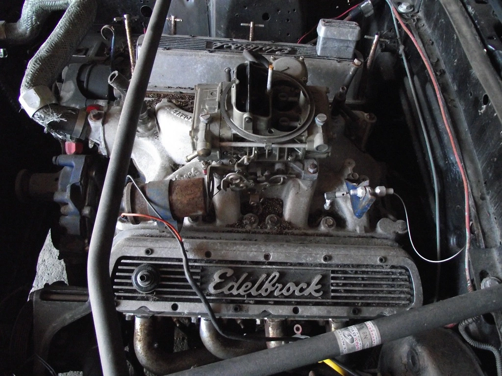

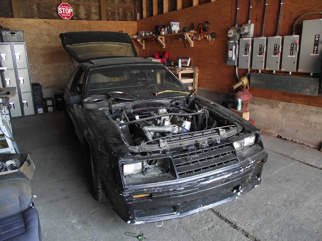

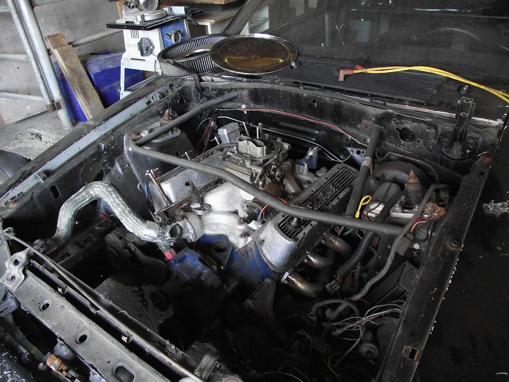

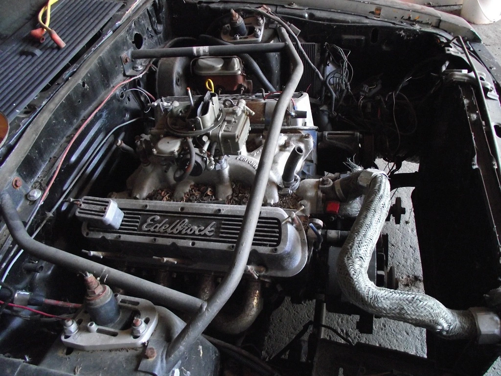

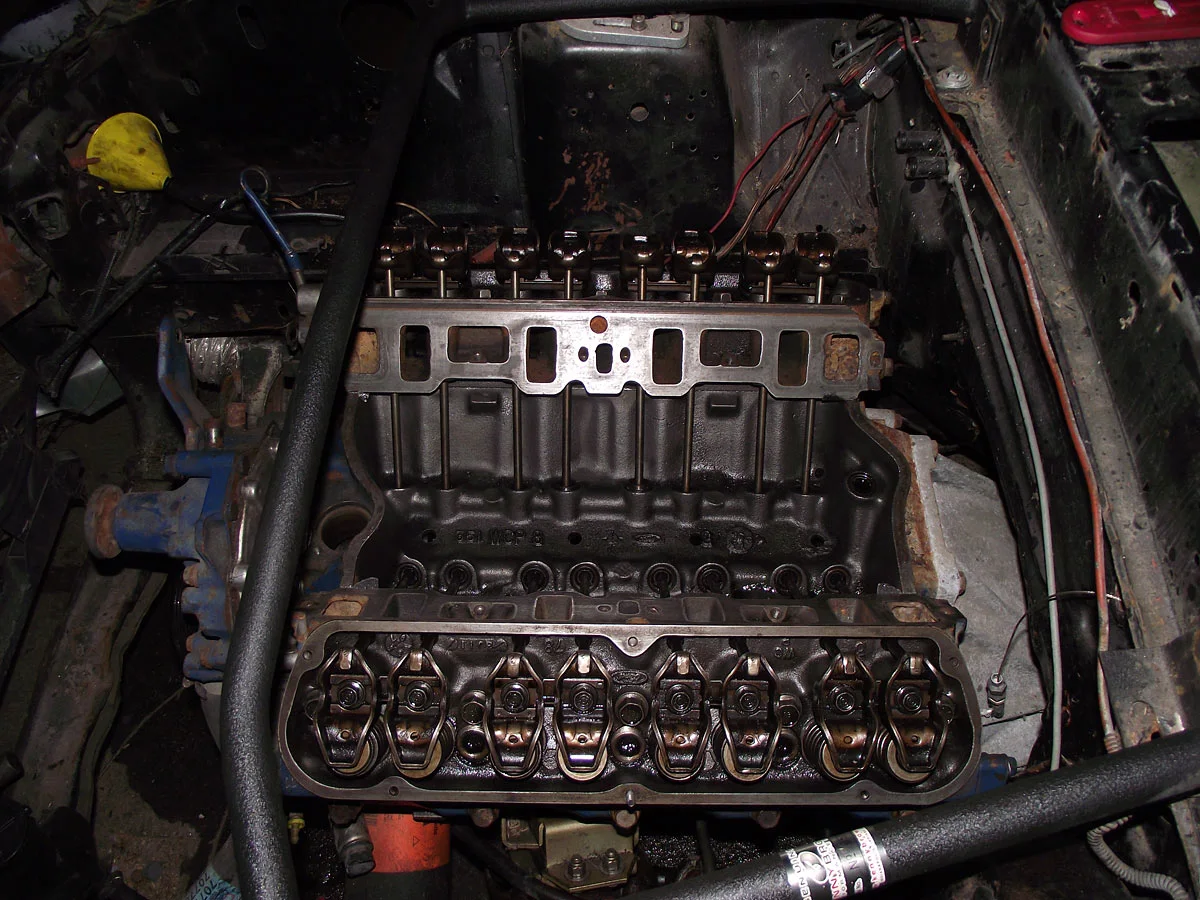

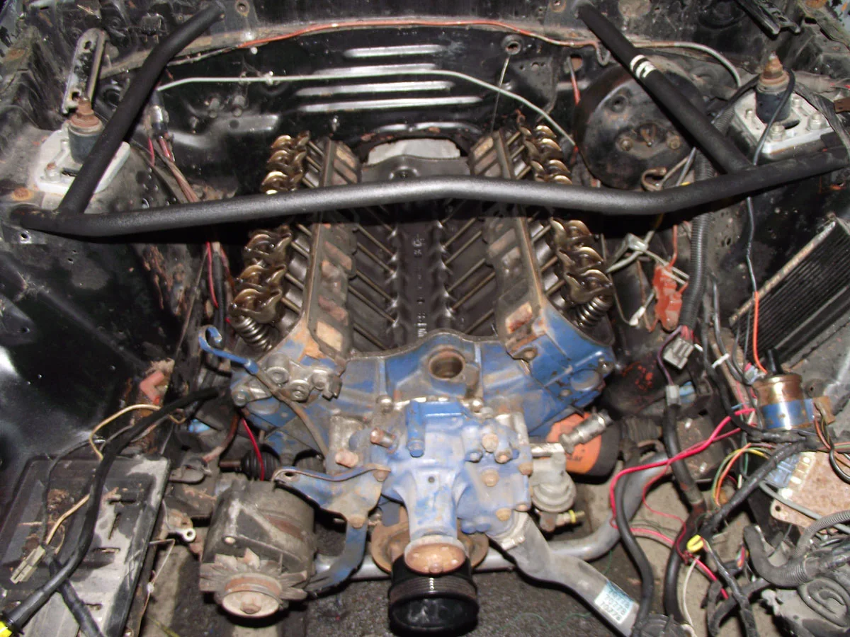

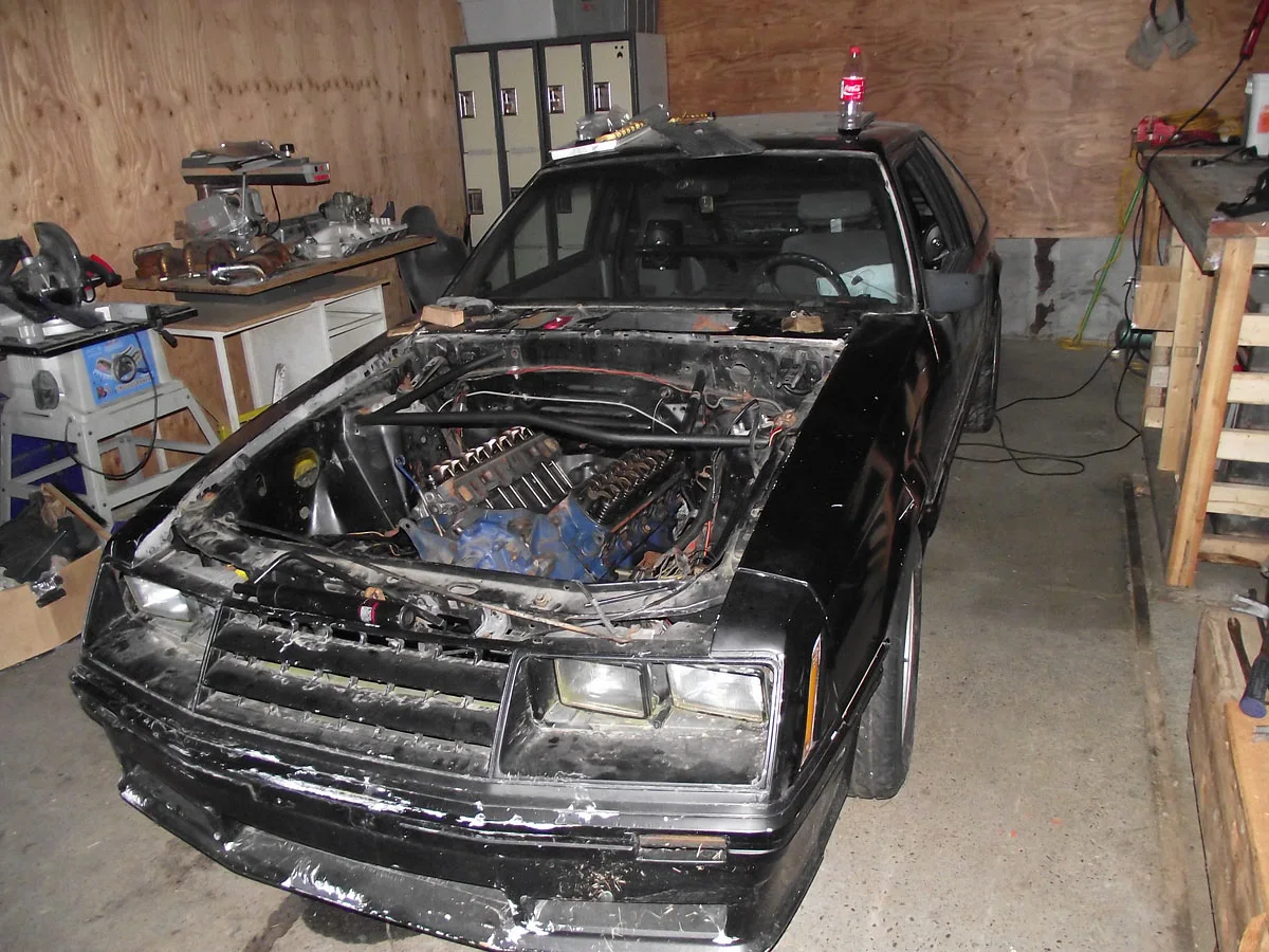

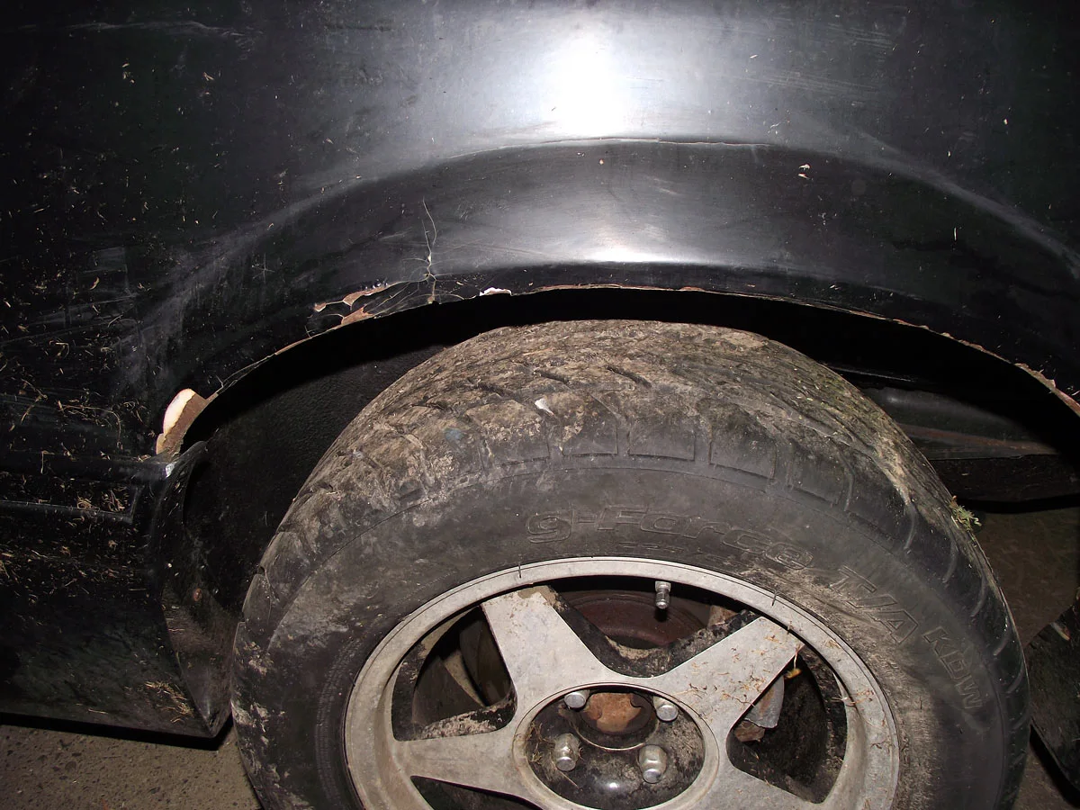

this is after i got the the engine unseazed and new gaskets in a put it back together, the valve covers were put on with a liquid seal and both broke on removal. it has some rust in the wheel wells, and surface rust on the floor inside. and i dont have an intake manifold gasket yet.

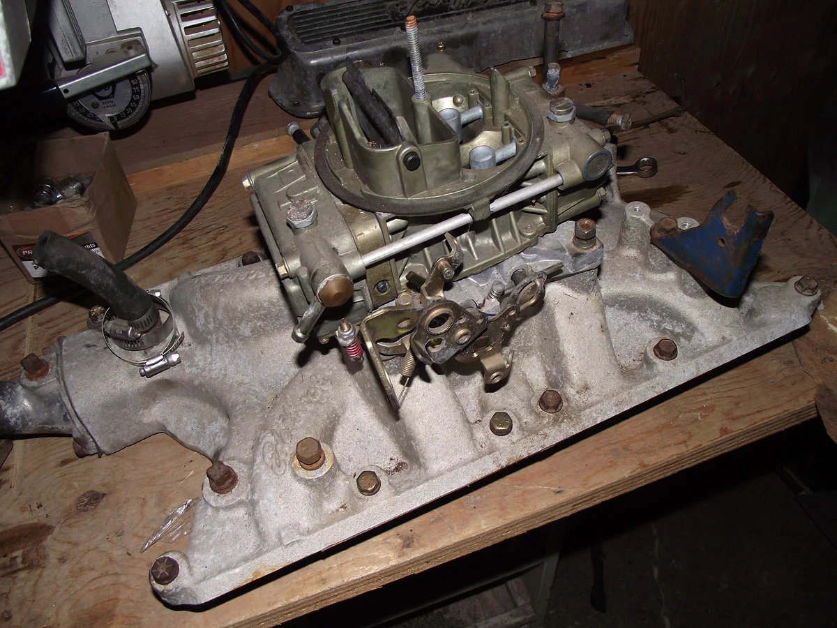

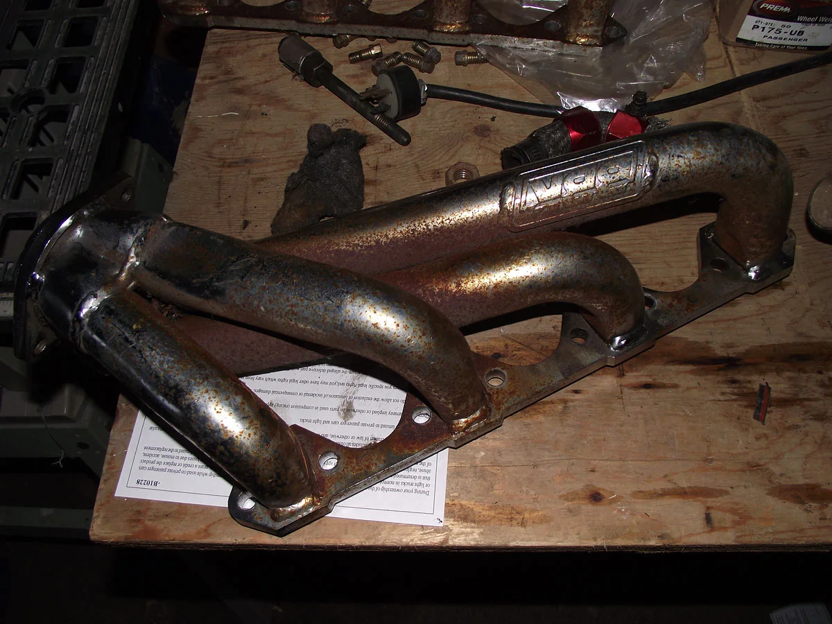

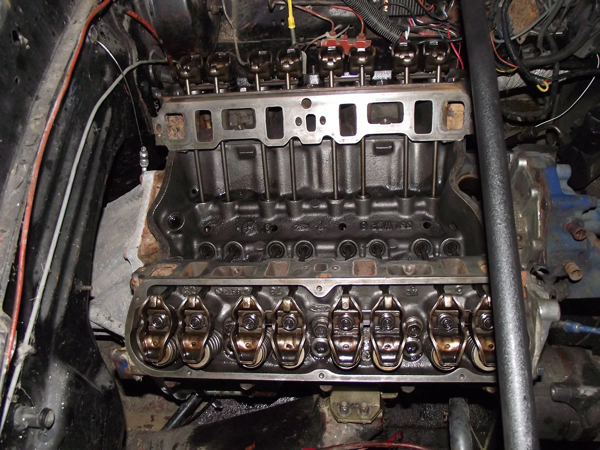

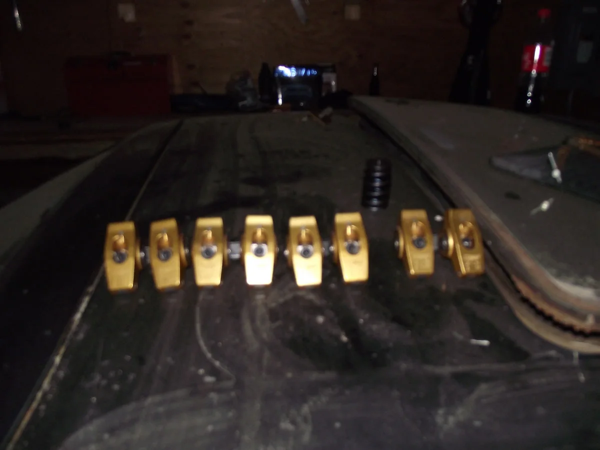

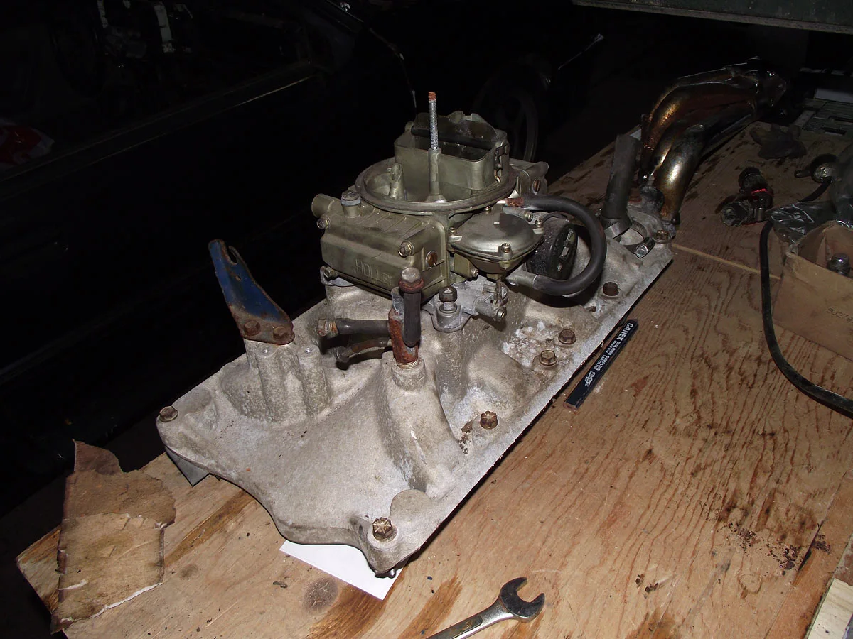

my cousin had roller rockers sitting among the tons of other extra parts but there isn't a roller cam in it. so i have no use for them till i take the engine apart again which wont be till at least next year. so i do have roller rockers that will fit a 302 with the valve springs that I wouldn't mind getting rid of, never been used. sorry for the blurriness, if someone interested ill take better pics

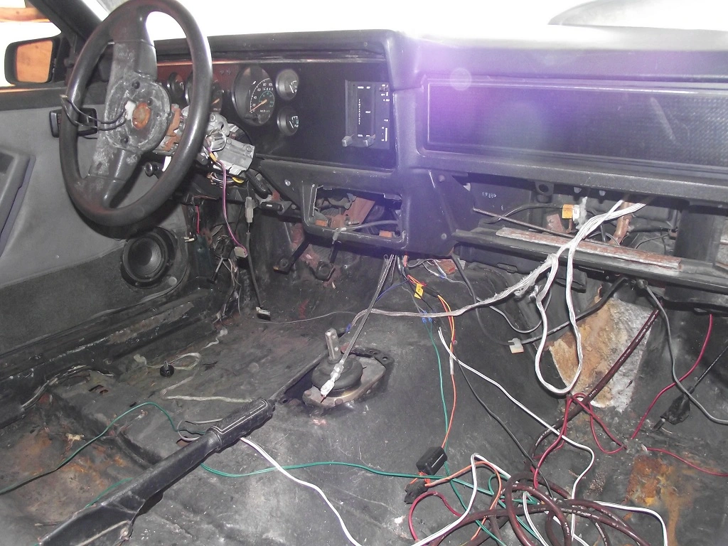

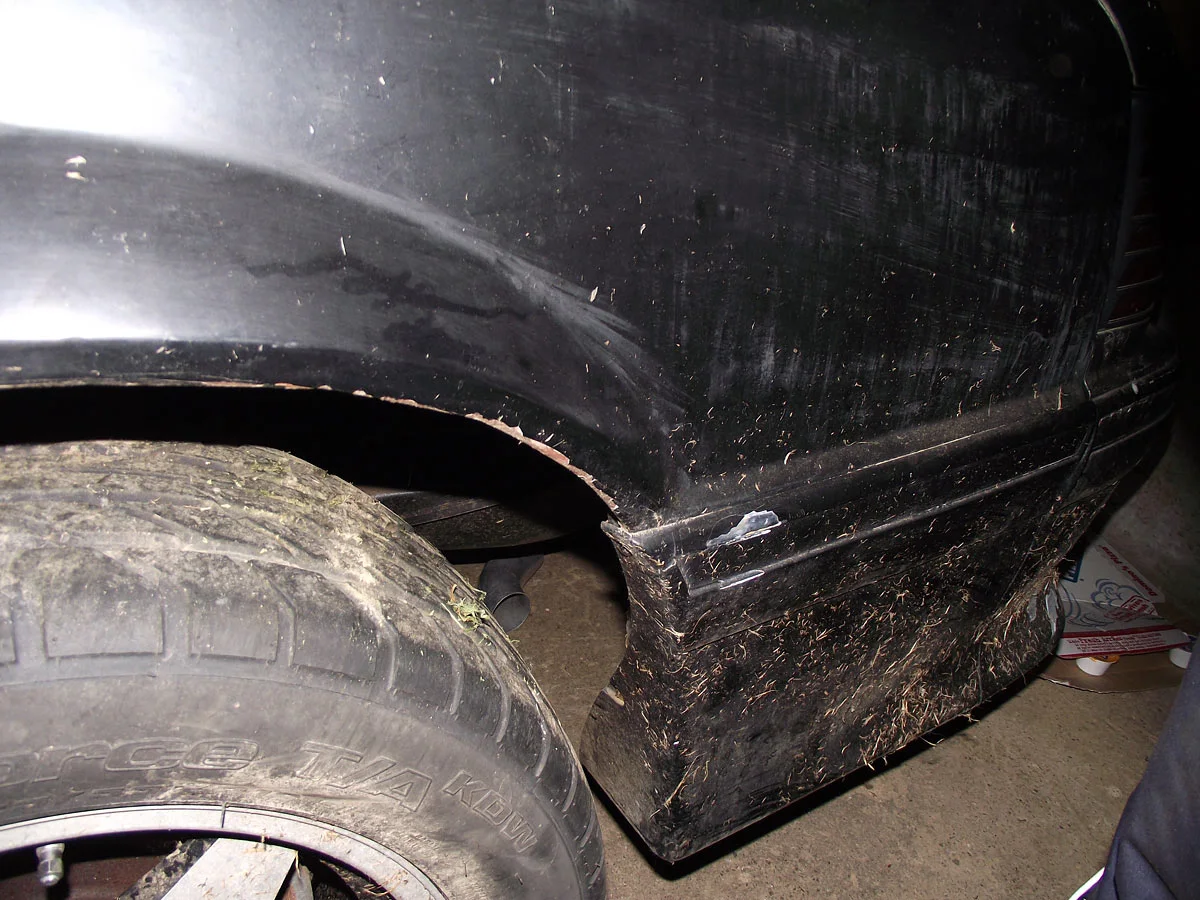

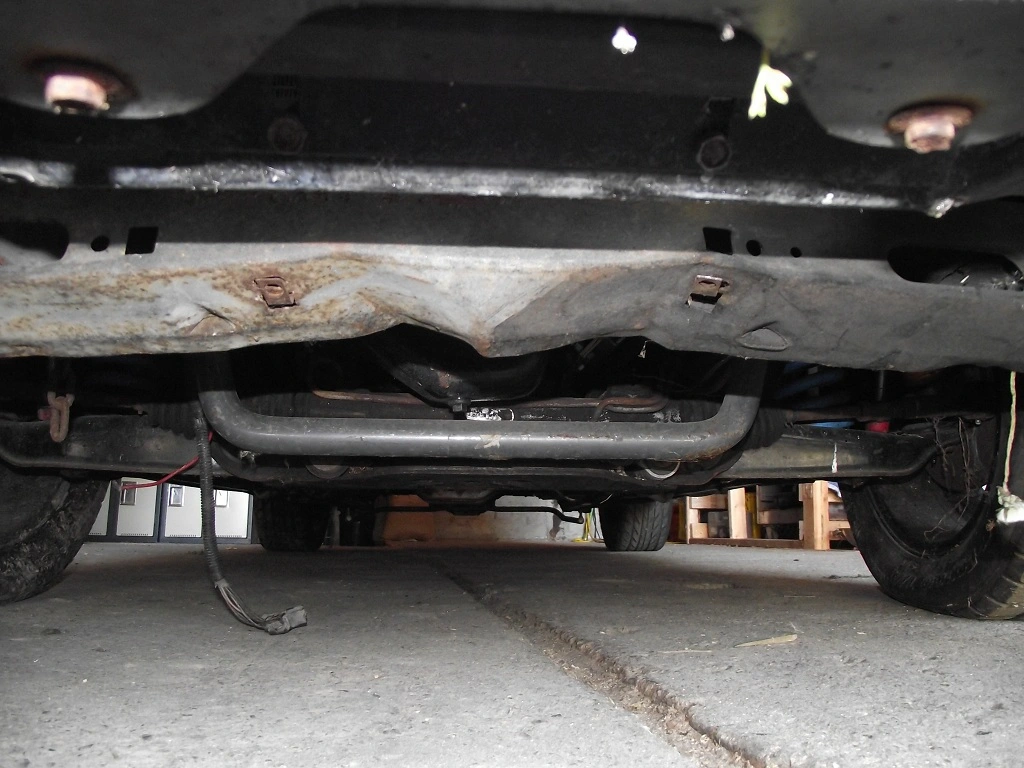

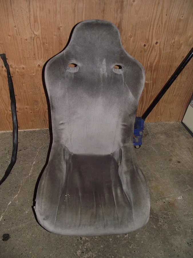

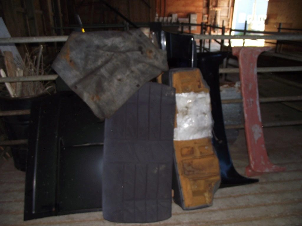

here is some other randoms I have for now. the only rust on the car that's really bad the rest is surface rust . and there's the racing seat. it needs a good wash which ill be getting to once we have an actual couple of days of sunshine

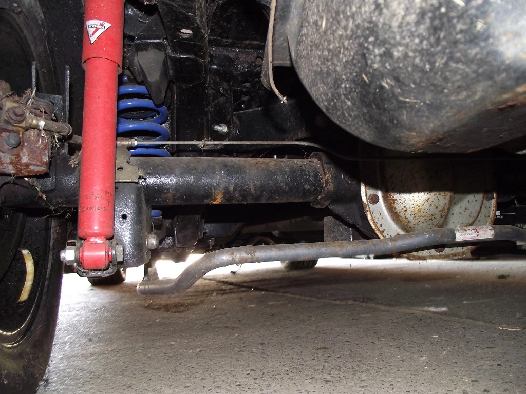

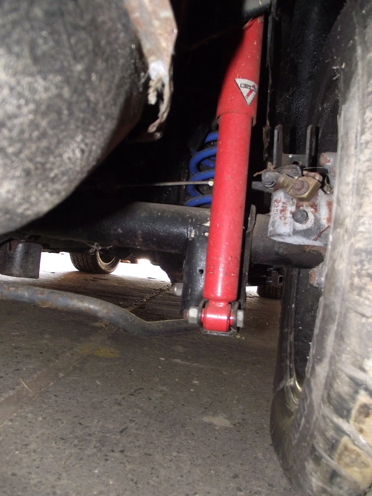

ill be taking more soon i have to get some of the 4 link rear end and the sub frame. hope you enjoy the pics

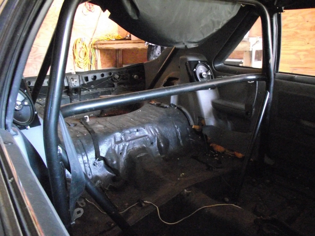

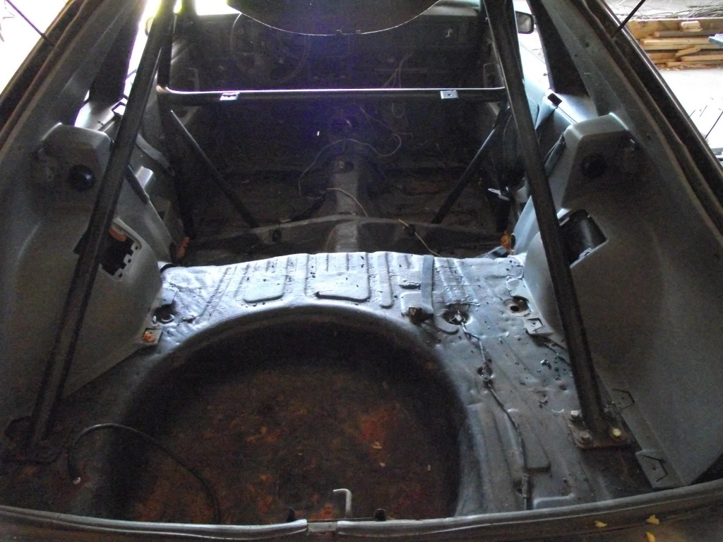

Good pics.
Did you see any cast numbers on the block? Particularly on the driver's side under the header? They might start with a letter with as C5, D9 or E3 or something like that? Might help ID what the engine is out of. Early 351's weren't roller cams, but I beleive they can be retrofitted.
Is the trans a 5-spd? It looks like a T-5, which is a fairly weak trans. Hard to say if it's a OEM take-out, or a Z-spec trans without getting the tag info off the case.
Rear end looks like standard 86-93 Mustang 8.8 axle. I do see Koni red shocks, but i don't see the quad shock setup, but i see the mounts.
Looks like the rear was convereted to disk brakes too. Turbo coupe conversion probably.
All i can tell you from those pics however. Looks like you do need a lot to get it back to being a driving car though

I will look at the engine when I go out next. I have also sent an email to my cousin to see what he knows about it still. It is a 5 speed, hoping my cousin can tell me what it is. If not I'll get under it. I remember him saying the gears are different. Yea it's got Koni shocks and new springs as well. And yep has 4 disk brakes. This is what worries me though. There could have been more stolen off of it than I already even know. The car was basically done. Now it's missing the electric fan, distributor, he took the 4 piston brakes off the front, and its in more pieces than it should be for a guy who was only supposed to be doing the sub frame. So I'm concerned more is missing. What I have to do is get my cousin out and get him to look at it for the first time in a long time and for him to tell me what's missing hopefully.
I have a 70's model 351 Windsor in my truck, has a flat tappet cam yet I have 1.7 roller rockers on it. The cam being flat tappet or roller doesn't matter since the rocker arms are touching the valve stems.
