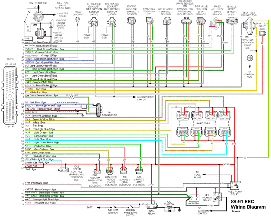

Ok, the local speed shop (Extreme Motorsports) talked me into getting this unit. So here I am with this really cool looking controller, but they want like $100 to install it! The instructions only list Imports... go figure. Anybody have one of these and know how to install it??? :rolleyes:
hmm... I had one on my turbo eclipse. I had no idea that you can use it on a mustang. I guess you going to have to figure out which wires go in the computer for the rpm wire, o2 wires, power, ground, turn on, and i'm sure there are other stuff. Most important are the mass air meter input and output since that is what a safc changes.

its from here: http://www.veryuseful.com/mustang/tech/engine/
