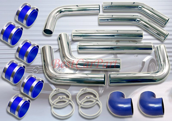

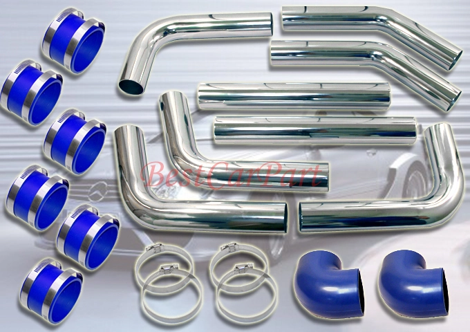

The piping from the vortech to the intercooler was done by a company or by yourself? I am wondering, since i have been looking for a company that sells piping for vortech intercooler. BTW-those are some good numbers. How did you like kaufmans? I opted to go to JD's instead of them. Thanks for any info.
Its a universal piping kit from ebay. I already replaced the worm clamps with tbolts and the silicone elbows are strictive inside the middle looks like a corner. I just ordered new ones with a universal id all the way through, other than that it works great. I just cut two pipes to size. Hers a link. http://cgi.ebay.com/ebaymotors/3-In...33742QQitemZ8067251382QQrdZ1#ebayphotohosting
