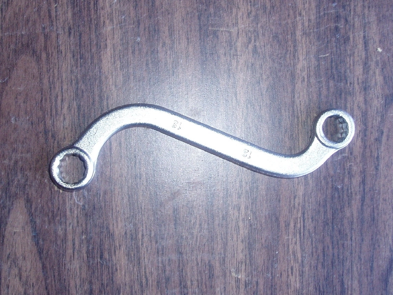

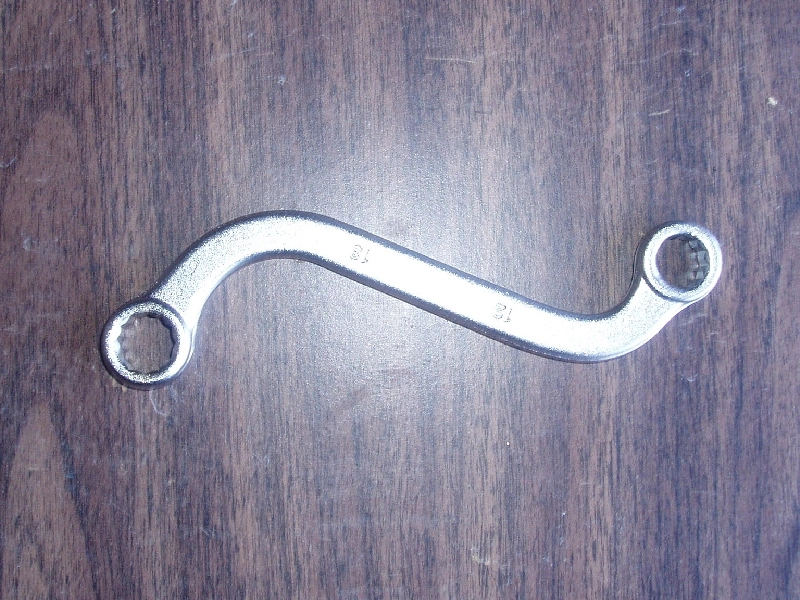

And there was someone posted little while ago that there is like this S shaped tool that helps greatly. does anyone know what that tool was?

as far as the tool goes, we had no idea we needed it for the install of my slp lts.. we just took a torch to a wrench and made our own :)
I needed the S-shaped to install the BBK Tuned Lenght Shorty Headers. It might help with LT's not sure though.
Here's an install article for shorty's, it will help with your install of LT's.
http://www.stangfreak.com/content/index.php?option=com_content&task=view&id=52&Itemid=1
Here's the wrench I refer to in the article.
