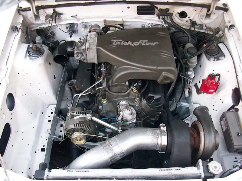

I just got the summit alternator bracket and I'm real happy with it. I've been wanting to get rid of the ugly huge stock alt bracket for a years, finally did it. I dont have P/S though. If you are using a 3g you will need to trim the little part that goes on the back of the alternator.
It's a Holset H2E, I've been working on the build for a couple months now, I have all the info and updates in my build thread. Hows your car coming along?
