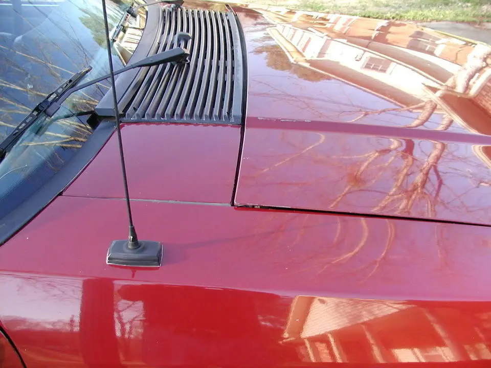

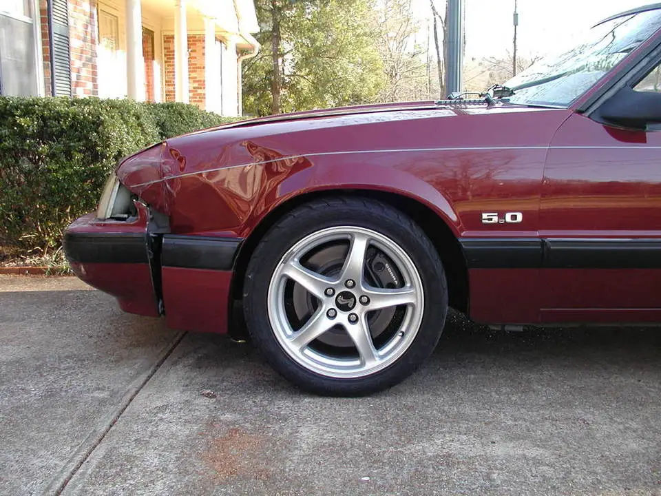

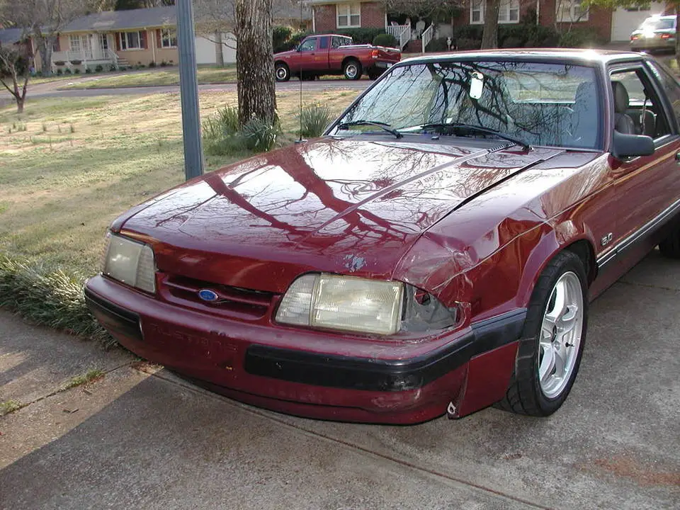

Just got in a wreck. Someone made an illegal turn in front of me. Did everything I could to miss them. Hit his front door with my left front.
I was following him on a two lane road with a turn lane in the middle. He put his left turn signal on and moved into the turn lane. He slowed down to make his left turn. Right as I'm about to pass him, he turns right across my lane and right in front of me. I hit the brakes and moved as far right as I could. It was too late, hit him doing about 15 - 20 mph.

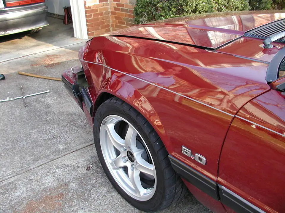

The damage actually isn't that bad. I expected a lot worse when I was getting out of the car.
Body experts, I need your opinion. I hope insurance does not total it. Tell me what you think.

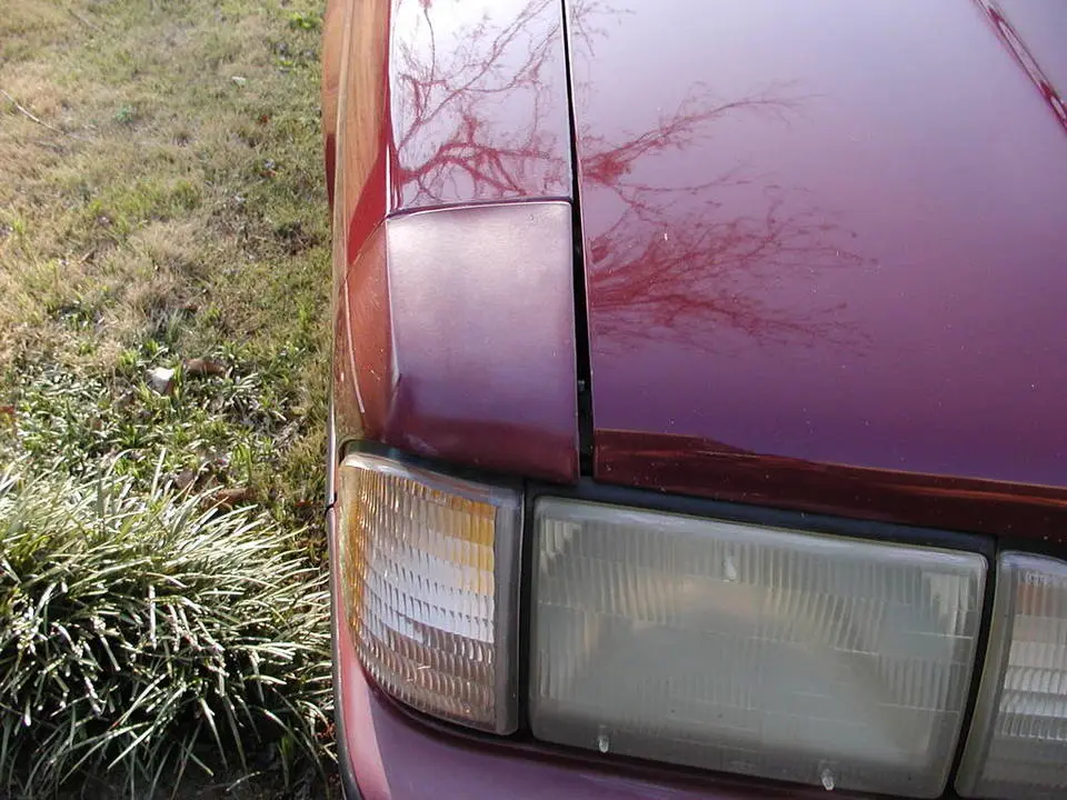

Ignore the headlight. It was broken. That is one of my dads old headlights.
About two years ago I backed into a box truck and it ruined the hatch and the spoiler on my 89 GT and the total came to 1200 and they totaled it. but I took the money and bought a hatch and spoiler for 50 bucks and painted it my self.

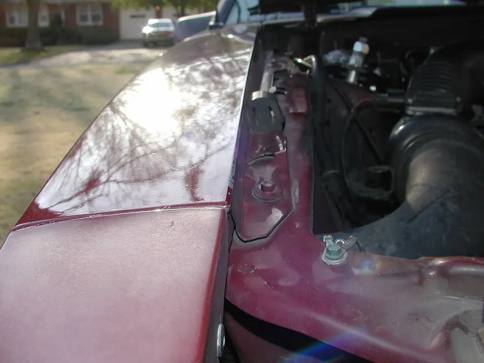

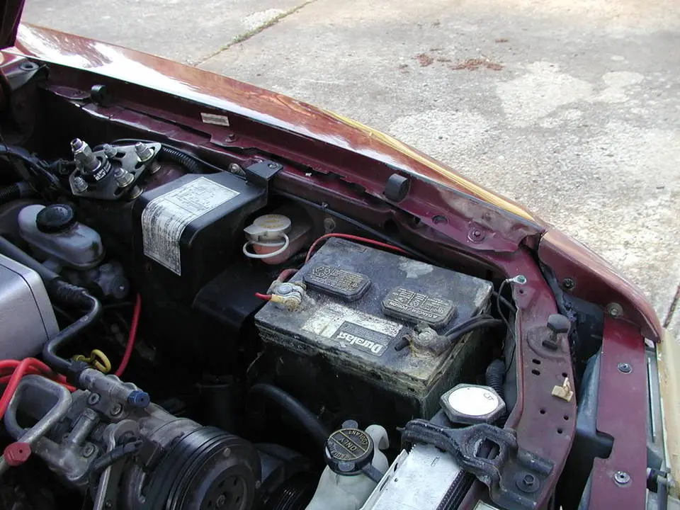

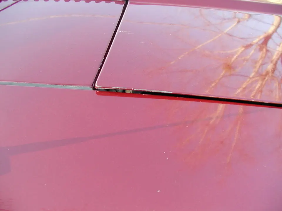

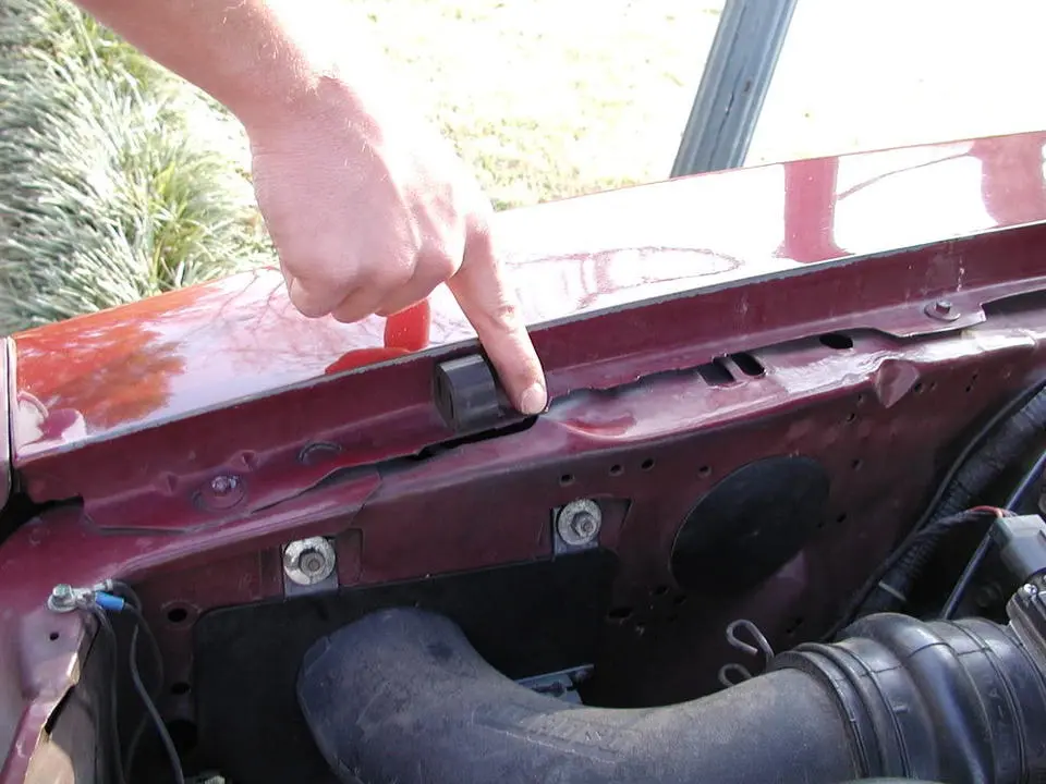

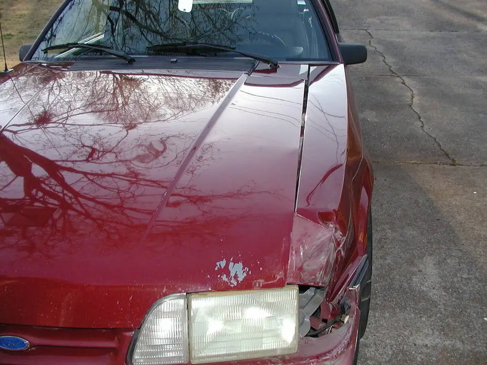

The only thing I'm worried about is BOTH inner fenders are pushed slightly to the passenger side of the car. The drivers inner fender is tweaked pretty good. But, the radiator support is in good shape.
looks like an easy fix... junkyard it up. get a few new panels - even your bumper is ok. i just wracked my lincoln into a guard rail and the bumper's indented.. thats what i'm worrying about right now. you guys make my job look like a massacre. relax, hit up the junk yard, find your panels, unbolt, bolt, align, and ship it out to maaco. no harm done, buddy. haha, take a step back and a deep breath and you'll be ok.
With both inner fenders creased like that. It's not going to be an easy fix. It will need to be straightened.
EDIT: the core has been shifted to the pass side about 1/2". It's going to make bolting up the new panels tough unless it's fixed.
I can't believe the insurance would total that. Go to a junk-yard, get the parts and find someone to help you bolt them on. Then ship it out to somewhere to paint it. If you lived closer I would help you fix it. Parts should be cheap, its an LX. Get a hood, fender and bumper. I wouldn't fix the little crease in the core support, no real reason IMO. If you have ANY questions let me know, I'm a painter in a shop(But can do body work also). If the insurance company does total it, I would try to argue it, I had to do that awhile back for my car - they totaled it, I argued it and had it appraised, then they decided to have it fixed. Yet again, let me know if you have ANY ?'s, I'll do my best to anwser them.

EDIT: Looking at the pictures more, the core support SHOULD be fixed, but if you don't have it fixed I don't think it will have any bad effects, but yet again - I'm just a painter, so listen to other people that actually do body work.
I agree, easy fixer :D
As for the core support, is the fan still in line with the shroud?? If so I definitely wouldnt worry about it, but a stated before you could run into some snags when bolting on new parts. Worse case I couldnt see a frame shop hitting you for a whole lot to straigthen it, not alot of pulling to be done.
I do bodywork for a living, not a backyard bodyman. That needs to be pulled on a frame bench/floor pull and needs to be measured. Unfortuanately, the value on fox body's is next to nothing so as much as a door ding will total them out. What I would do is take the front sheet metal off, bring it to a shop, have them pull it and measure it and test fit the panels and then ask them how they prep the panels for paint (grit wise, different from shop to shop) do the prep work yourself, take the panels back off and have them shoot some paint on em. That will be the easiest, cheapest and best possible way to fix that. It definitely isn't bad but its not just a hammer back into place job. If you dont pull that, your front sheet metal and hood will never line up right.
they will total that. the shift in the inner fender liner is bad enough. my opinion. its an easy fix though. strip the fenders, hood, and front bumper off of it. send it to a shop with a frame machine and have them pull it over. that shouldnt cost you much. maybe a couple hundred bucks. then pick up the new panels and bolt it all on. if you dont fix that it wont bolt up easily, and youll hate it forever.
That's exactly what I'm worried about MACn89. I have no bodywork experience, but I've done everysingle mod to my car. I also work in the automotive industry (German OEM) and I could tell my looking at the inner fenders that it will probably need to be pulled.
