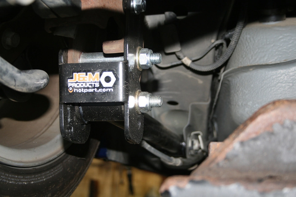

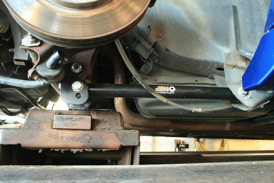

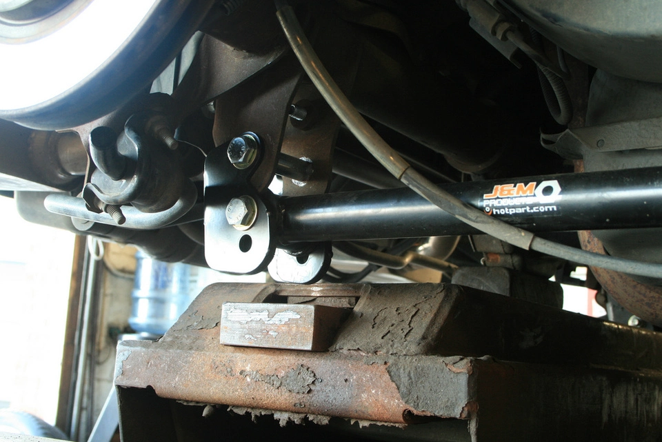

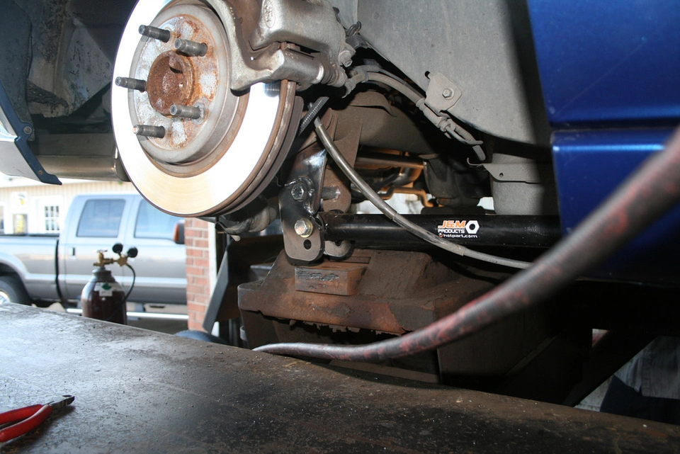

Just installed J&M LCAs and relocation brackets...PICS ADDED
This was my first time ever messing with control arms and what a relatively easy job it was. From start to finish it took just over an hour. I read over bigcat's write ups for both before ordering the parts and when I opened the box, J&M had sent a copy of both the very same write ups:rock: I have driven it about 100 miles on the highway since and it rides slightly different than before and there is absolutely no noise, vibration or harshness. It feels as if it rides smoother (less bumpy) than with the stock control arms.
Only been on six on/off ramps with it and I don't feel as comfortable with the BFG 235s as I did with the Nitto 295s. Over irregular road surfaces it feels it takes them better/smoother now.
