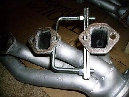

If you can, return the Mac longtubes for some BBK's, or any other brand that has a solid flange. You'll thank me the first time you need to replace the gaskets for any reason, and can't get the primary tubes aligned with the exhaust ports.
I concur, unless you feel like doing what I did for 2 hours.
If you bought mac shorties I would say return them also. But the mac lontubes have enough flex in the long tubes to where you can move them by hand to get the bolts in. Plus mac will make more power with there pro chamber than bbk anything.
