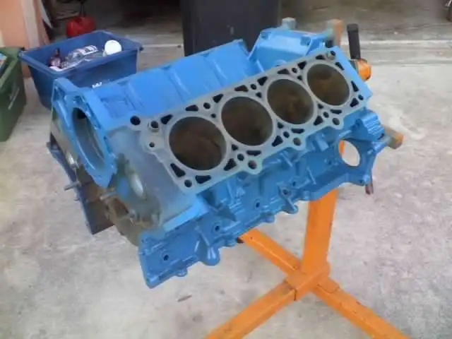

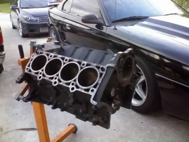

found it locally on craigs list for $100, im not sure how many miles are on it but it still has hone marks in the cylinders, i was going to buy all the bottom end parts for my block and rebuild it, but i found this one and decided to build this block with all my parts and then drop it in, i will be building it with: stock cast crank, canton windage tray, ace forged i beam rods, mark 8 piston, clevlite main & rod bearings, FRPP HV oil pump, and sealed power rings!!!

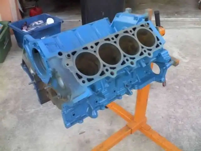

ahhhh...fresh coat of FORD blue.........

she looks good your phone makes the color look light
