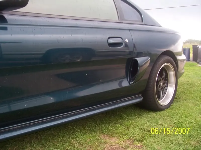

Ask and you shall receive. I was only able to snap one ****y pic. It started raining as soon as I went outside.
This picture reminds me that I need to go get the trash cans from the road.
Dont get a diff. spacer, massage the fender...20 lb. sledge works nice.:D
But yea MM says 1/4" SHOULD be fine...You could have goofy replica wheels (there all made different). 6 thread rule is the one you should go by in the end.
