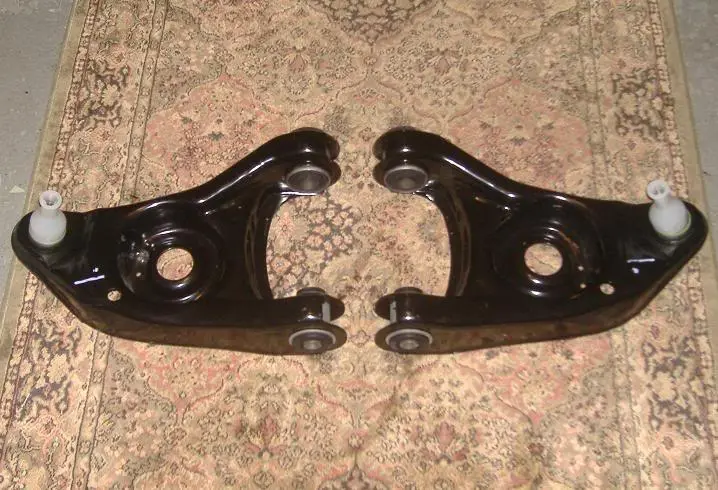

Thanks for the advice. I'll be doing something very similar soon. if it wasn't raining all weekend these would of went in today...
they're 2003 cobra control arms. My ball joints have gone bad, so considering the options and the pain it would be to revamp the old ones, I thought this was a great upgrade. New ball joints and stiffer bushings already pressed and and ready to go.
