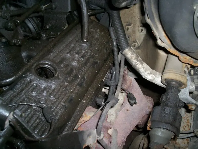

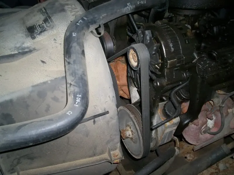

Justin/anyone else...........anyone with a 4.3 in a chevy truck I need 2 pics......one of the alternator and the line that comes out under it...looks like a vacuum but it is just hanging there...............2. pic of the driver's side manifold of what I think is a oil sending unit and a plug...........I appreciate anyone's help on this.............

If you look by the fan belt and under the radiator hose it looks like those two lines go together....a connector missing...it goes to a cannister behind the driver's head light.

Seems to me that the Charcoal cannister is down where the driver's side fender meets the front clip.
The oil sender would be behind the throttle bracket IIRC (the oil sender is between the bracket and firewall).

I believe you and Jutin....I just don't know what that fitting by the manifold is for. If you take a good look at the alternator and valve cover I would guess the oil fill came out and major blow by.....the passenger side vc is clean and there is oil residue all over the driver's side...Oh well....looking for the 4.3 as we speak.........:rlaugh:

Hey, I was unable to catch my dad @ home & get a pic. I did find out what that thing in the side of the driver's side head is. It is a coolant temerature sensor. Yours is broken. Get a new one and that plug will connect right to it.
I'm still lost on the vacuum line thing, lol.
That's what I was told it was a coolant ....thanks Justin...the other is a vacuum line going to the charcoal can.
