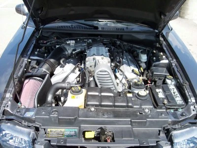

Here is what my setup looks like up top. The K&N FIPK2 CAI gets that Eaton to sound just whine (ie. FINE). I just hooked up the Magnaflow (streetable type) X pipe and catbacks. Together they work very well compared to the restrictive/quite stock setup. It makes me wonder why I waited so long to do it. As for the A/F mixture, go see a top notch Dyno tuner. P.S. DynoJet #'s went up 48 RWHP and 45 RWTQ.
