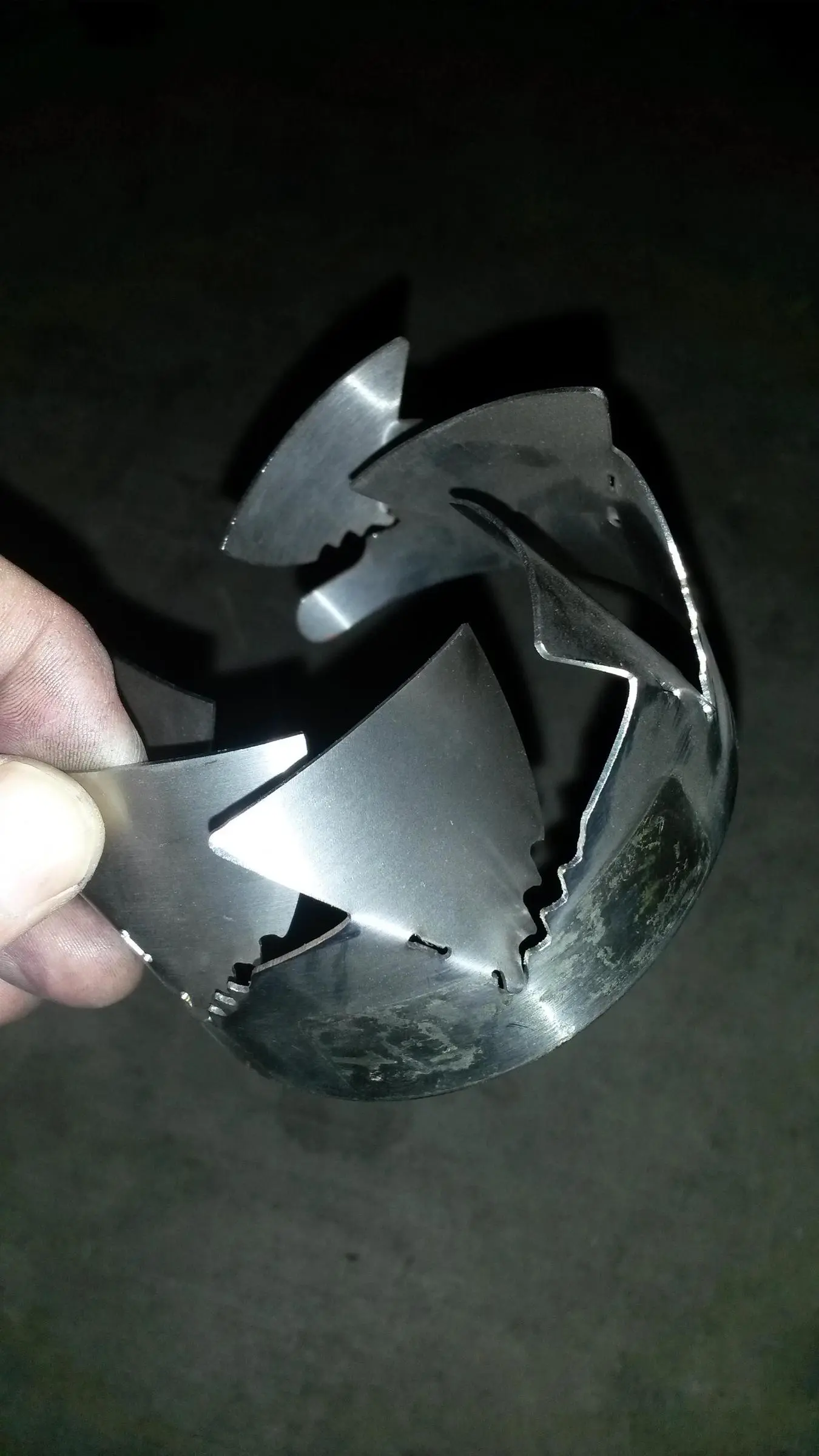

Now since it made the noise without the filter and is definitely in the duct somewheres. I pulled each piece of the duct apart and found this weird piece inside the duct just behind the MAF sensor. I have a feeling this metal piece does not go in the duct,think maybe previous owner put some gimmick item in there. Well so far I took it out since it just sits inside the duct and now it seems quiet.
Here's the part Im talking about:

rabidscoobie said:
Ok messed with it this evening since it was cool enough to make the noise.
After pulling it all apart and recharging the the filter again, it still makes the noise but it sounds a different now,not so much grinding. But it now makes the noise with the filter in or out.
View: https://youtu.be/bt7w0LIfSJQ
Why, that's a SWIRLAROONIE! Makes the air twist around a lot, producing more power. See if you are not lacking power with it outta there!

I have no clue what that damn thing but so far seems to be the noise maker.
Hard to believe I've had this car since 2008 and never saw this thing nor has it made any noise until recent.
Also it seems to idle smoother without it.
Suppose to be cold in the morning so I'll know for sure if the noise is gone without it.
Think I remember many years ago seeing an infomercial of those things, I would never put anything like that in my car

Thanks every one for the help.
That part was driving me nuts.
Guess when I'd take the filter out and the noise stopped that piece would move or something and making me think it was the filter. Once it made the noise without the filter I knew the filter wasnt the issue.
