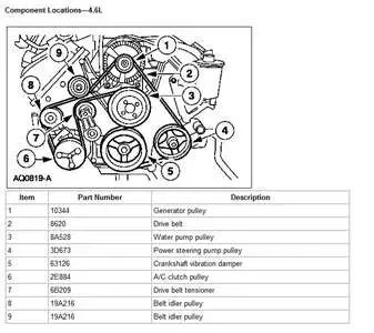

Yeah I've used that before but replaced the idler arm and pulley, both idler pulley's in august. The ac compressor was replaced in may since the compressor was leaking and rebuilt the altenator last month from a bad regulator.
It doesn't seem to be a pulley, the loudest area is the air filter box right at the fender. Putting my hand on the air box and air duct you can actually feel the vibration but not anywhere else.
Bulk of my tools, rolling chests,compressor and specialty tools are at my dad's garage right now so when I feel better and get over there I'll go at it with stethoscope.

No smog pump on the Mach 1.
