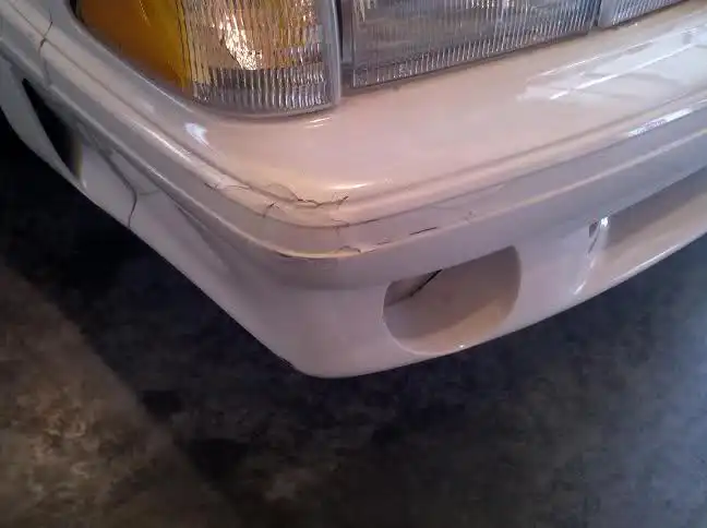

Car was hit in the front so I need to replace the inner fenders as they are a little rusty and crinkled also the core support is kinda rusty so I am probably going to replace that as well.

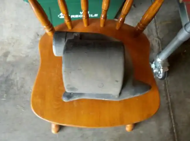

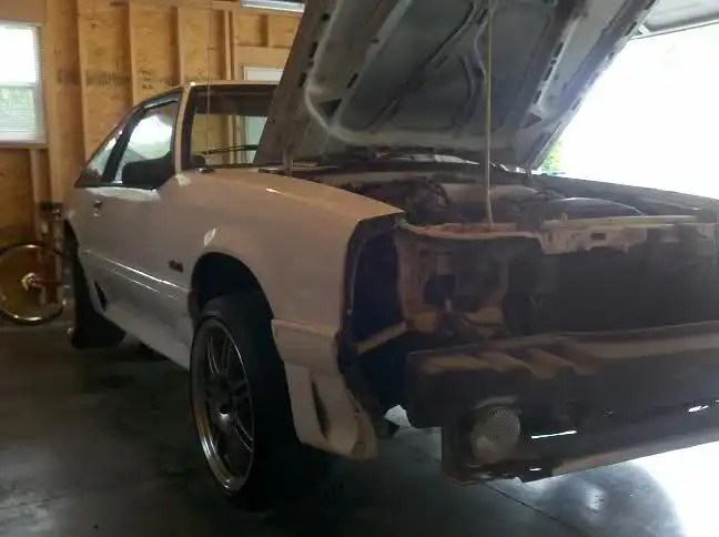

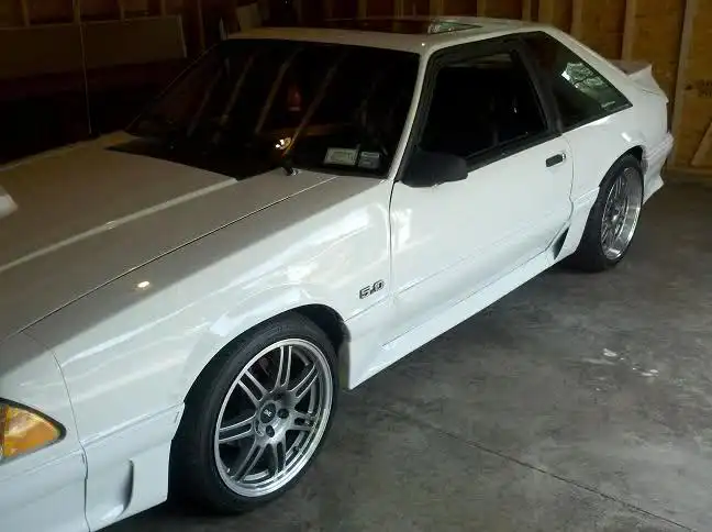

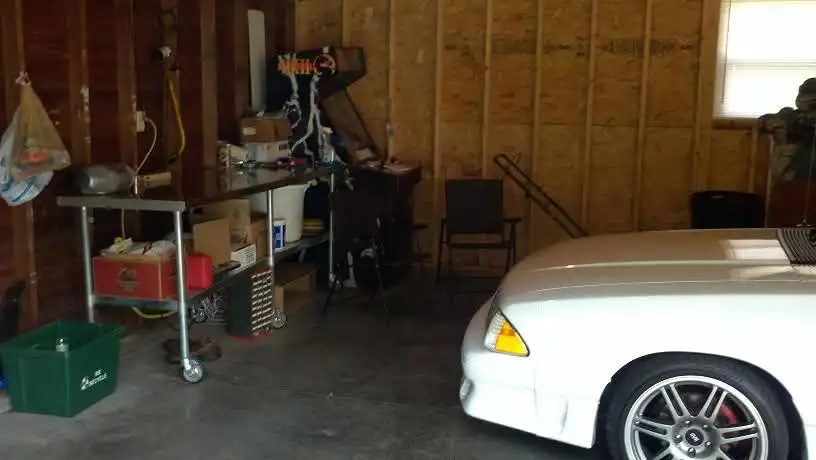

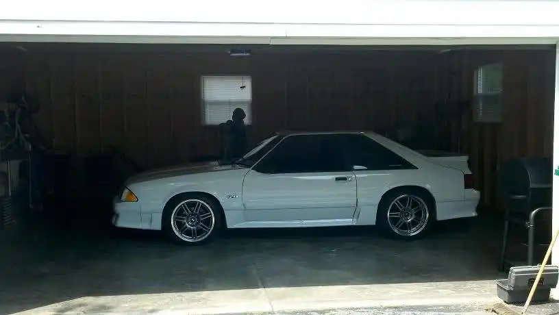

So today I started by cleaning the garage getting everything squared away, got the car up on jack's and started the dis-assembly. I started now because I want to get as much done before winter as possible so if all I have left to do in the winter is minor stuff then that's OK (hate the cold!) Here are a few pictures of my garage and progress so far! damn car still had the air silencer lol.

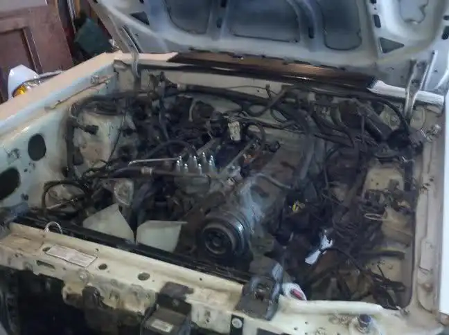

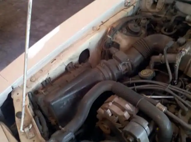

hey guys a little update!, I pulled the top half of the motor off today waiting to go borrow my buddies picker to pull the motor, I'm surprised the engine bay isnt too rusty but there is OIL everywhere, this car was leaking like crazy, everything had a nice coating of oil on it. I drained the coolant and it was brown and nasty. I'm glad i decided to pull the motor out.
I also spent some time fiddling with getting the summit racing seats mounted, I can confirm the stock brackets don't seem like they will work so I will need to have some custom ones made up. here's a picture of the mess of wires and crap in my engine bay. this week I will work on getting the rest of the wiring out and getting the motor prepped to be pulled.
