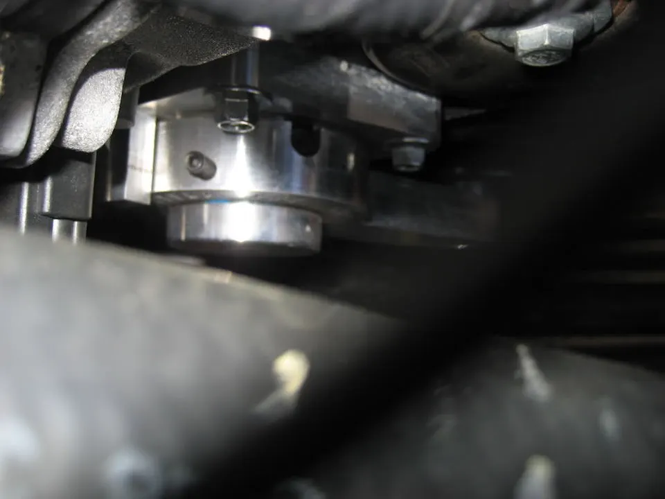

Question for anyone with the thump rrr tensioner....
how much travel do you see with it? When the car isn't running, or its idling, how far is the bolt from the stop point?

this is with a 3.625 8lb pulley, supplied whipple belt and the 100mm ideler pulley
never once noticed any belt slip, belt looks great still, even tho i only have 300 miles on the supercharger

<TABLE id=HB_Mail_Container height="100%" cellSpacing=0 cellPadding=0 width="100%" border=0 UNSELECTABLE="on"><TBODY><TR height="100%" UNSELECTABLE="on" width="100%"><TD id=HB_Focus_Element vAlign=top width="100%" background="" height=250 UNSELECTABLE="off">ok, thanks. Thats a bit more travel than I have now. I'm gonna go ahead and move the idler thats next to the alternator down one more hole.
