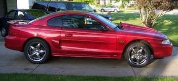

Here is a pic of her car...
What kind of power with a decent tune do you guys think this car will make? I will be bringing it to Pauls HP for the tune.
