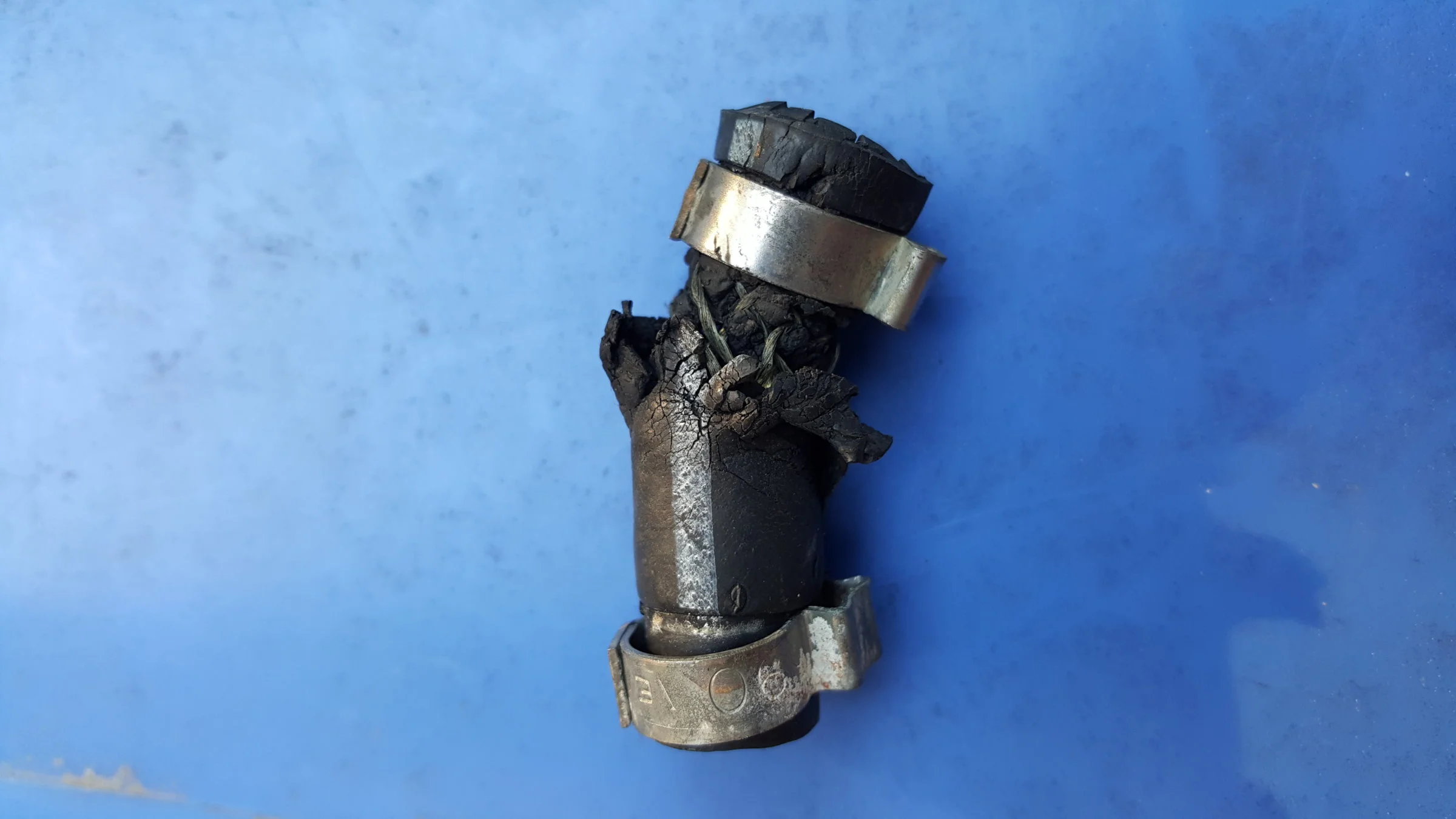

In the tank there's a rubber hose that connects the pump to the sending unit assembly. This hose can rupture, mine did. Common problem with todays fuel additives. Also, check the plastic fuel return line near the passenger front suspension. Make sure it didn't get kinked.
Finally got around to replacing the fuel pump...it was the hose that connects the fuel pump to the fuel rails. It was broken and leaking...pump is probably fine but might as well replace the 28 year old pump while I'm there. Attached is a picture of the hose. Looks a little worse after I twisted it to get it off but it was definitely bad. Thanks to everyone for their help in diagnosing!

That's what mine looked too. Again, check the return lines too at lower front part of engine block. If they get kinked, the pressure side of the system gets subjected to full pump pressure since the bypass from the regulator can't get freely back to the tank.
