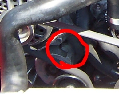

its located on the tensioner towards the bottom on the side that faces the center of the motor, its just a little tabe that sticks out that hits another tab on the movable piece of the tensioner, hope that helps

attachment.php
Ah ha...thanks very much for the pic and info. I will have to look at that thing next. Is it fare to say that if it only happens sometimes, and only sometimes that the valvetrain can be ruled out. I mean if a rocker was loose or something or there was a piston to valve issue it would always be there right? Thanks
it'll be the tensioner.... mine did that, and it sounded as if the motor was about to come apart.... talk about being worried, it did this right after a head gasket swap(i removed the ac the same time as the gasket replacement).
:nice: get it figured out and report back.... all you have to do is crank the car, and watch the thing, you will see it moving and hitting if it IS the culprit.
