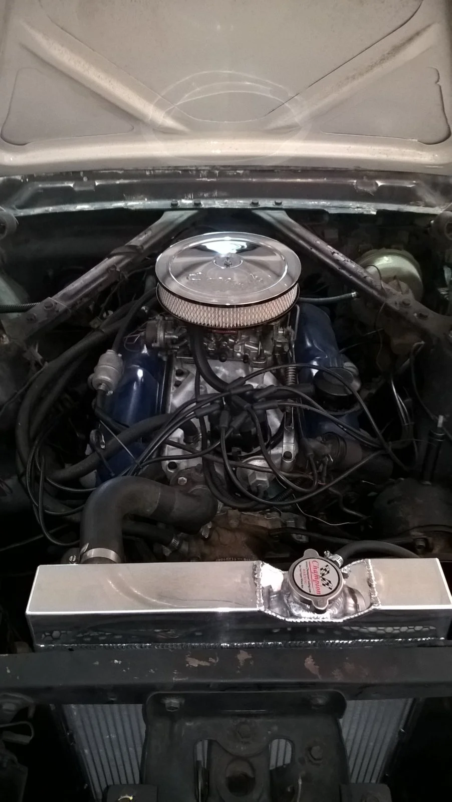

Hello, I just changed the front and rear shocks on my 65 Mustang. The passenger side now makes a knocking sound when I go over rough road. Im pretty sure I tightened everything down properly. If I push up and down on the front hard I can hear it. Pushing and looking at the top everything seems fine. I did drop a bolt down the shock/ spring area. We didn't find It under the car. Ive searched as well as I can for it with my fingers and magnet. Is that it? If so, where the heck did it go, its not like theres a lot of places to hide, can it be caught in the spring? It was a decent size bolt.
Just wondering if any of you have some insight.
Thanks, Kefta
