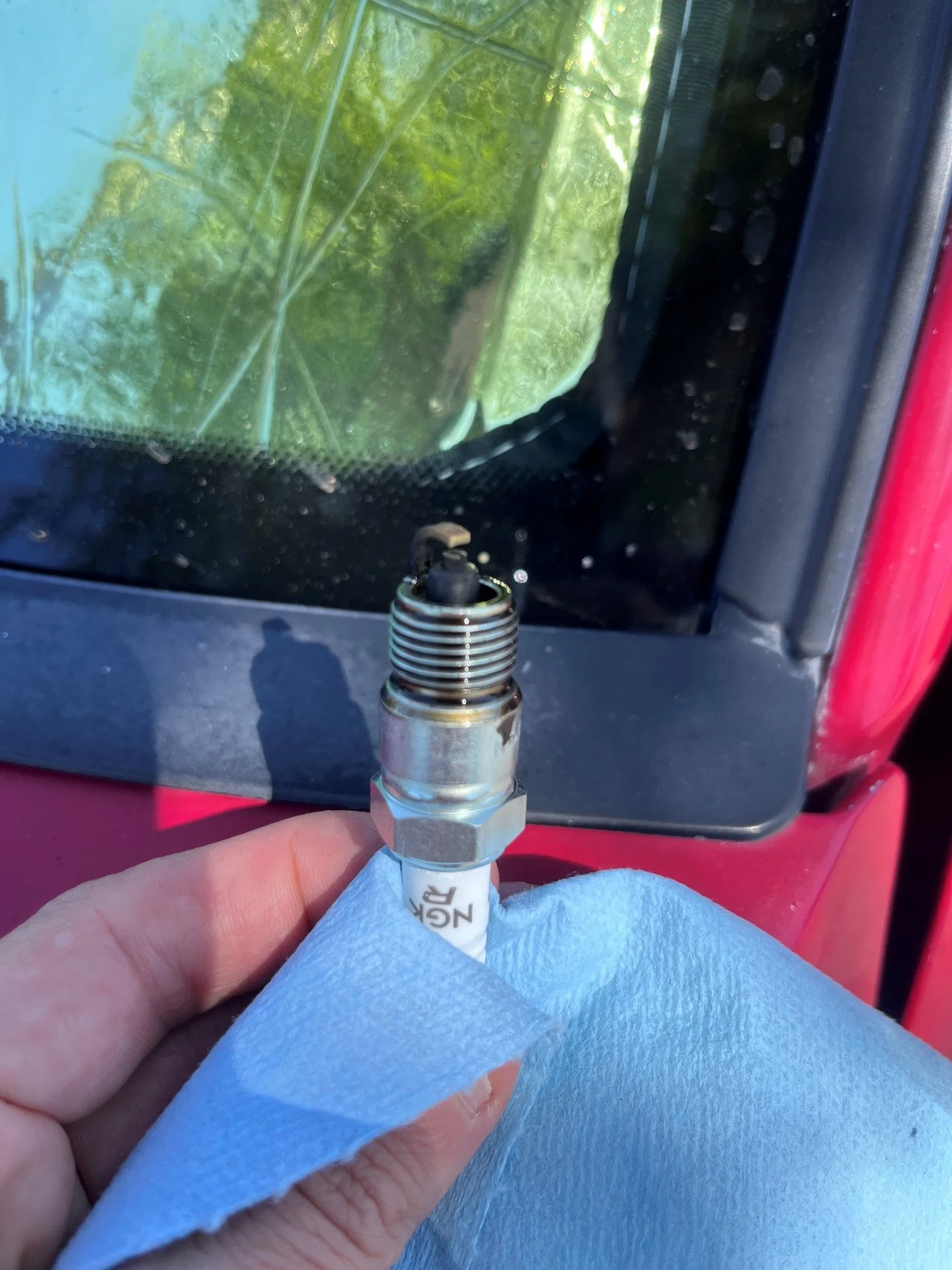

Something interesting to note. I just swapped out my troublesome #7 plug (my weekly ritual) and noticed the ground side electrode is more brown than normal. Typically, with how this cylinder is, the entire plug is just straight black with oil. You can see the oil on the plug threads, but usually the central electrode and ground side electrode are just as black as you could imagine. Now, this is the first time i'm seeing some brown and not oilyness to the plug tip.
Only thing i've changed is the coil.
I also checked my AFR gauge power and ground connections (visually) and see nothing amiss. Maybe with this cylinder issue i'm having, and leaking/burning oil inside the combustion chamber i could have just fouled the sensor?

I don't see anything remarkable on that plug. It looks like it should look if the cylinder is getting some oil.
You still tracking down the source? Is there any in the throttle body or upper plenum?

Thats sort of what worries me. The plug has always looked like hot garbage when i swap them out, so what made it look somewhat normal this time around? I guess its like a good worry, but still just confused to what changed.
I'm starting to think its less the piston rings (my original assumption) and more valve stem seals leaking specifically for this cylinder. All other plugs look normal when i've checked. Its just this one cylinder.
When i removed the upper to get the injectors cleaned, the inside of the manifold was caaaaaked with sludge. I've since replaced the PCV components and i have the added supercharger 'breather' (if you want to call it that) line with the inline filter... which has caught some oil vapors near the airbox. I have another PCV mesh and valve I will swap again once back home.
But to answer your question i have not recently checked the TB or upper plenum. I will be removing all that again to put 24lb injectors in hopefully this fall.
My guess? It's new and it's firing.
Yeah, look and see if you can track down the earliest point in the inlet tract where you see oil.
Does your "breather" have a check valve? If not, your PCV system isn't doing much.

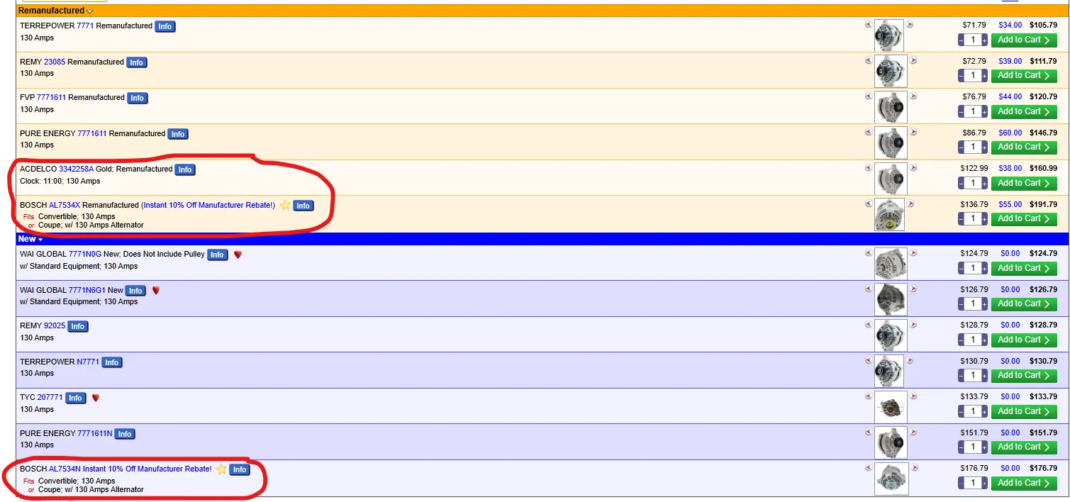

Are any of these alternators any good? I was thinking either the ACDelco or the Bosch reman units:

Well, i ordered the new Bosch alternator from RockAuto. Gonna have AAA tow the car to the house and i'll get to it when i get to it. Looks like the Stang won't be driven for a while now.

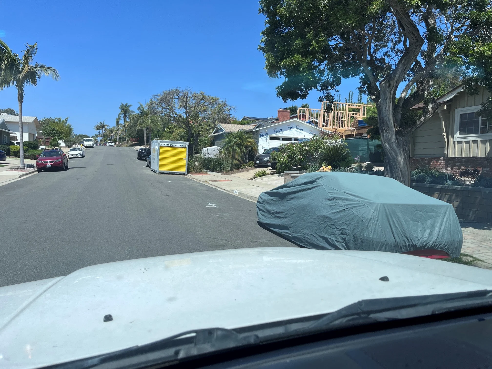

Well, here we go again:
And to the left is the building that recent San Diego shooting was at... right near my work. Actually when i left work the day of i left early and was trying to get on the freeway right there and there were roughly 75+ cop cars all around this area:
And her final resting place until hopefully September (house in background). Disconnected the battery, locked and covered her up. I wanted to park in front of the storage unit (in front of my house) but my neighbors car was parked there. Hopefully my other neighbor doesn't get mad the cars in front of her house now. She's an awesome older lady:
