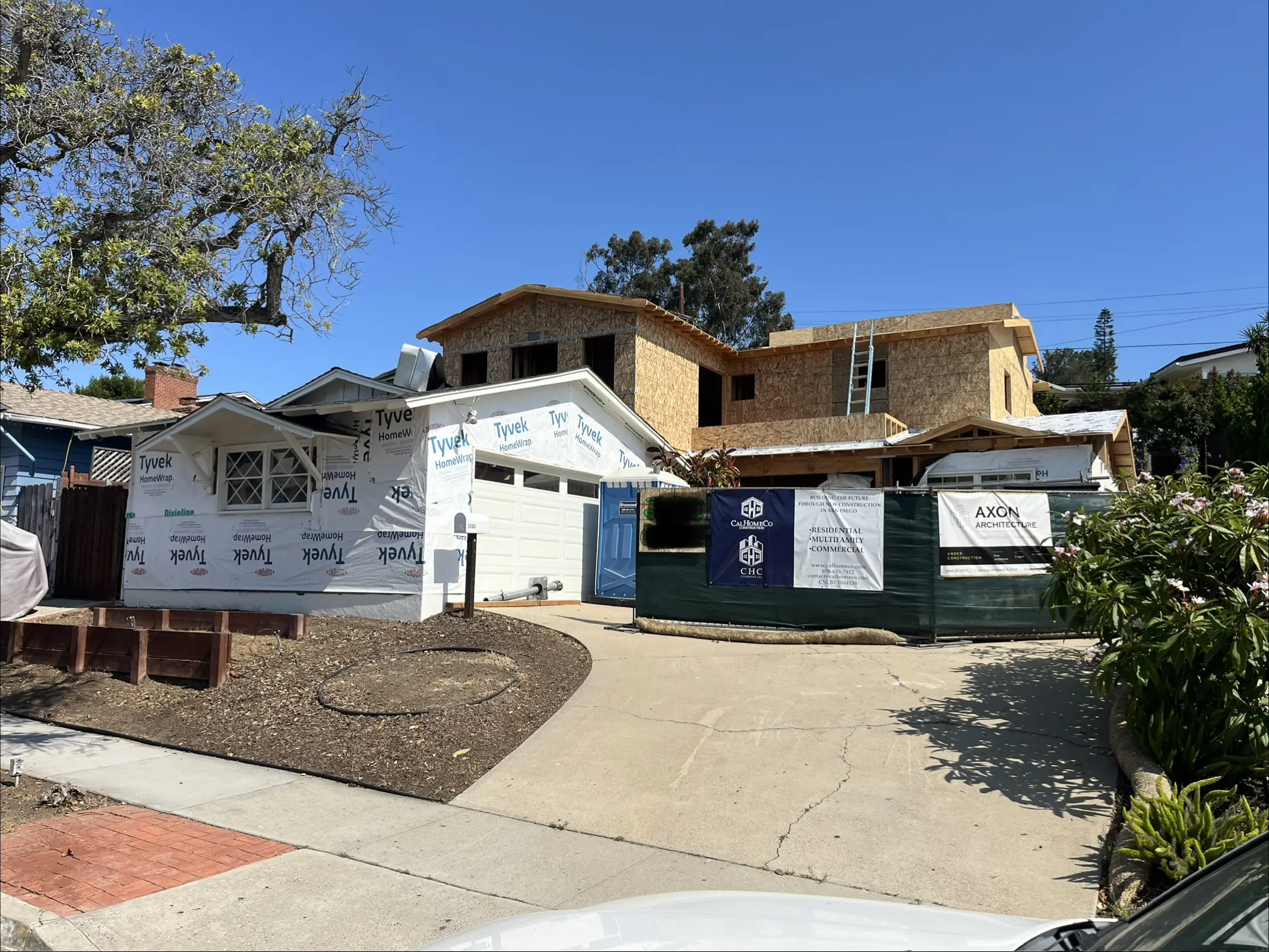

We decided to rip out our landscaping and start over. Next week we have a flooring meeting and the electrical walkthrough.
Another change order for more plumbing/old crusty cast iron piping that was almost completely clogged with rust to be replaced. I believe every pipe in the house will now be replaced.
Reactions: Noobz347, 85GT4V, DadLife0724 and 1 other person
