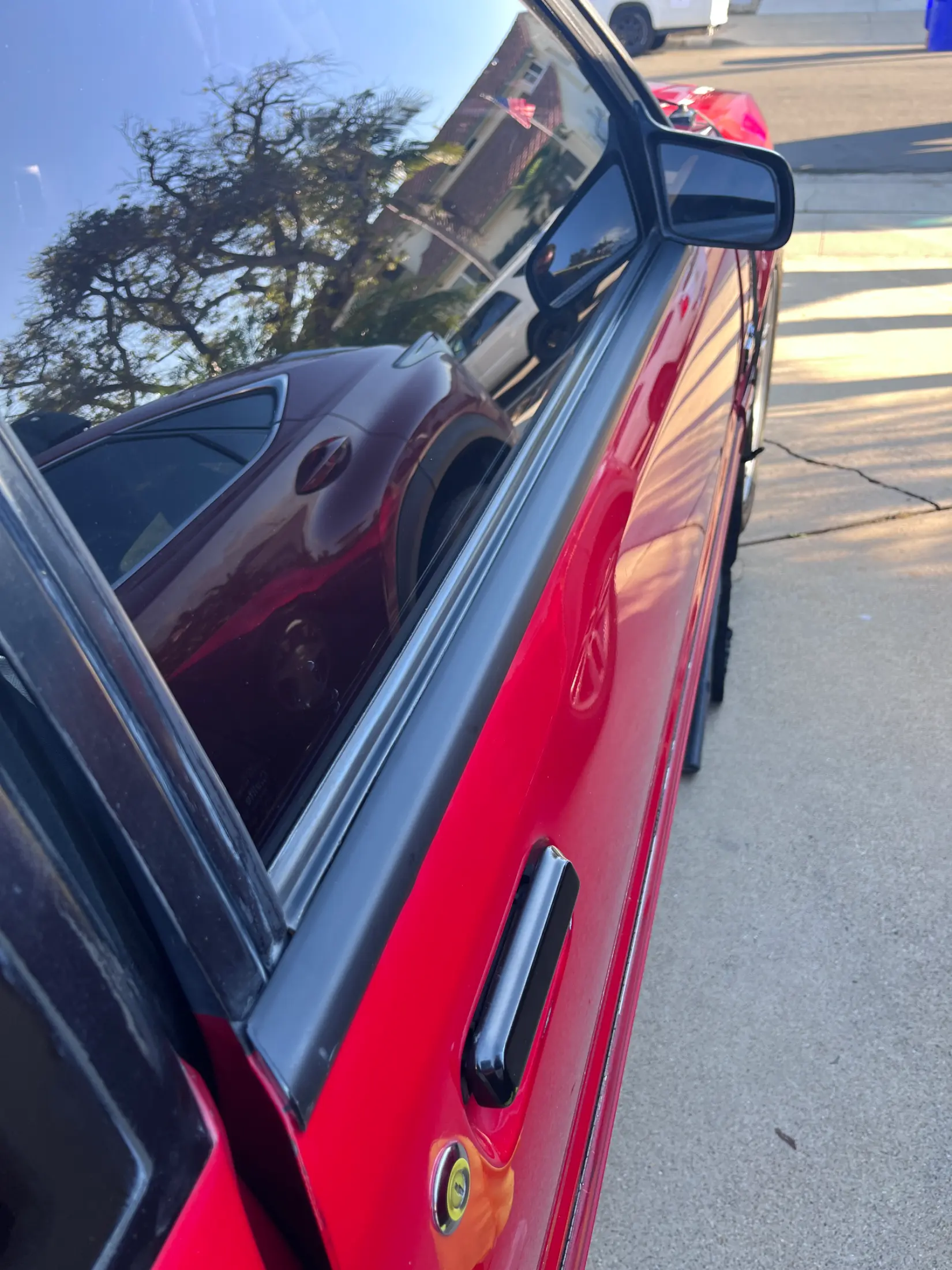

Had like 10 minutes of free time today so I replaced my outer belt molding::
Small things make such a difference. I need to buy some rivets so I can install the new outer window weather stripping as well. Anyone know the correct size rivets?

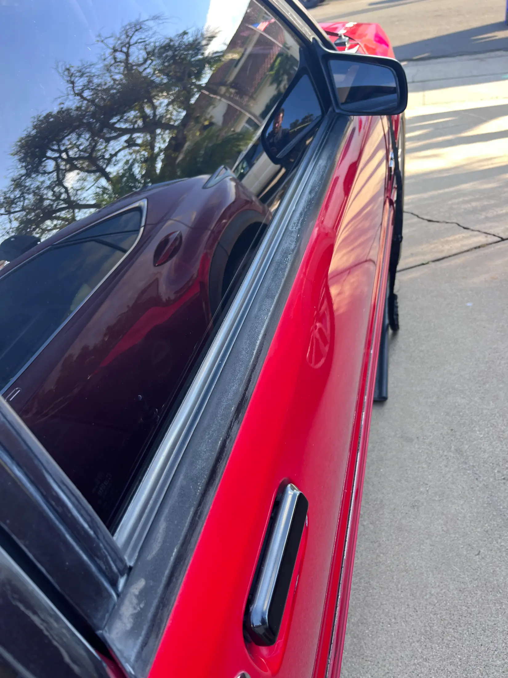

Got the passenger side outside weather stripping piece on. Removing the rivets was a pain in the ass I guess I didn’t have a sharp enough drill bit cause they weren’t doing anything. I ended up using wire cutters and just carefully working my way around each one till it broke off. The 1/8” x 1/4” rivets worked perfectly.
Got the drivers side outer weather stripping on. This side went much easier now knowing how to do it.

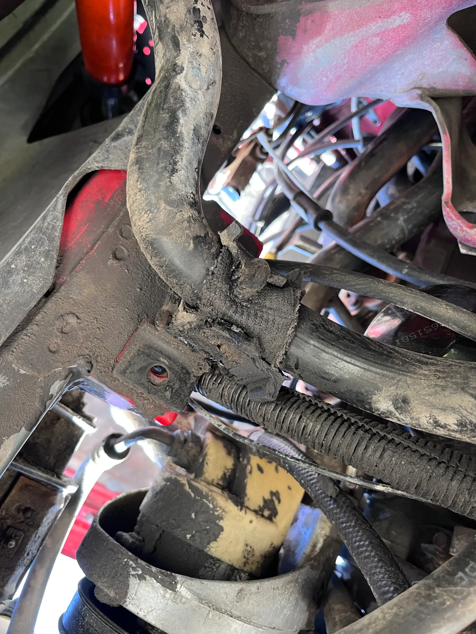

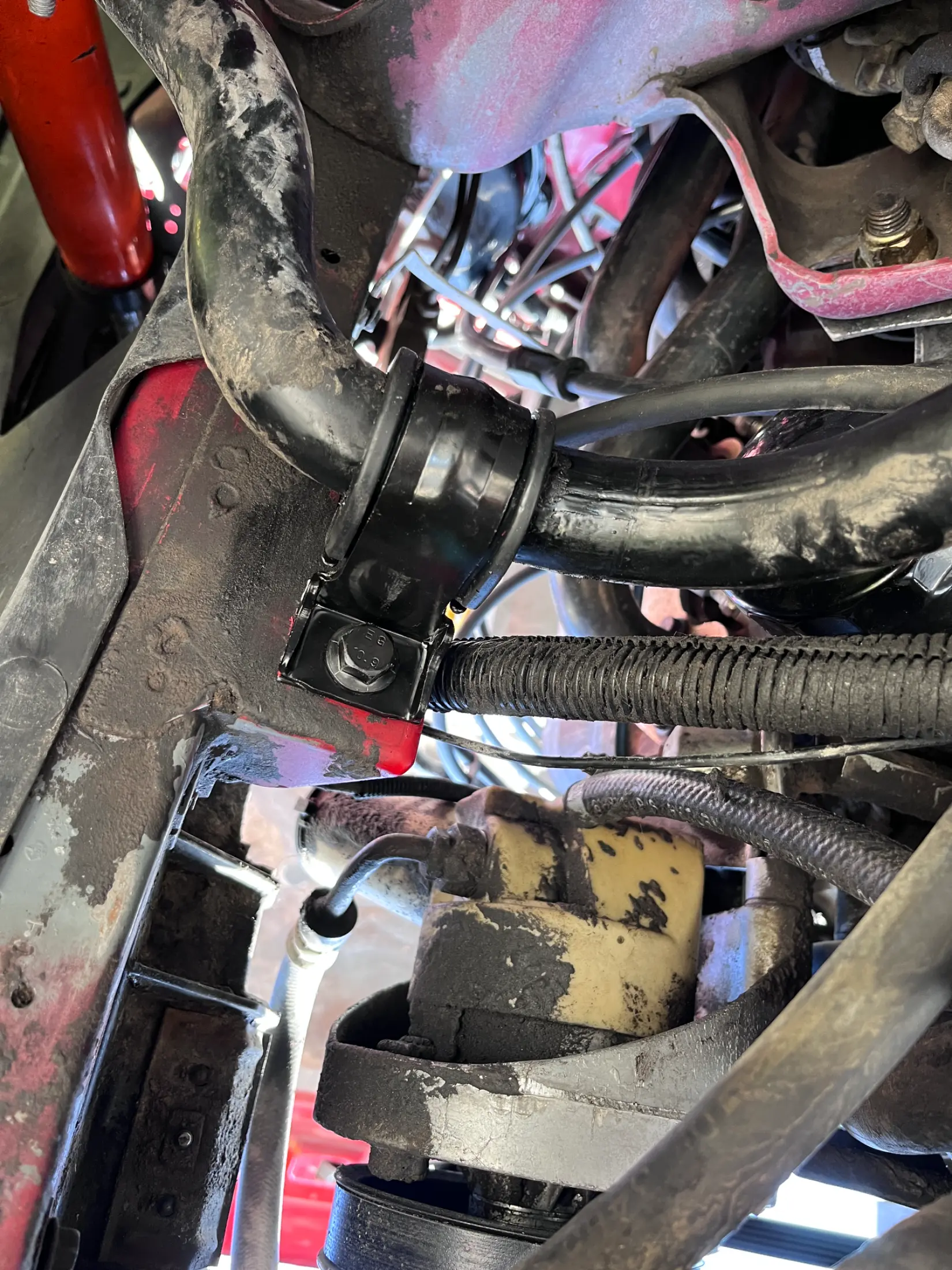

Then I was able to tackle the drivers side sway bar bushing/bushing mount kit. What a royal pain in the ass. Was super hard to get the old mounting bolts off. And when holding the bolts on the bottom side while unscrewing the nuts from the top side I got some sparks on the nut which surprised me. So I disconnected the battery. I used a long extension and it may have been touching a plug wire or something, would that cause a spark on the nut or do I have a short somewhere?
Anyways, here’s some before/afters:
The passenger side needs to be replaced but the bushing looks 1000% better than this side. A job for another day!
You may want to check the starter wire that runs across the front near the sway bar. Spark plug wire wouldn’t give you sparks, but that power wire to the starter may if it’s got some cuts or breaks in the insulation.

In the second picture, is that the thicker black wire right above the bushing mount (above to the right in the picture)? Or just crawl under and follow the wire from the starter? Wouldn’t driving it around I would notice something wrong?
It only did it on the top nut when using a metal socket/extension. I was fiddling around moving wires with my hands and it never sparked.
Not that it’s good or anything but I think my 8” extension/ratchet was touching the metal nut and must’ve been touching some wire at the same time. I’ll look for any frayed wires in the area.
Yeah, I would look back at where you were when it happened, and try to see what was making contact.
Hard to tell (for me on my phone anyway) what’s what in those pics.
