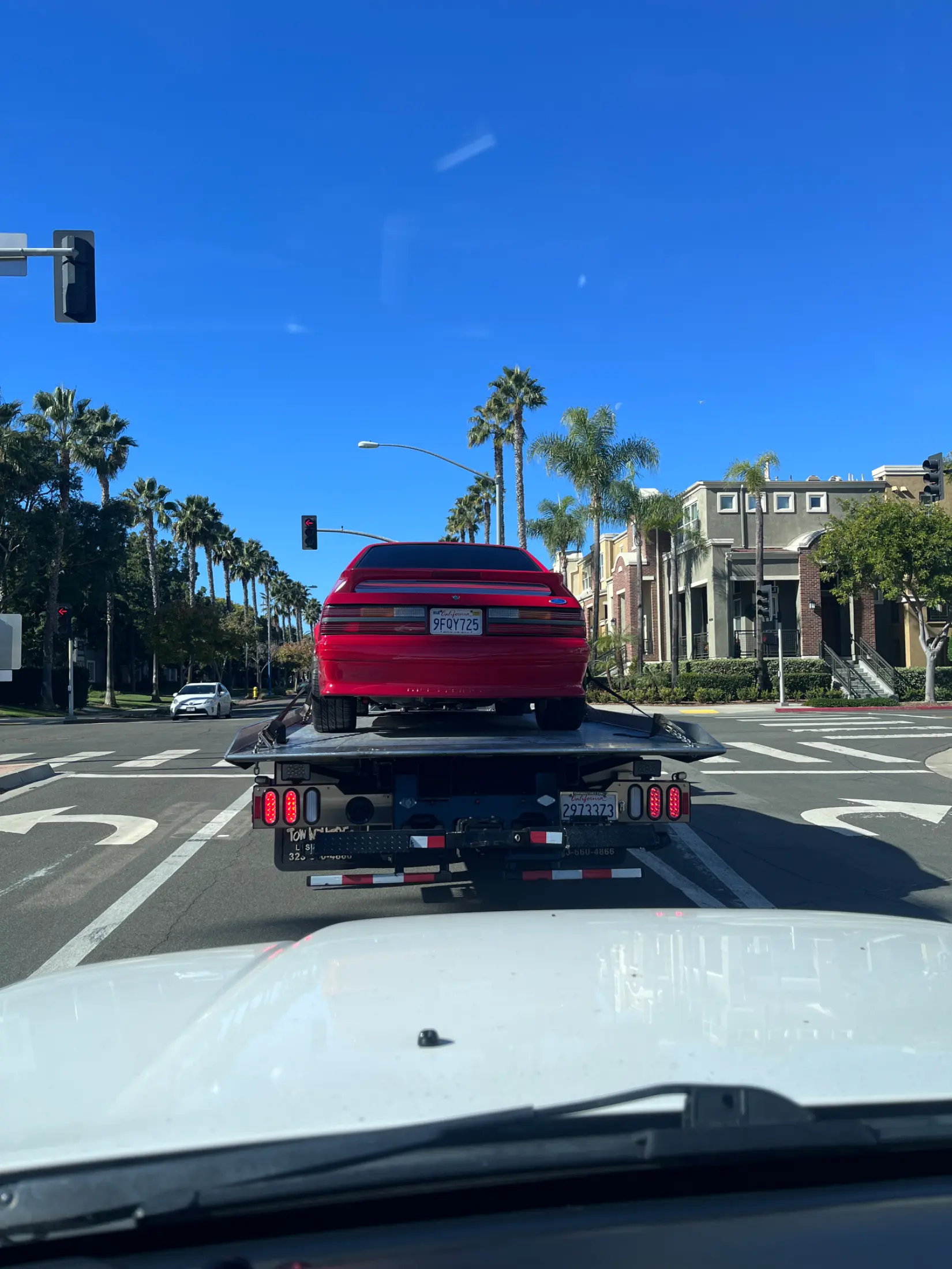

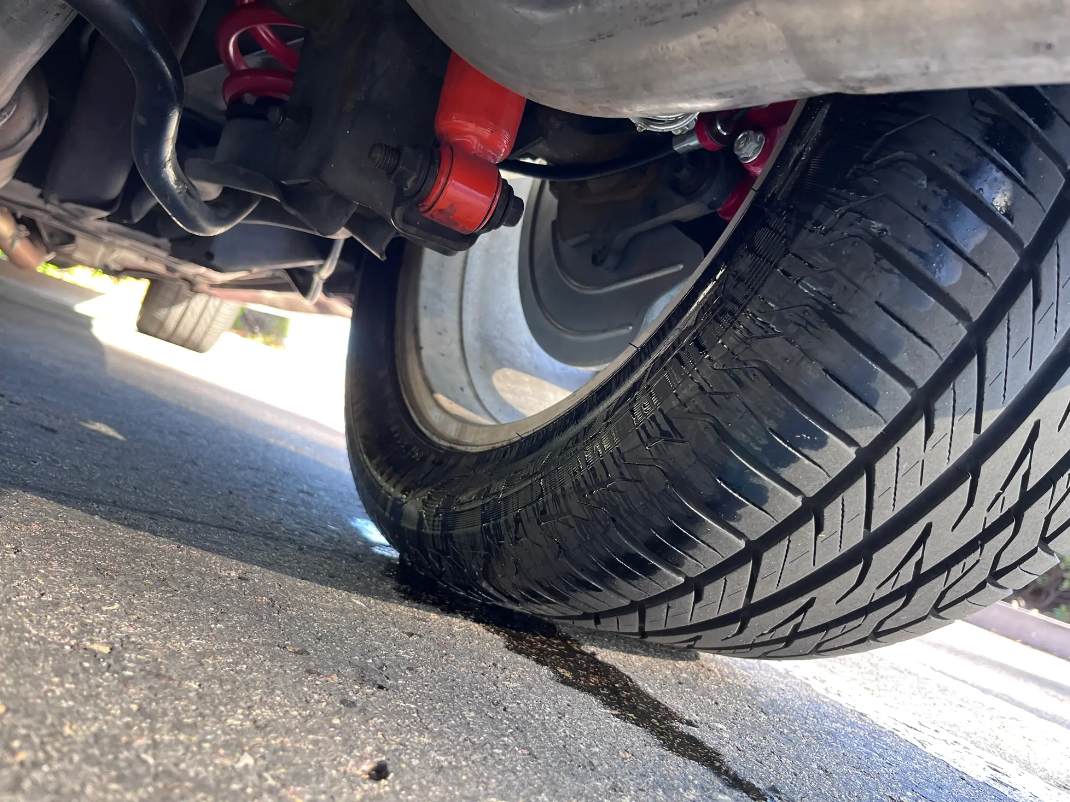

Found my issue must have happened on the way to work cause this definitely wasn’t like this sitting in my driveway.
Massive brake fluid leak coming from the rear passenger side. Glad I didn’t drive this home… getting towed now.
Wash that wheel and any painted area really well ASAP, brake fluid will eat paint and ruin it!
It’ll have to sit overnight as is. Tow truck couldn’t get there until too late so I had to cancel and will have it towed tomorrow. But I will bring some cleaning supplies to clean it when I get to work.

Well they called me while I was out on vacation with the fam (we were in the middle of doing something) so I didn’t ask too many questions but the brake fluid leak had something to do with the caliper. Assuming the connection of the line to the caliper. Hopefully will get the car back tomorrow .

Got the car back, brakes feel great.

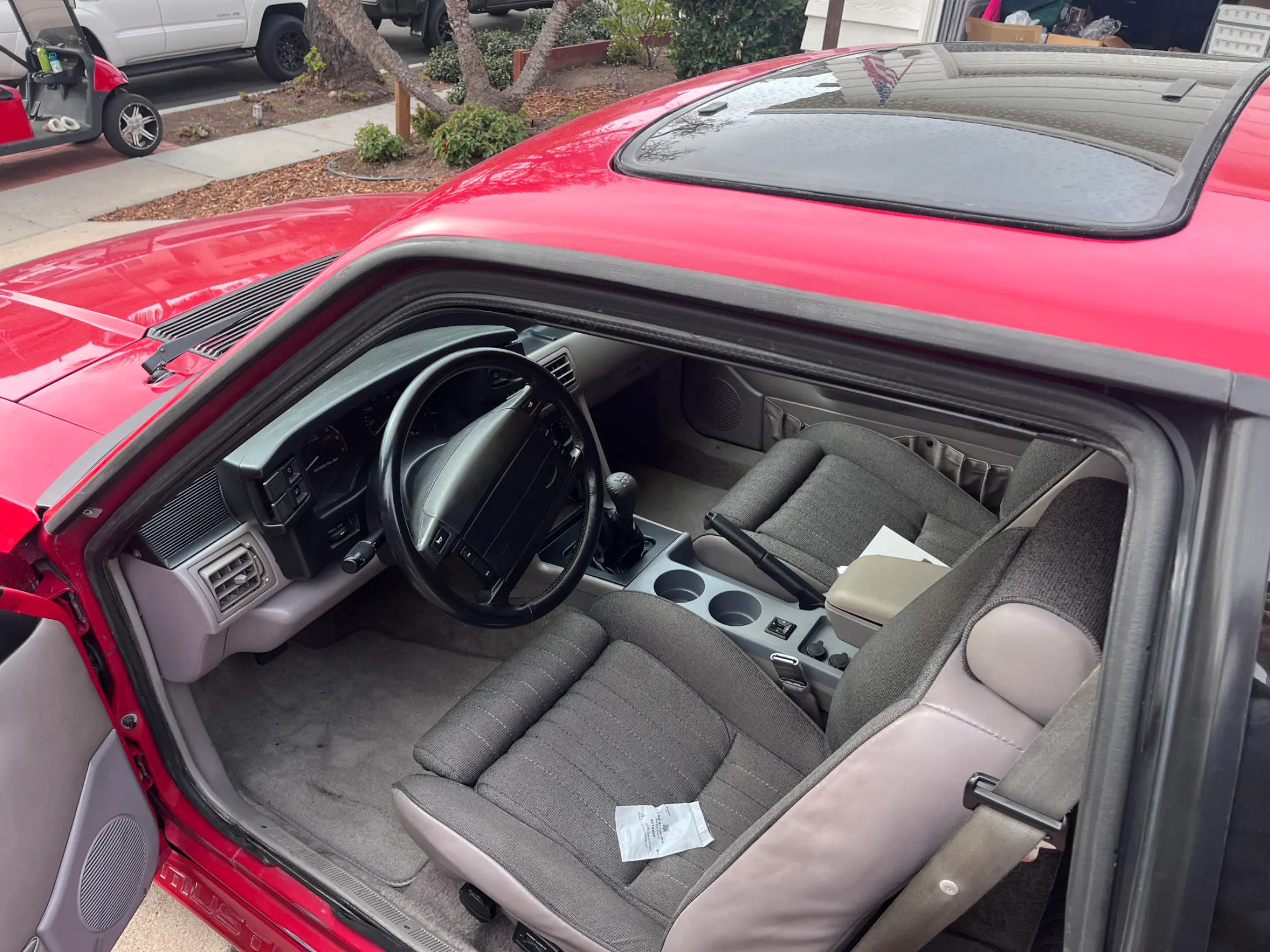

Got home and started replacing my outer upper door trim, and my run channel trim… my window channel weatherstripping just started cracking off in my hand (as seems normal for these cars), so I added the window channel weatherstripping to the to-do list. Got the passenger window channel in as far as the long piece that goes way down inside the door by the mirror. Any tips/tricks to get that piece in? I replaced these parts on my old fox but that was like 15 years ago so I’ve forgotten the way I did it. Once I get that on I can put the new door channel trim on… THEN do it all over again on the drivers side.

One of their older videos but these are “classic” cars now:
View: https://youtu.be/85etSY-NBJ0?feature=shared
About the 8:30 mark here:
View: https://youtu.be/3lSxMCeTnK0?feature=shared
CJ Pony’s video:
View: https://youtu.be/1FOtPsmZJZo?feature=shared
Reactions: General karthief and gkomo

Thank you! I did watch the LMR video but they don’t address the part that goes down inside the door, kinda just say “get it in the channel” and walah they are done.

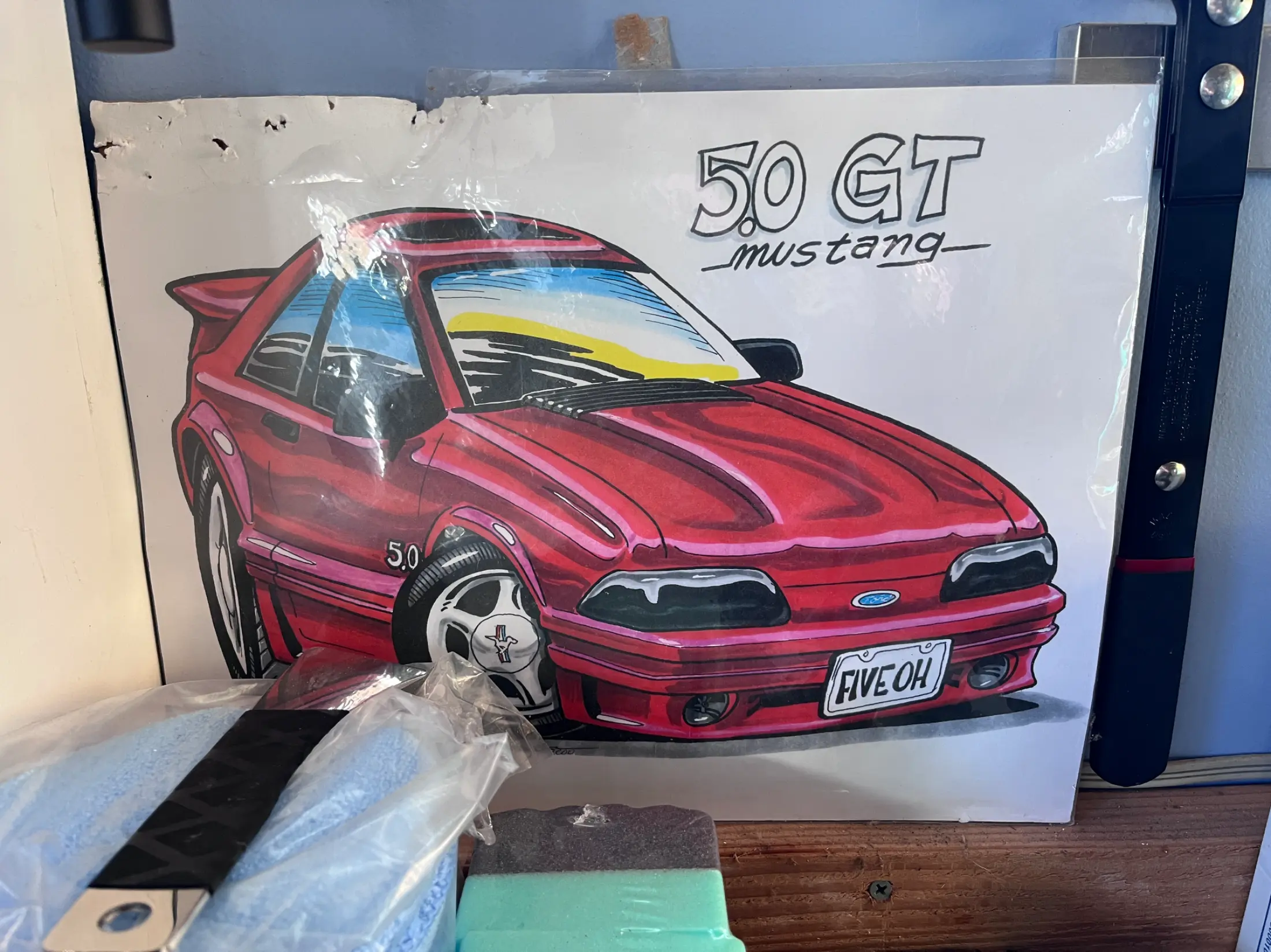

Off topic but found this old drawing an old friend had made when I had my last fox. I think I’ll clean it up and frame it for the garage:

Your buddy had some talent. Back in the day when headlight tints were the .

Got the passenger side run channel trim, weatherstripping installed. Pain in the butt, don’t think I did it 100% correct as I just ended up cutting most of the weatherstripping that goes down in the front of the door off (maybe like half). Window goes up and down though so that’s good. Cleaned up the door while I had everything apart.
