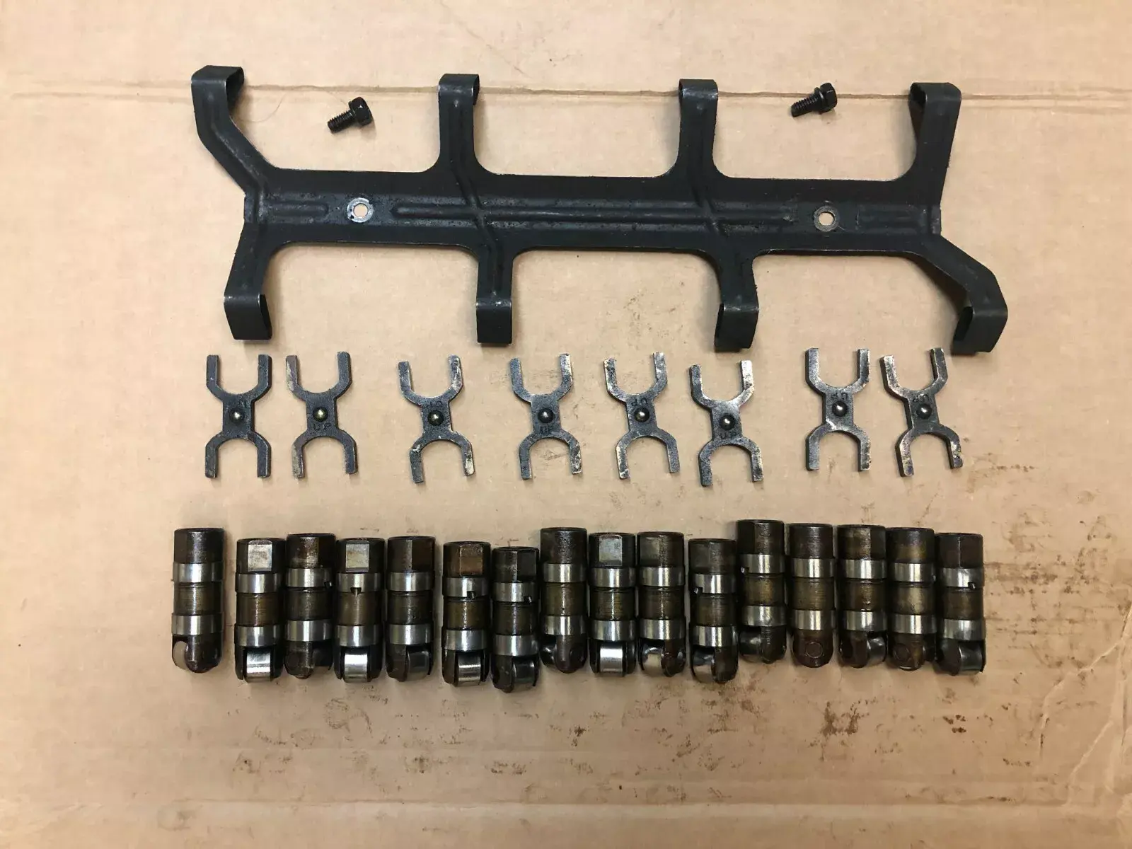

For anyone: What roller rockers and lifters should I buy with the TW heads? Just TF 1.6’s and TF or FRPP lifters? I want to say I had 1.7 rockers on my 331.
If your stock lifters are good, I'd reuse them. Not sure I trust the new Ford stuff. I've seen a lot of bad reviews. Are they now made in China?
Stock lifters from E7 heads won't work with TFS heads, not the same mount. There are tons of good quality options out there, just make sure you get the proper ratio for your cam and valve springs. 1.6 vs 1.7 matter most when it comes to springs and PTV clearance... Now that you've chosen your heads, choose the cam and springs and rockers next.
The heads come with “upgraded springs” already on them if that’s what you’re referencing. From my quick internet research it sounds like 1.6 rocker arms are a safe bet. I was planning on keeping the cam stock. I never had my old fox tuned but it had bucking issues down on the rpm range with the TFS stage 1 cam. That one basically had the TFS ‘stage 1’ top end kit on a 331 with new internal (stock crank though). As time goes on and I buy more parts maybe I’ll just look at ‘suggested parts’ based on the heads. So I think for the rocker arms I need 3/8” stud mount 1.6 rockers. I’ll probably just go with TFS lifters as well unless those aren’t any good?

I wasn't so much referencing the springs other than to say if you're going to change the cam you need to know the spring rate specs that are required instead of assuming the "upgraded" springs are correct... historically TFS springs are not that great and most have to actually upgrade them to the PAC springs.
As for the rockers I was referencing the stock E7 heads use pedestal mount rockers and you'll need stud mount for the TFS heads so they don't interchange. I'd say use the 1.6 ratio and go with the TFS ones or maybe Scorpions. The stock cam will work fine and keep a good drivability too.
Correct. I'm talking lifters not rockers.

Curious what lifters others use. I looked up the trick flow lifters and Ford ones. Neither have great reviews. I'm planning on using some original low mileage ones on my current build.
I saw some melling ones but can't find any reviews on them.

When I did my engine, the ford HI PO lifters got bad reviews, the stock ones had better reviews....
Reactions: Mac131
If you are concerned with quality then just pony up and get some Morel's or Johnson's. They are not cheap but they are high quality and you get what you pay for. I will say that I have the Ford Performance M-6500-R302H's in my 331 and have zero issues.
Why are ‘link bar lifters’ so much more expensive than just lifters? They are like triple the price.
The only time I've heard them being needed is when using a roller cam build in a block that was setup for flat/solid lifter (mainly in 351 non-roller blocks)... But I'm not an expert on it.
There are versions for roller blocks and versions to retrofit non-roller blocks. The roller block version doesn't make a lotta sense unless there's some benefit to it. I'm not sure what that benefit would be over the dog bones on a hydraulic lifter, roller block. :shrug:
I totally get it for the solid lifters tho.
Edit:
maybe it's just a case where a guy has a bare block without all the "stuff" and just says, "screw it... bars". :shrug:
Non-roller blocks have no place/boss/retainer for the dogbones.
Reactions: Mac131 and gkomo
I can see where they might not be necessary in a roller 5.0 with the metal dog bones, but they are somewhat of an insurance policy when building a spicy LS engine since they use plastic lifter trays. An engine will quickly self-destruct if one happens to go sideways.
Unfortunately valetrain components are often not understood and stuff is put together because it appears to work for someone else.
