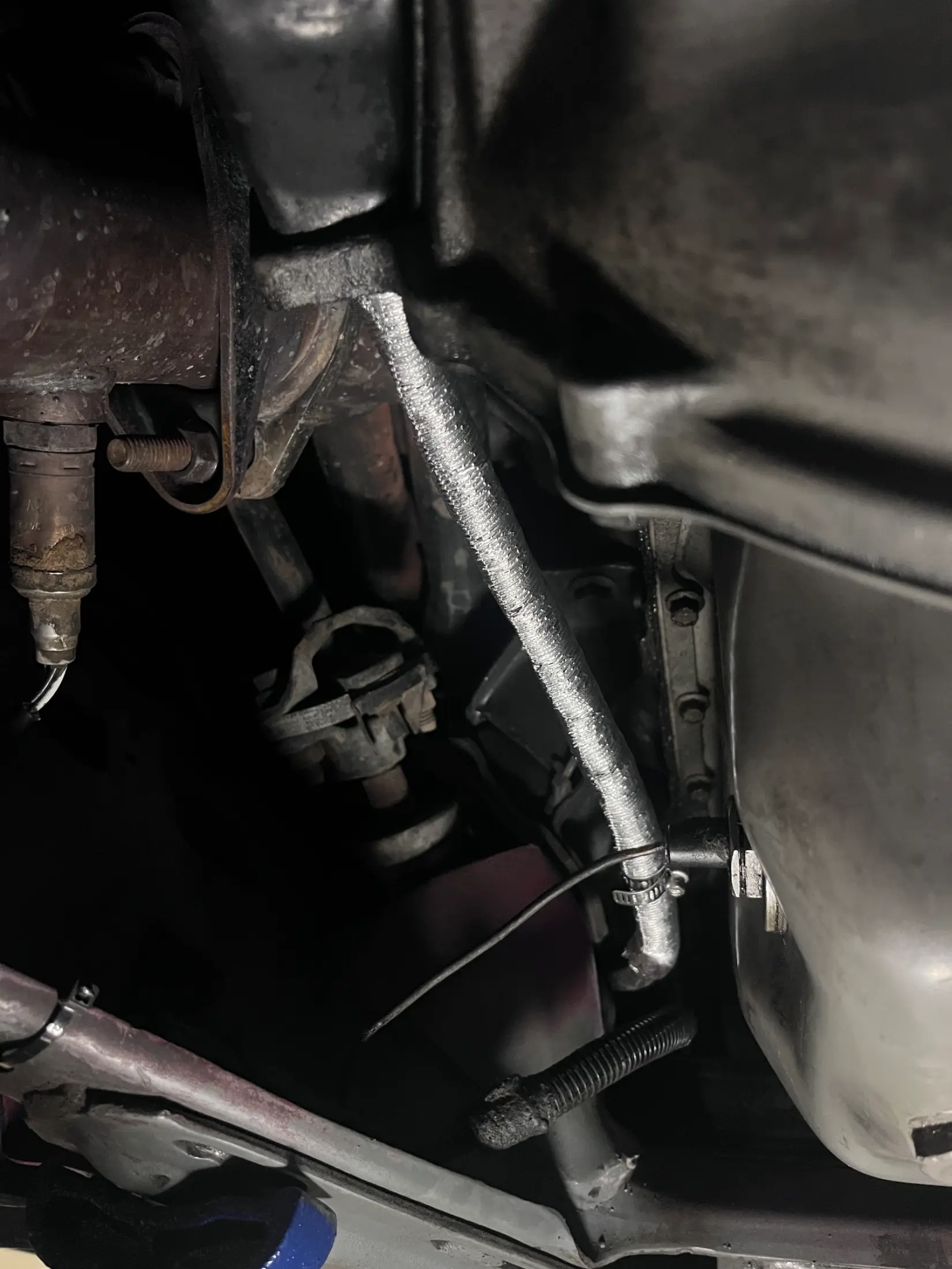

Quick easy job tonight. Added the MM clutch cable heat shield:
Reactions: Scrapla347
What length was it? I need that for my cable cause that thing gets hot AF and hard to move.
12" per MM's website:
I may buy another to put near the header from the topside where the cable routes right down by the drivers side header. When i bought it thats actually what i thought it was for but then i read the directions and it goes down by the bellhousing. Once down there i can see why, the cable is right next to the collector.

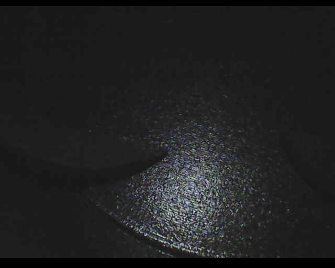

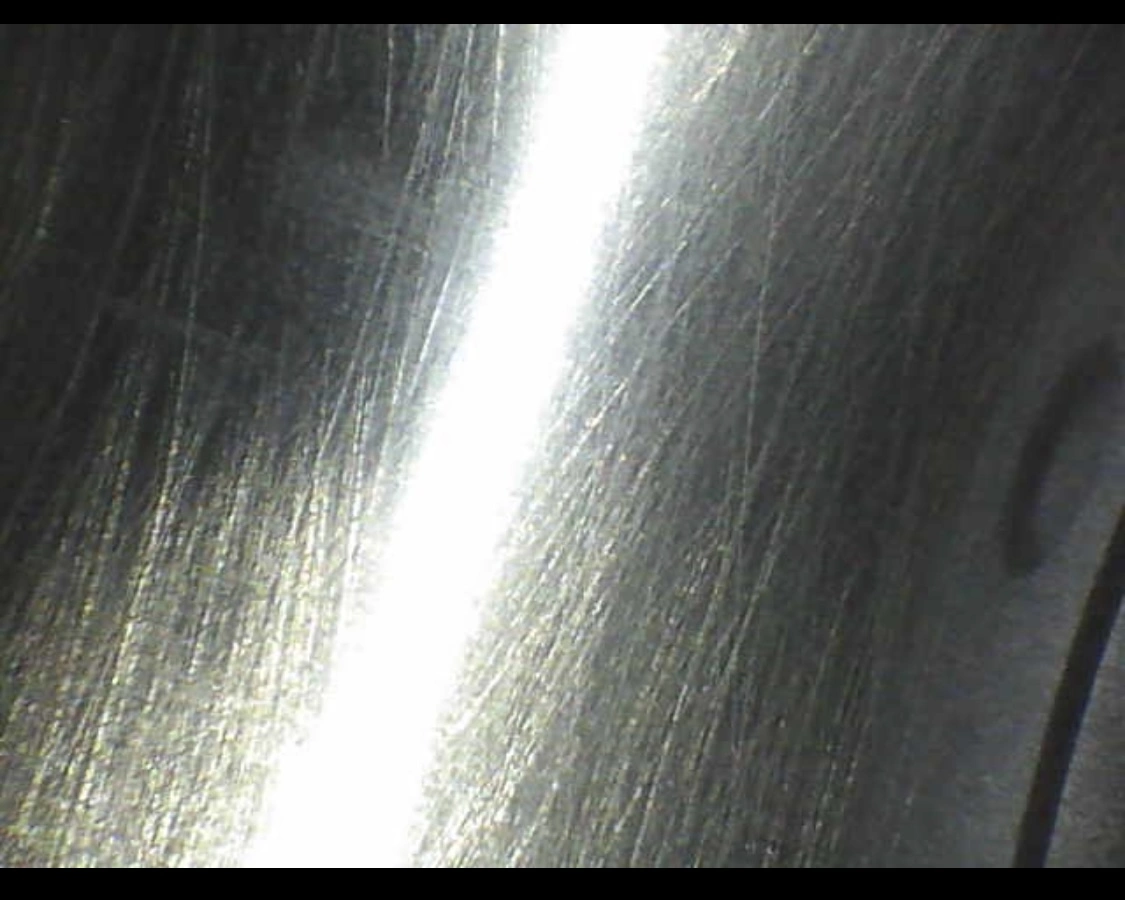

Started changing my spark plugs. Pulled out the first one and wanted to test my cheap borescope. This was the drivers side front spark plugs (easiest to get to):
Spark plug shows a little bit of oil on the threads:
And top of the piston:
Maybe this piston just happened to be at the top of the stroke because I couldn’t angle the camera to get a full good view. Definitely looks crusty.
Edit: second cylinder inwards with a side view camera angle showing what I’m assuming is the bottom of a valve and the top of the piston. Also crusty.
Edit #2: third cylinder inward:

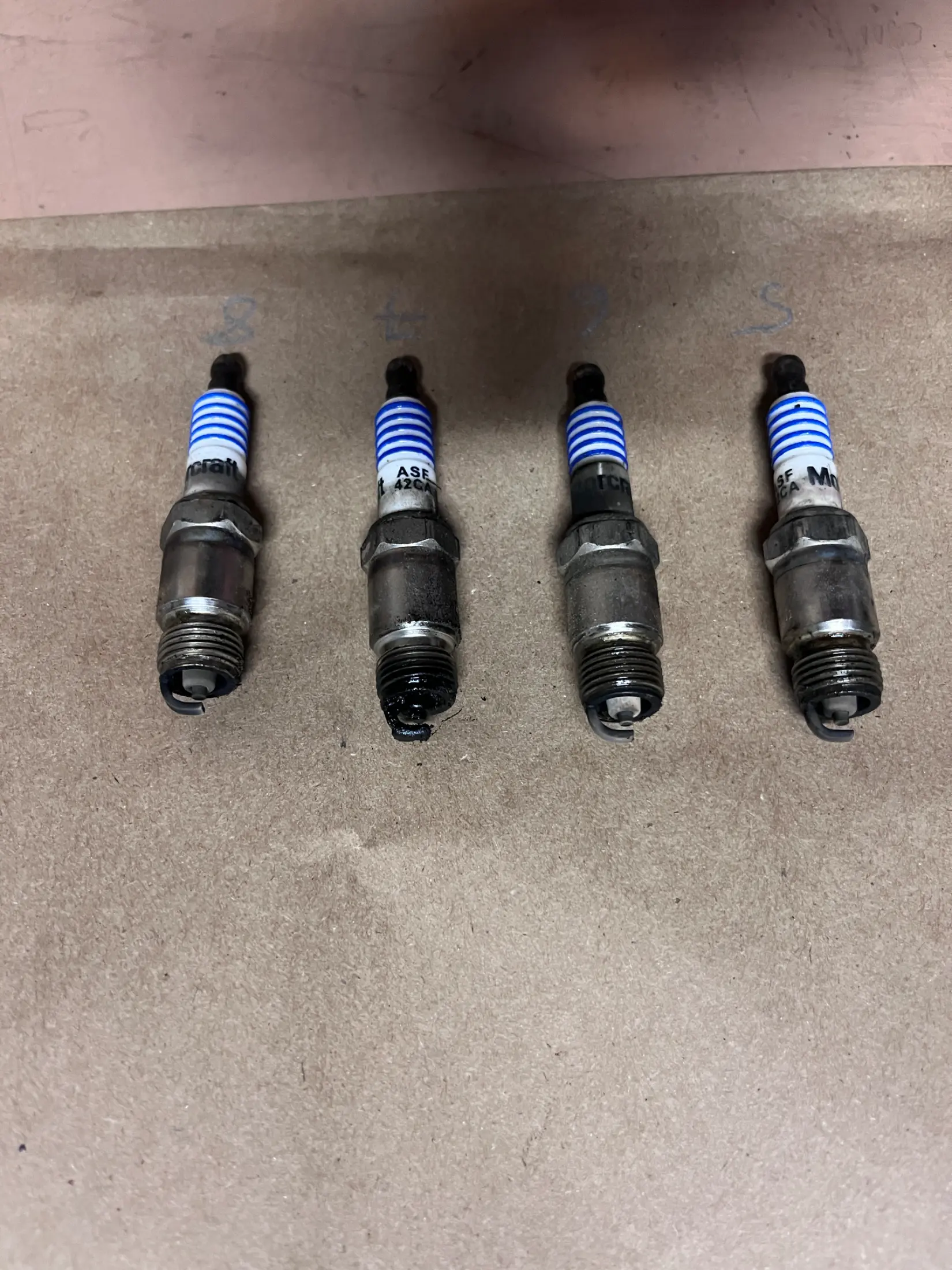

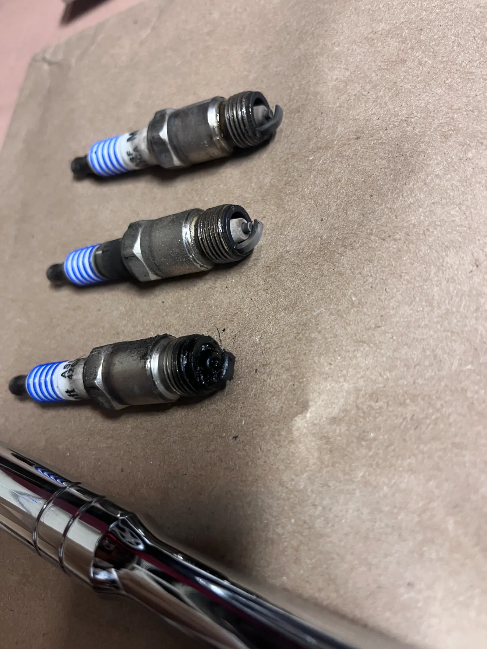

The spark plug for this cylinder looks like complete :poo:

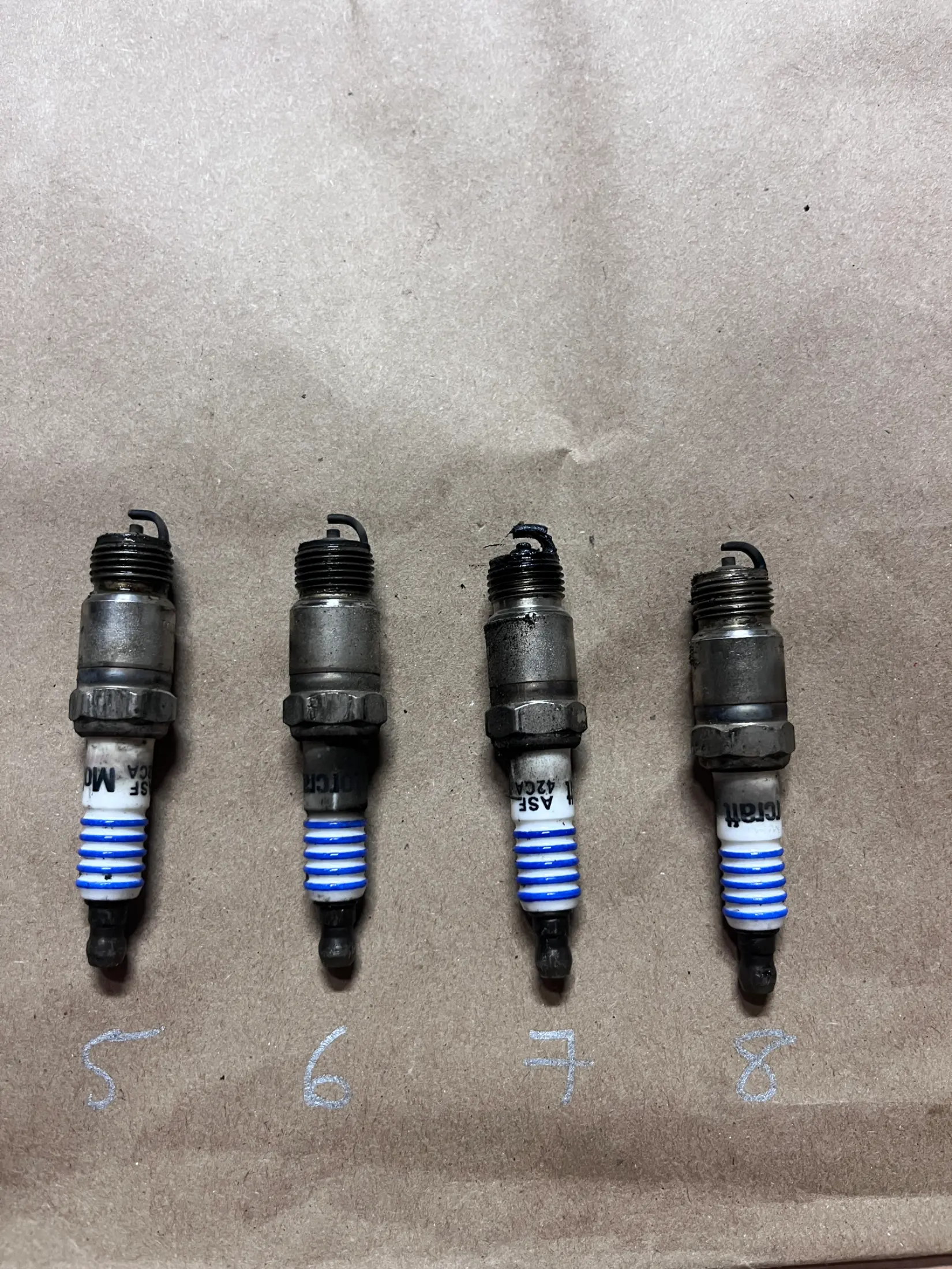

The new Motorcraft plugs i replaced (so far drivers side only) i gapped to .050. I'm now reading they should be more towards .054. Should i take them out and regap them?
Also getting nervous going down the rabbit hole of oil on spark plugs and hope a rebuild isn't in order. I had planned on it, just not so soon. It could also be as simple as replacing the PCV valve/screen which is on my list of to-do's.

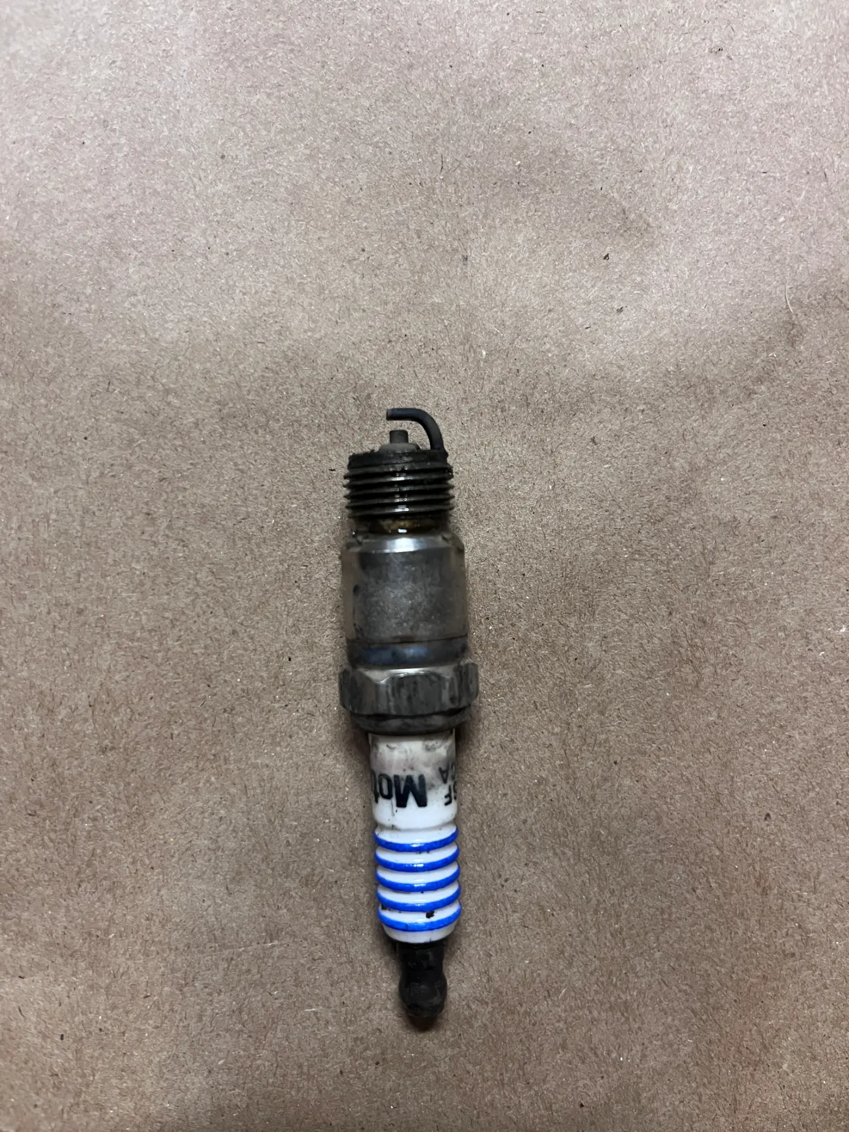

For all, what are your thoughts on that nasty #7 plug pictured above?
