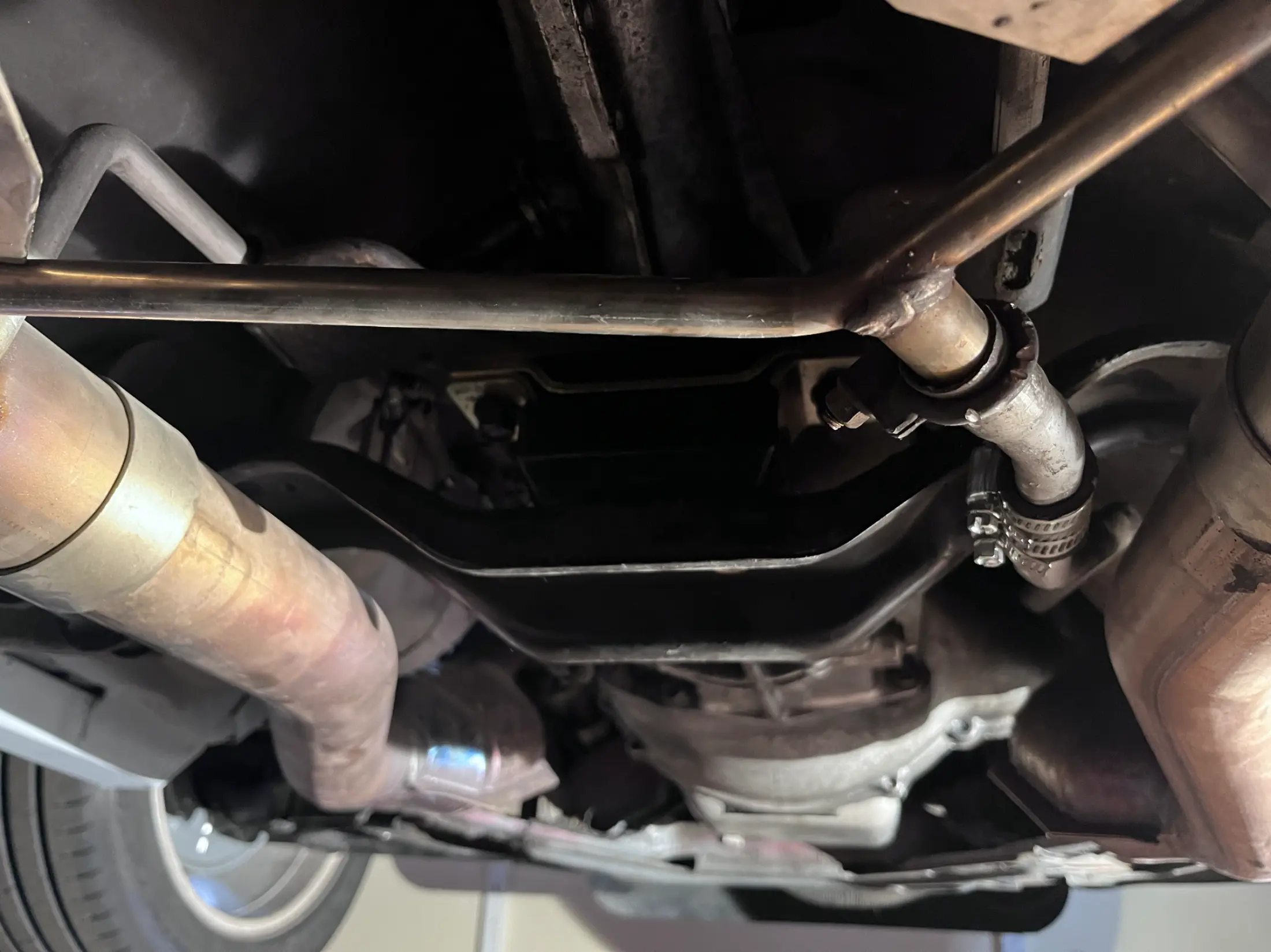

Attempted to change my transmission mount. Got the two bottom nuts off, cross member loose, could not get the two top bolts off. Not much room or leverage. Sprayed them with penetrating oil and will attempt in a day. Gonna be Tetris trying to get the old mount out the crossmember doesn’t lower much as the exhaust is right there.

Got the transmission mount installed. Jesus my impact gun wouldn’t even take off the upper two bolts I ended up having to use a 1/2 ratchet with the end of my jack handle PLUS another bar inside that as a ‘breaker bar’ to get them off, and that was after a day and a half of soaking in liquid wrench. Once off it was smooth sailing to get everything back together:
I’ve seemed to have lost a 1/2” socket in this process too lol

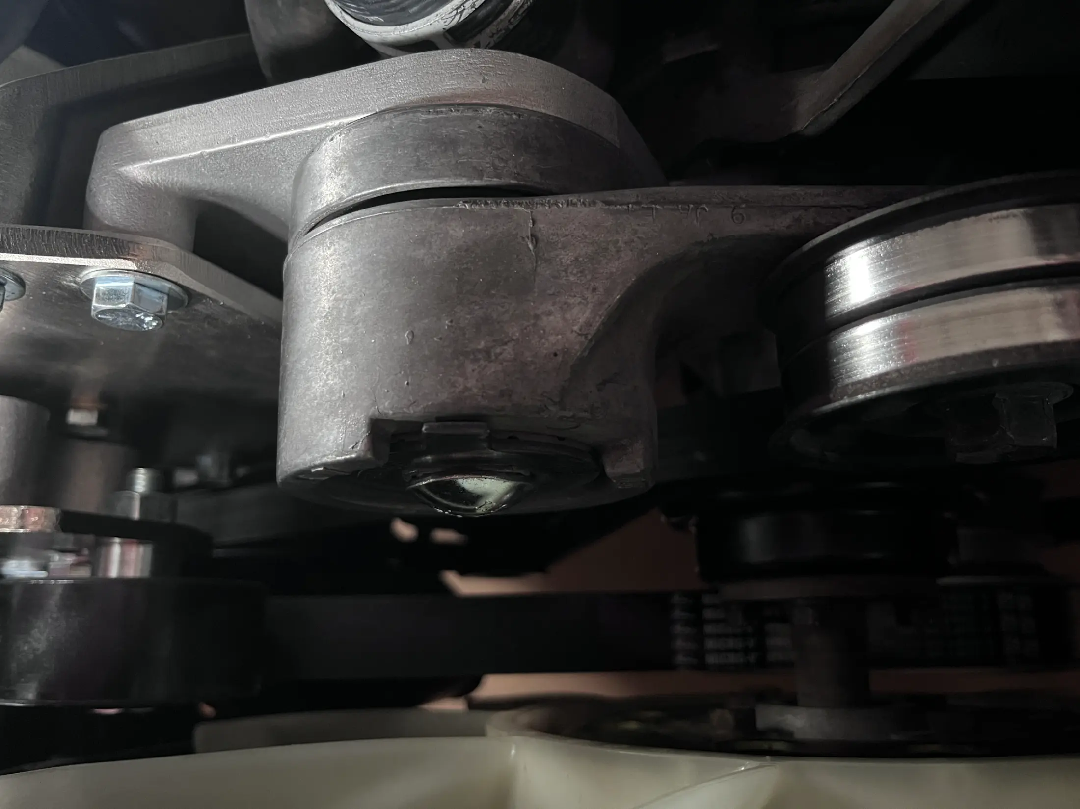

I’ve been looking more closely at my GT length drive belt. When I first installed it it was at the “G” on the “RANGE” lettering on the tensioner. Now, as I’m standing here tonight it’s at the “E”… so I definitely think my GT length belt is too long. This one is 91.56” in length. The Cobra belt I have is 88.9” and I couldn’t get it around the pulleys (which is why I reverted back to the GT belt). So I need a belt in between those two lengths. LMR has another Gates belt measuring 90.31” which I think would be perfect, but when I look up that P/N on oreillys site for example, it says 90 13/16 which would be 90.81”. 1/2” seems kind of significant. I’ll probably buy that Gates belt and see if it works.
Dumb question probably, but assuming I need to remove the S/C belt to remove/install the drive belt? Assuming yes as it need to go over the crank pulley.
As far as pulley alignment I let the car run today again, belt alignment looks good looking down the front of the engine from the side. I did put that nut behind the bracket per the instructions which acts as a spacer. I think my belt is just too long.
Maybe I need a new tensioner? I can push it down further with my hand than what it’s putting tension on its own. Not sure if that’s normal or not.

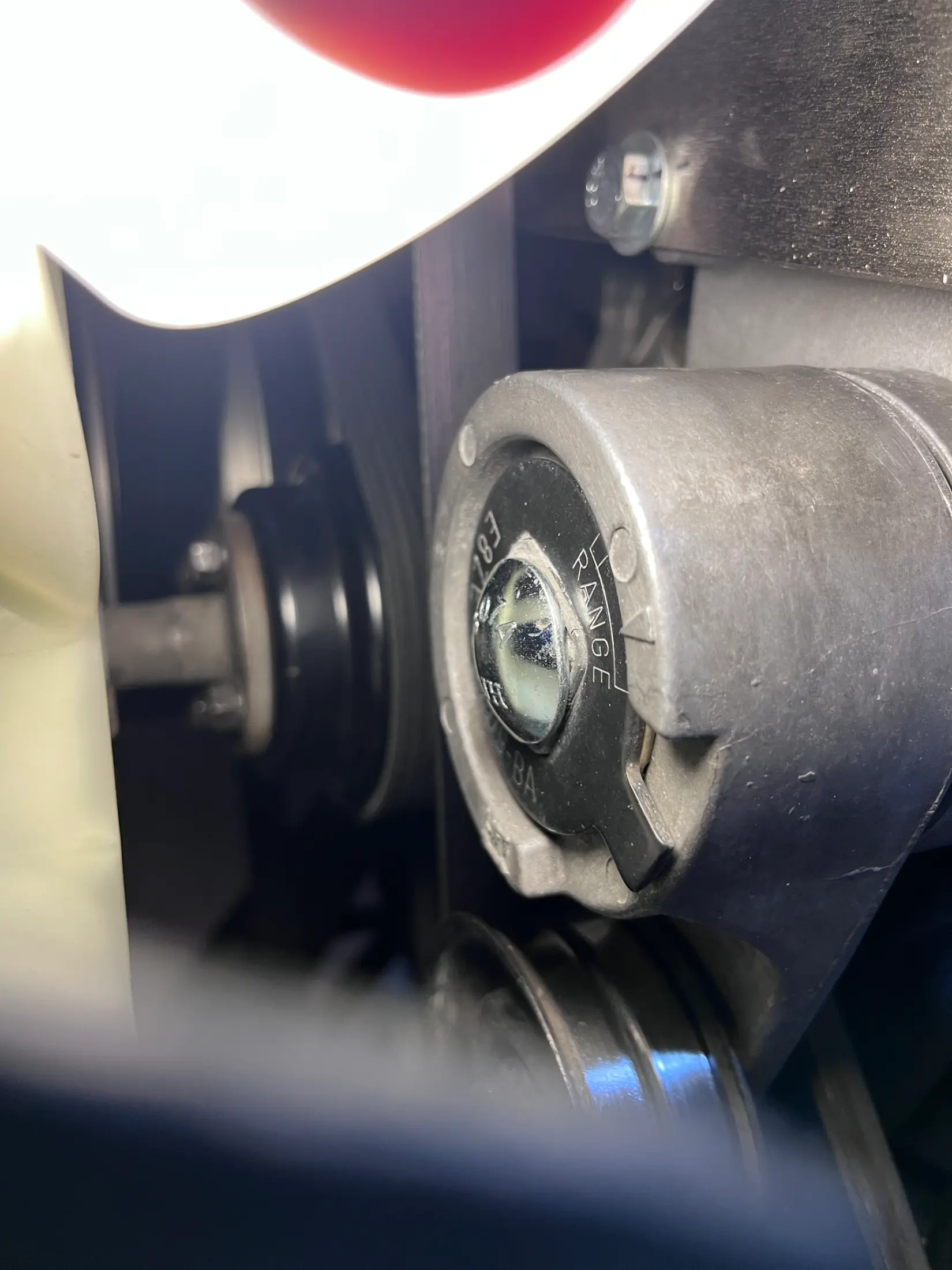

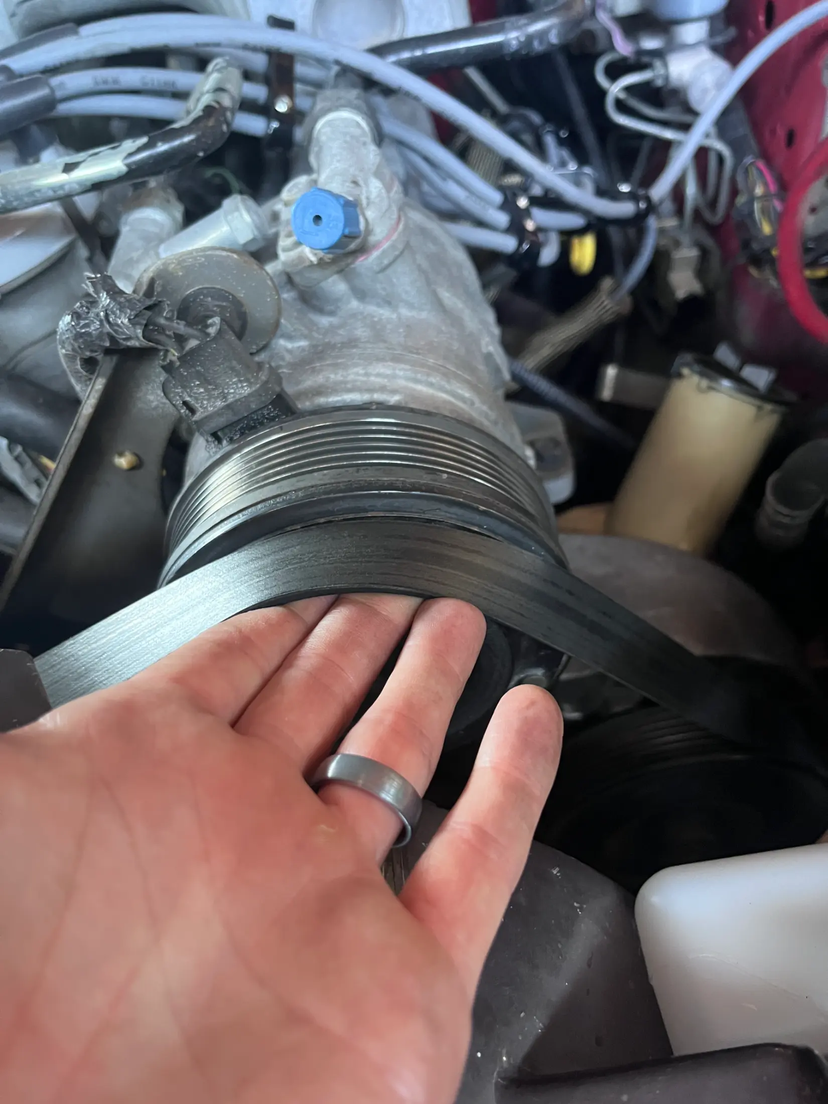

Well, I don’t think it’s my serpentine belt making the screeching noise. Got this Gates belt:
Which puts me here on the tensioner range:
I let it idle and would blip the throttle by hand at the throttle body and every time I did it, the car would screech like crazy. It’s hard to pinpoint with my ear where exactly it’s coming from since it’s so loud, except that it’s front passenger side for sure, which is right where the head unit is so I can only assume it’s that. I will crank it down even harder on the s/c tensioner and see if it fixes it.
Otherwise, if you have a Paxton 1220SL on a stock 5.0 with cobra pulleys the Gates K060905 is a good length belt.

Took @nicholase advice with the S/C tensioner and used my torque wrench set to 55ft/lb. It definitely got it tighter than it was before so hopefully that works. Too late to start her up now to test, but fingers crossed!
