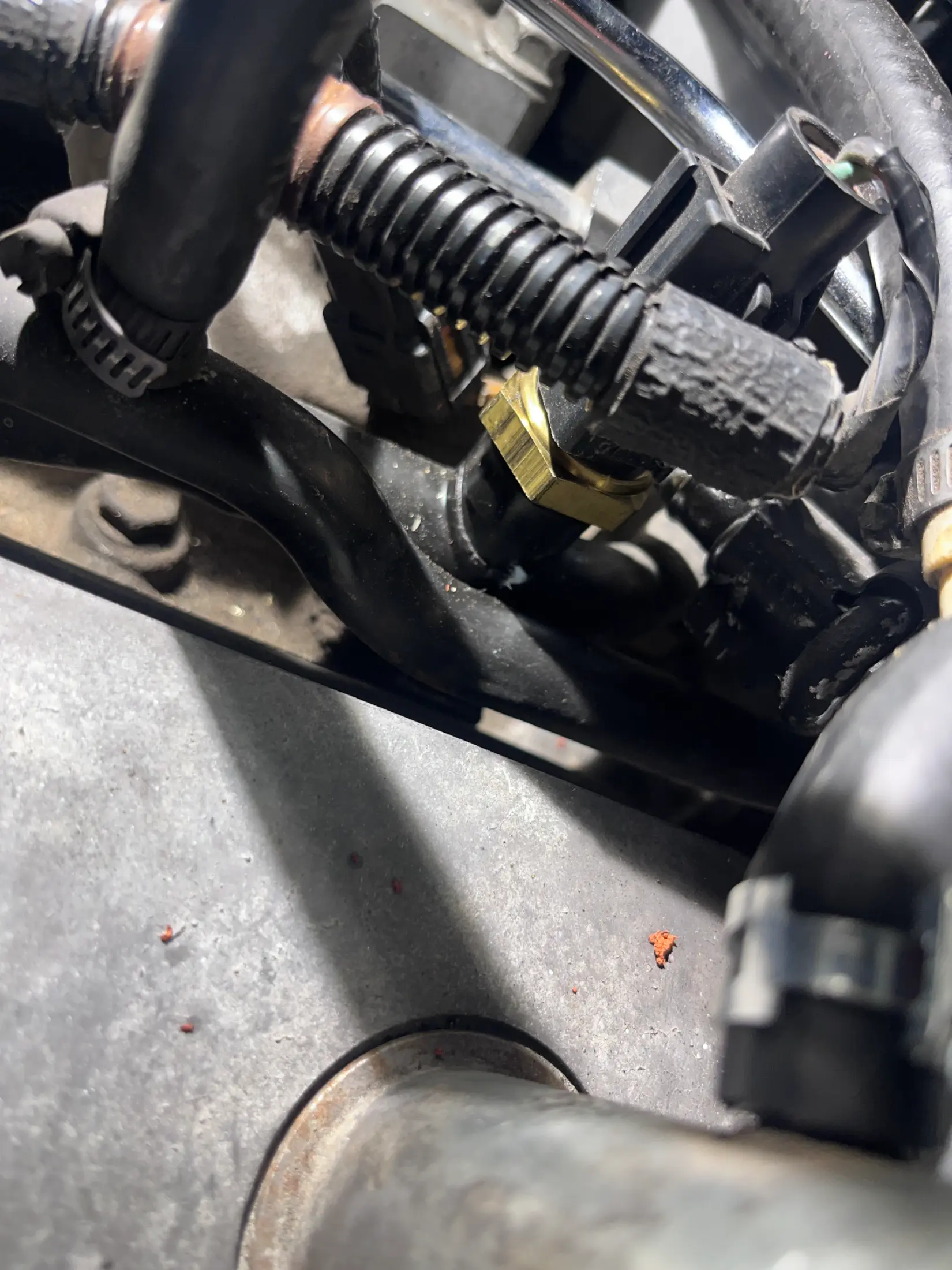

Got the ECT sensor replaced. Kind of a pain in the butt getting a wrench on if you don’t have a big enough deep socket. Had to disconnect battery, drain some coolant, and disconnect IAC sensor and I only had a crescent wrench that would fit so just little by little flipping the wrench each small turn.

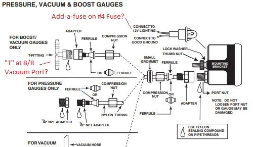

Started planning out my gauge installation last night. My A-pillar Autometer mount should be arriving today. I took out the boost gauge last night and got the vacuum line hooked up to the gauge side. That will just "T" off the B/R port on the vacuum tree where the FMU vacuum line connects to (I believe?). For the gauge light power/ground and gauge power/ground, what are some good power sources to tap into and good places to place the grounds? I was going to just tie the lightbulb ground and gauge ground into one single ground with a ring terminal, if thats not a bad thing to do.
I haven't opened up the wideband box yet, but assuming it also needs a light power/ground and gauge power/ground. Can i tie together both gauges light power wires, gauge power wires together and then ground wires together so i just need to splice into one light power source, one gauge power source (instead of having multiple splices into the OEM harness) and then ground them all together at one location?
Sorry, electrical is not my strong suit.
Edit: #1 after reading some Boost gauge install instructions that i could find online (not the Autometer instructions), it looks like i don't need to hook up any gauge power/ground wires. Should just be the light source power/ground and the vacuum line?
Someone also seem to use an add-a-fuse in the fuse panel for the lightbulb power source. They mentioned fuse port #37, but it looked they were installing it on a SN95, not a Fox. An add-a-fuse seems like an easier option.
Edit #2: ok it looks like i should be able to add-a-fuse to #4 fuse port on the fuse panel, just need to make sure the fuse can handle more than 15amps. I should note that i don't plan on driving the car at night, but would like the connections there just in case.
This is where i'm at currently:

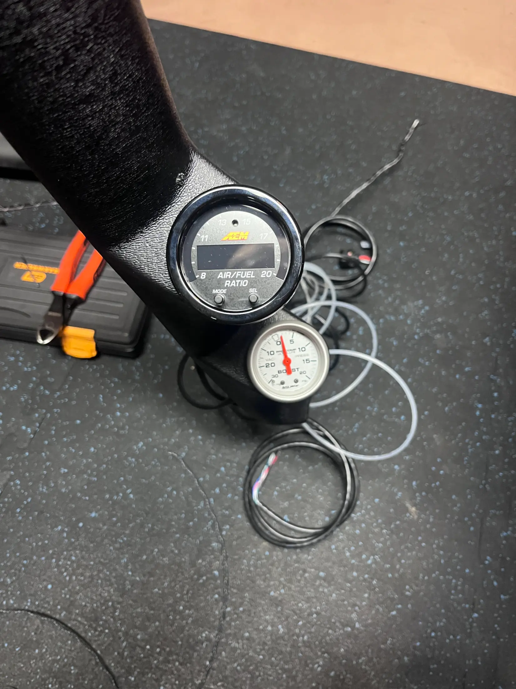

Got this far with the gauges:

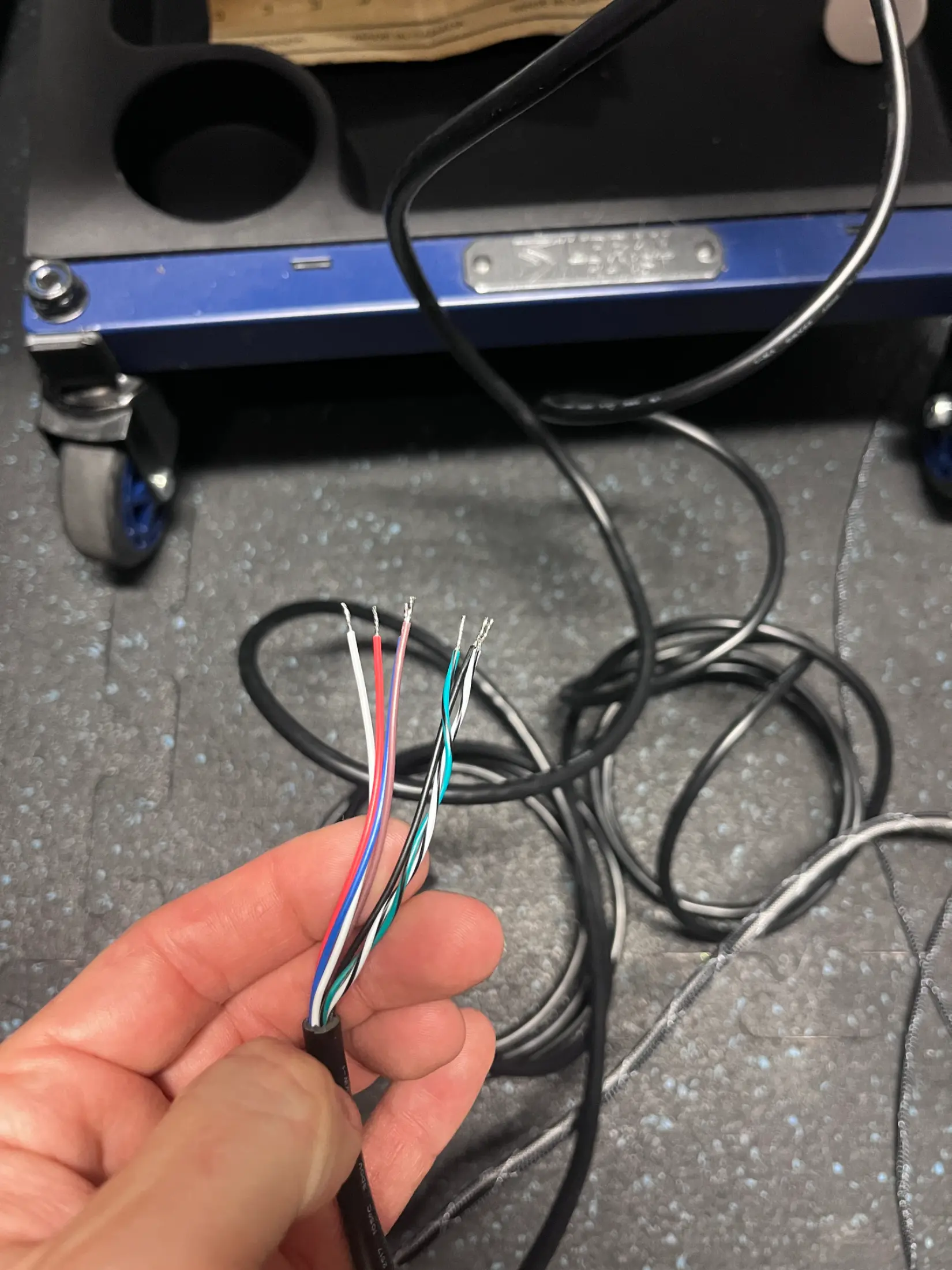

My plan is to run everything from here out and cut to length (with wiggle room). I really don’t like the idea of drilling extra holes in my A-pillar, but I don’t see how I couldn’t just to run the wires, let alone stick the gauge pod to it. When smooshed together there isn’t anywhere for the gauge wiring to go, like I’ll have to cut a big hole at the bottom of the A-pillar piece (as far as I can tell), plus the holes for the push pins to hold the gauge pod on. That or double sided tape, but that doesn’t solve how the wires will exit the A-pillar ‘assembly’.
Also, as I mentioned I suck at electrical work, wtf is this:
There were no instructions provided with the AFR gauge. I’ll research online but I was kind of only expecting a white and black wire (power and ground) and a lighting wire. There’s 7 wires!

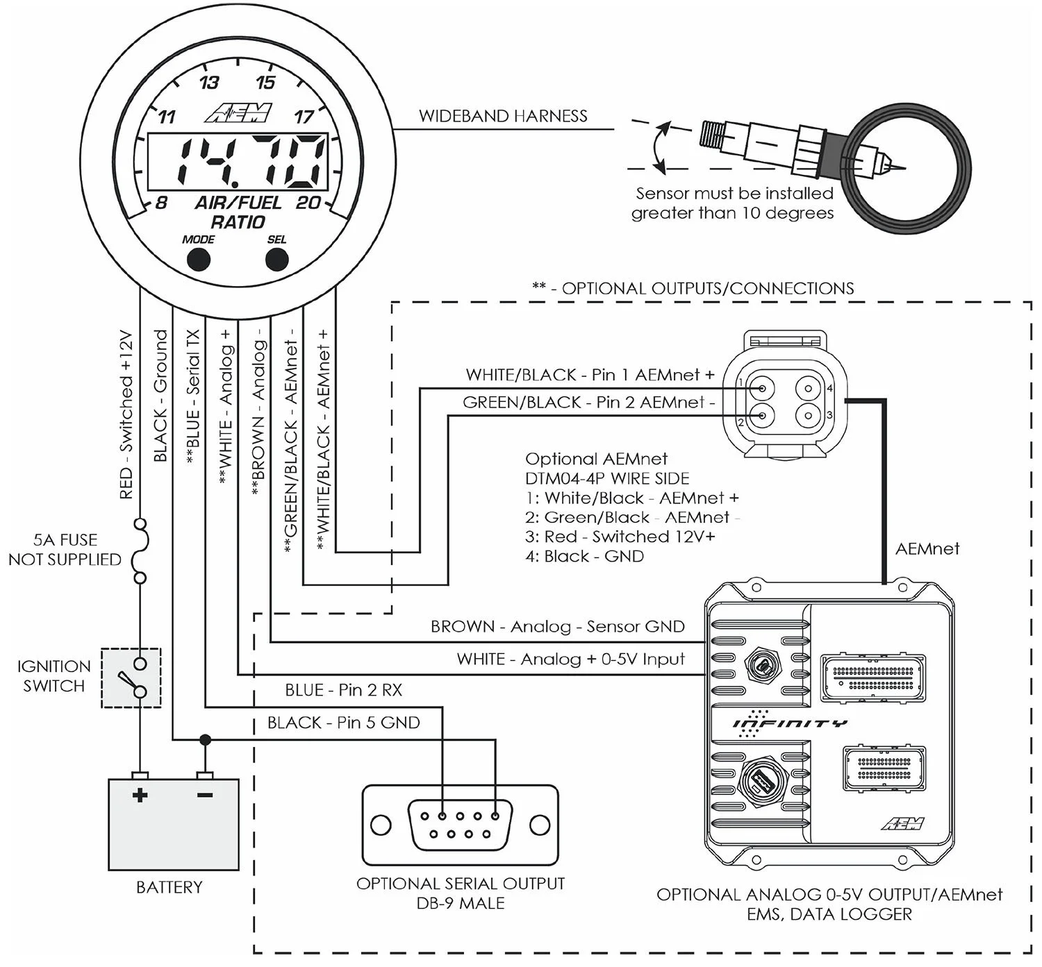

Ok from this diagram I believe I only need the red and black wires (switched power and ground). Everything else seems optional for additional capabilities:
Much more palatable.

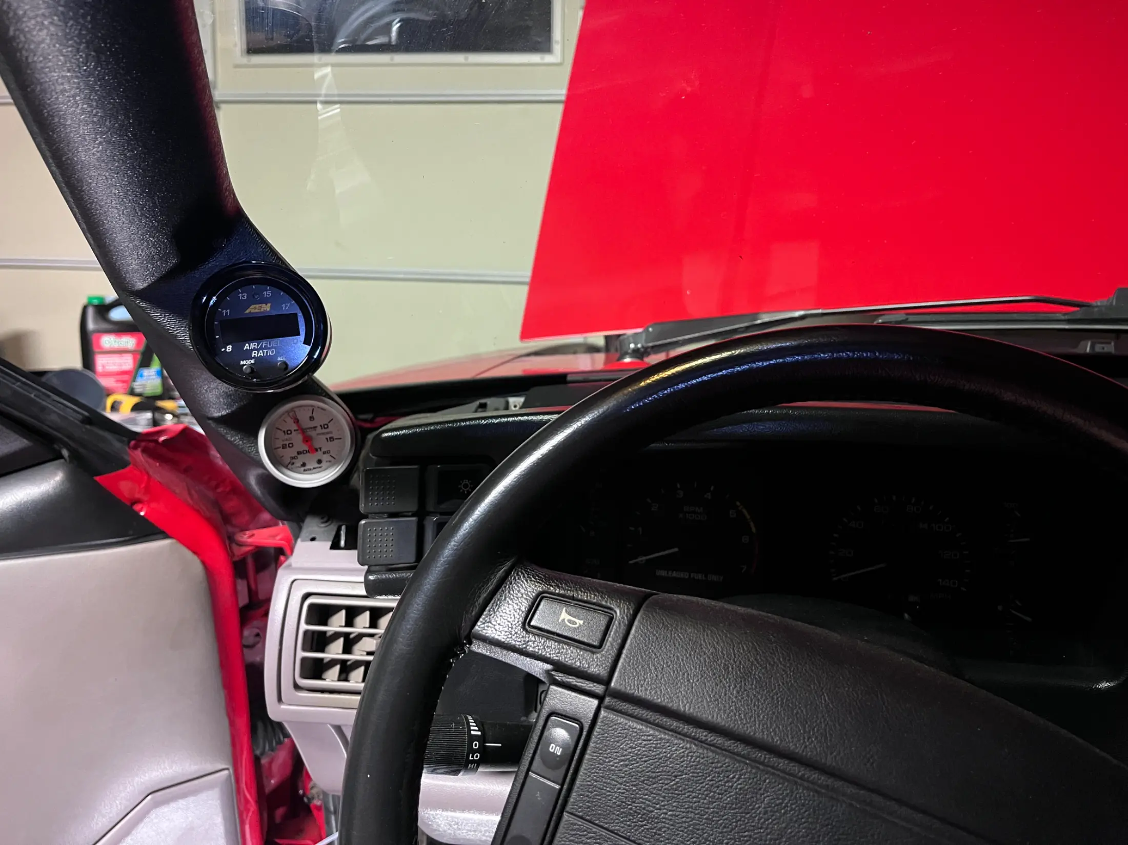

Only got as far as getting the gauges ‘in’. Haven’t ran any lines except to down by the kick panel. Gave up on trying to get the speaker bezel in, can’t tell for sure but I think the easiest way will be to remove the cluster. So that’ll happen next time I remove the cluster (actually do need to fix something inside of it at some point). I feel like it’s somewhat half ass’d at this point, something I’ll have to revisit and button up properly.
Anywho, here’s how they look:
