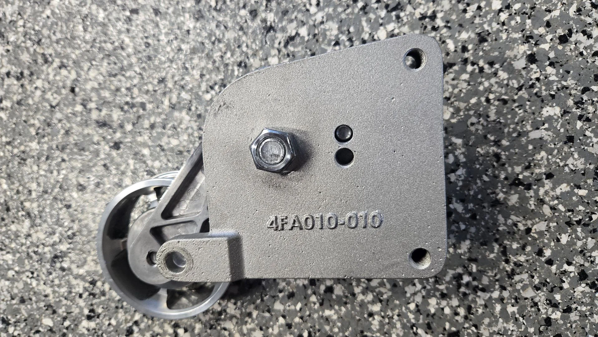

Same deal with the relocated belt tensioner. It's relocated to be almost touching the AC pulley. Trust the two bolts holding the tensioner bracket to the vortech bracket are true, and also trust the single bolt holding the other end of the bracket to the water pump is flexing it a little out of line when tightened.
When all that is sorted you can fine tune your belt length. The Vortech relocated tensioner is in a different relation to the belt than the stock setup.
On the stock setup there is quite a bit of slack created when the tensioner arm is fully turned because when under tension it dives deep into the belt. There is a bunch of belt bent around the pulley. You could probably get away with several different size belts because of all this movement.
On the vortech setup the tensioner is relocated and doesnt dive as deep into the belt. There is little to no belt wrap around the tensioner pulley when under tension. So when you fully turn the tensioner it just doesn't create that sort of slack for any margin of belt lengths.
Finding a belt that fits around the pulleys and allows the tensioner to properly tension the belt can be a little difficult. If anyone has done this you'll know even with the tensioner arm fully turned and completely out of the way of the belt, the determining factor is if the belt will go around the rest of the pullys or not.
I went through several belts until I found one that fit snugly around the pullies but I could get it on pretty easily by hand. However I felt the tensioner wasn't applying enough tension and the next size smaller belt wouldnt fit around the pulleys by hand.
To remedy this I drilled a second hole in my tensioner bracket for the tensioner nub to go through. This clocked the tensioner more and allowed more spring tension on the belt.

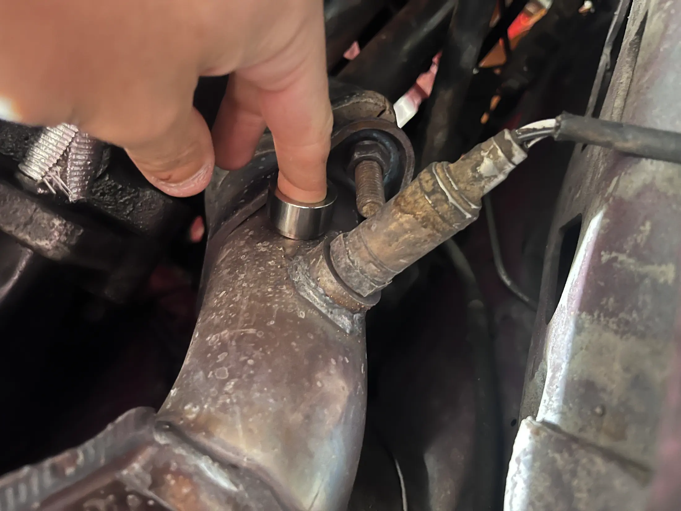

On another note, is this a good spot to have the wide band bung welded in? It would make the sensor be easily accessible, meets the 10 or 15 degree above center requirement and is before the O2 sensor. However, it’s very close to the O2 sensor and I’m not sure if that matters. The guy I would have weld it in (same guy who did my subframes) would probably need me to like tell him where to weld it in and he just does the cutting/welding. So I wanted to literally mark with a sharpie where it needs to go.
This is the drivers side view of the xpipe looking up where it meets the headers.
Most widebands give the clock position and also the minimum distance from the closest exhaust port on the head. It's probably around 18" or so. Widebands generally need to be further away than narrowbands because they can't take as much heat. You might have to make some concessions and have it closer than recommended because you're running the cali cats. I'd put it (before the cat obviously) as far away as possible where you can maintain you clock position.
Oh, and once you sharpie it, tap a center mark with a center punch. The sharpie mark will likely burn off on the way.
