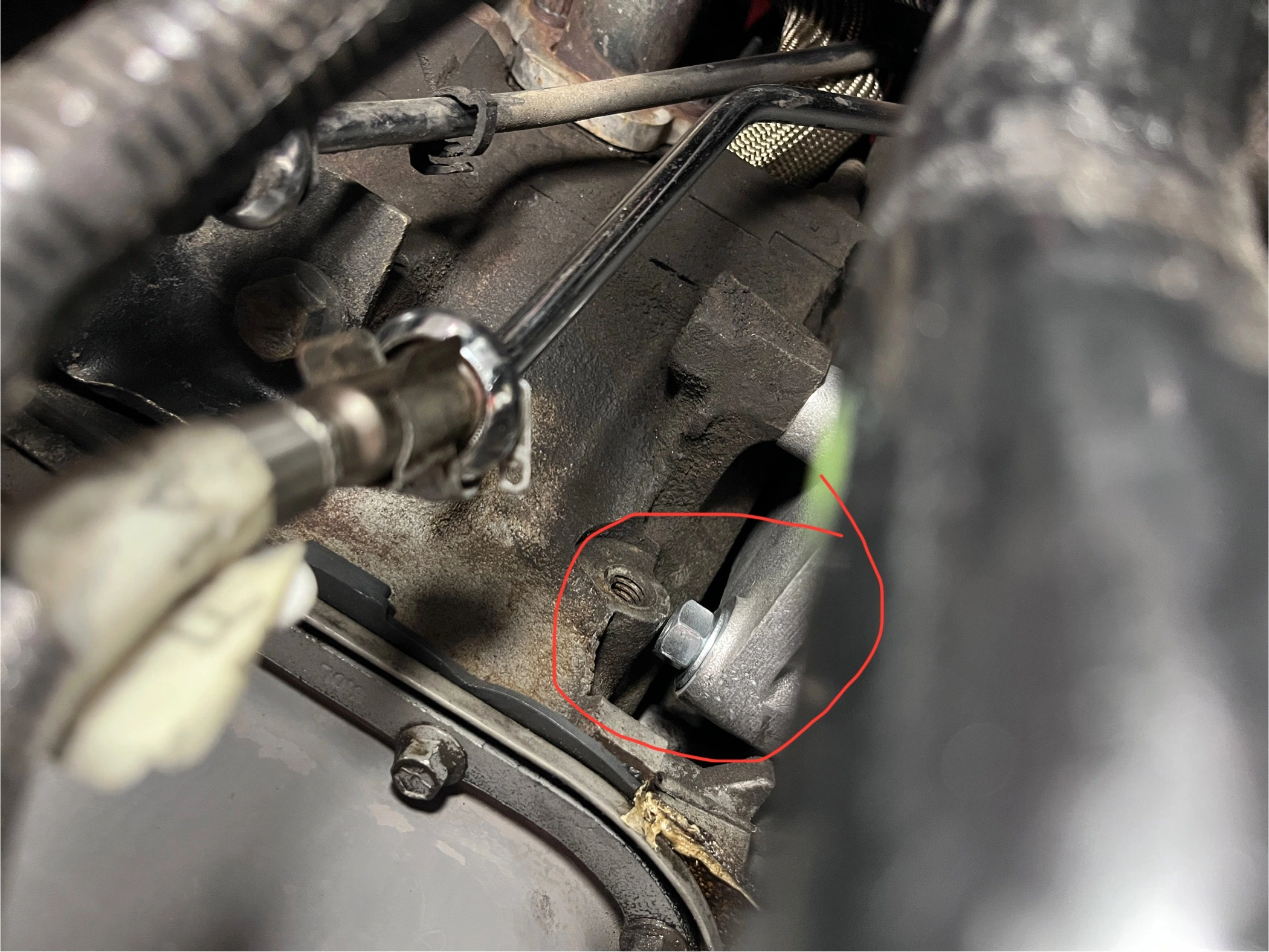

If anyone remembers back in my thread, I thought I was so smart not following directions and installing the alternator supercharger bracket bolt ‘backwards’ so you could remove it without taking the whole bracket assembly off… turns out, after much investigation, that bolt is too long to go in backwards and it was literally hitting the block when fully tightened down… which I suspect with the force of me tightening it down may have ever so slightly pushed the alternator (and maybe the entire bracket) forward.
Anyways, I figured this out so I took the bolt off and removed two threads worth with a dremel, reinstalled it and it no longer hits the block when fully tightened down.
You can see how close the nut is in this photo, picture two full threads of the bolt sticking out of the nut and just pushing against the block.
Anyways, all my stay bracket adjustments may have been for nothing since this bolt could have been altering the angle of the alternator.
Can’t start the car now but I’m confident I can adjust the stay bracket knowing nothing else may be affecting the pulley alignment. Or, I still can’t get it right and pull what’s left of my hair out.

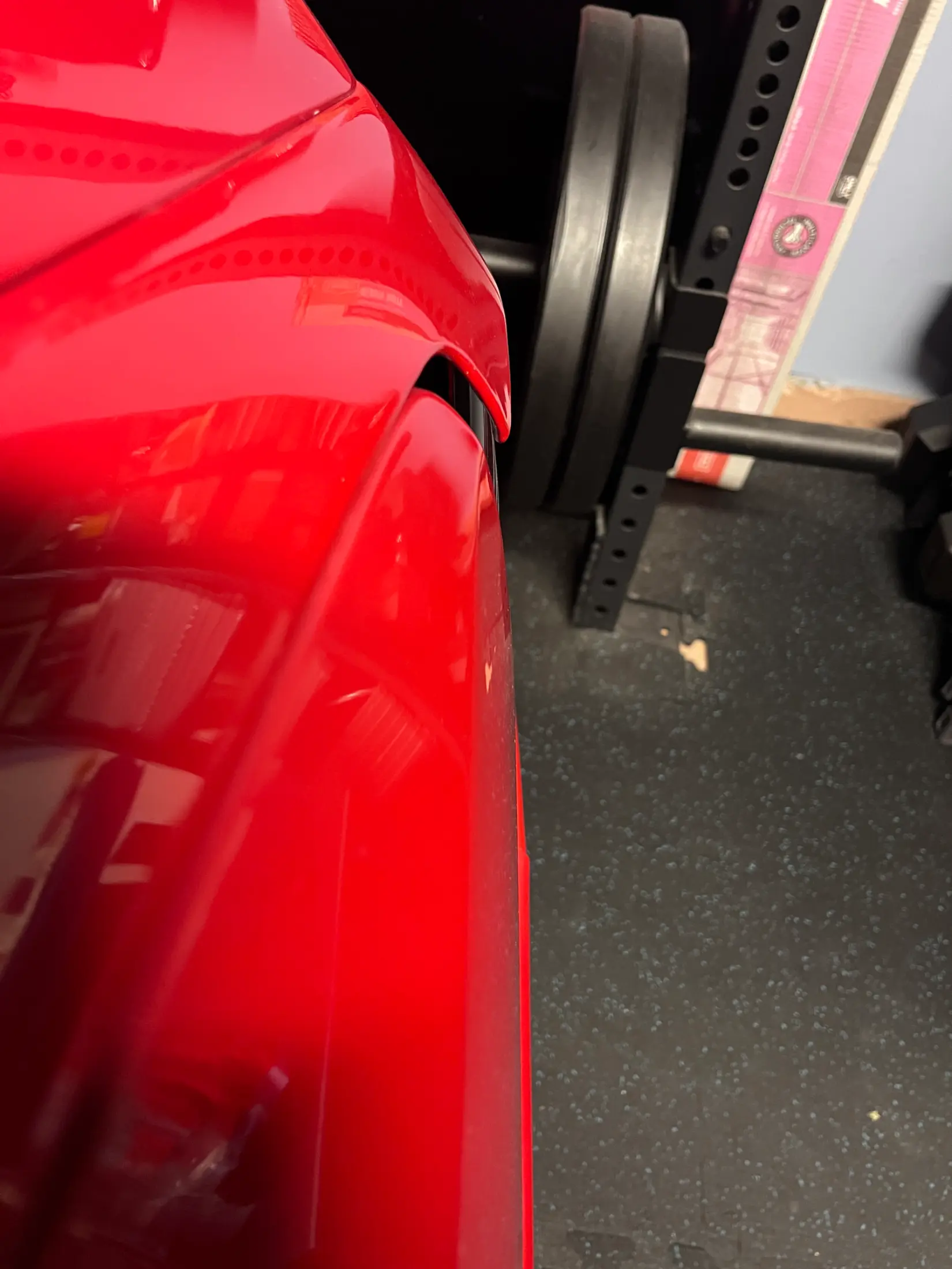

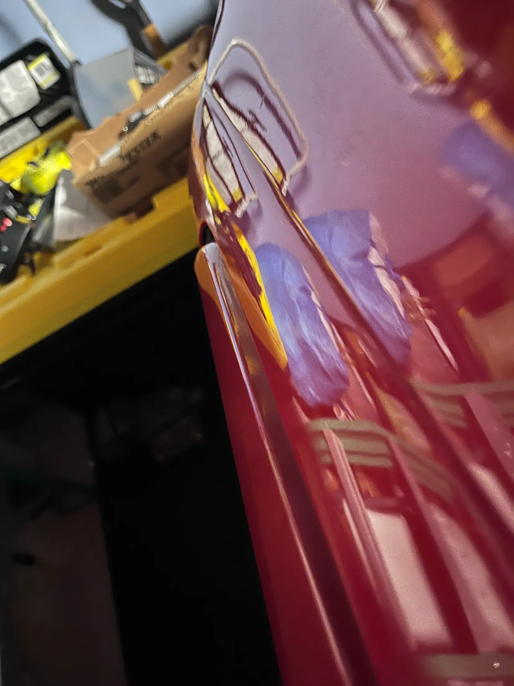

So I daily drove my Mustang the week before last to work, and I noticed a knocking noise when going over bumps in the road. At first I thought I didn’t tighten my rear shocks or something all the way (wouldn’t put it past me), but after looking around further I realized my hatch isn’t centered correctly. The drivers side you can push down after it’s latched and create the same knocking noise. The passenger side you cannot push down at all after it’s latched.
Here’s the drivers side:
And here’s the passenger side:
So you can see how it’s off centered.
What adjustments can I do to recenter it as well as not allow it to be pushed down (and create a knocking noise) after it’s latched?
It does have the bump stops on the hatch, but they do look a little old and crusty.
I can see them.
Any idea on how to adjust the hatch back to center? I can't recall if its always been like this, or if it moving off center is new. I only noticed it recently but i've also been driving the car more lately.
Striker bushing looks really good. Hatch latch all looks good, not bent or anything. Hatch hinges look fine, but i've read there are no side to side adjustments there, only up and down.
I feel like @FastDriver tackled this same rattle a while back on his Fox,if I’m remembering right he got some billet strikers etc
I ordered a FiddleFartFab striker. If it doesn’t work, still a cool piece to have.
Edit: after doing some further research, it looks like you can adjust the striker, so once my fiddlefartfab striker comes in, i will test to see if i can move the striker like a 1/4" to the passenger side.
Reactions: 85GT4V and RaggedGT
Nope... I just did this yesterday, so good timing! The hatch bolts to the top with 2 bolts that you can access if you remove the rear ceiling cross panel in the interior. You'll need a buddy to hold the hatch and disconnect the hatch err... shocks. Then, close the hatch, center, crawl inside and tighten dow the hatch bolts. Have your biddy lift it back up, and then reinstall the erm... hatch shocks.
I tried the FF strikers, and after blowing money on the wrong ones and being refunded, I ran into him at Foxtoberfest, last year, and got his new ones. They worked with my doors. They did not work with my hatch. Well,... they rattle. That said, after recentering it, last night, it is working now on the FF hatch striker. But... It's making lots of noise. Makes me wanna go back to the plastic bushing, but I wanna try adjusting the striker a bit lower so that there's little to no slack, which might prevent rattling. If that doesn't work, I'll reinstall the stockers. I have to say that my 93, with a different latch has no issues. So, I might eventually convert both of my 91s to the 93 hatch lock & maybe door locks (for 1 key).
