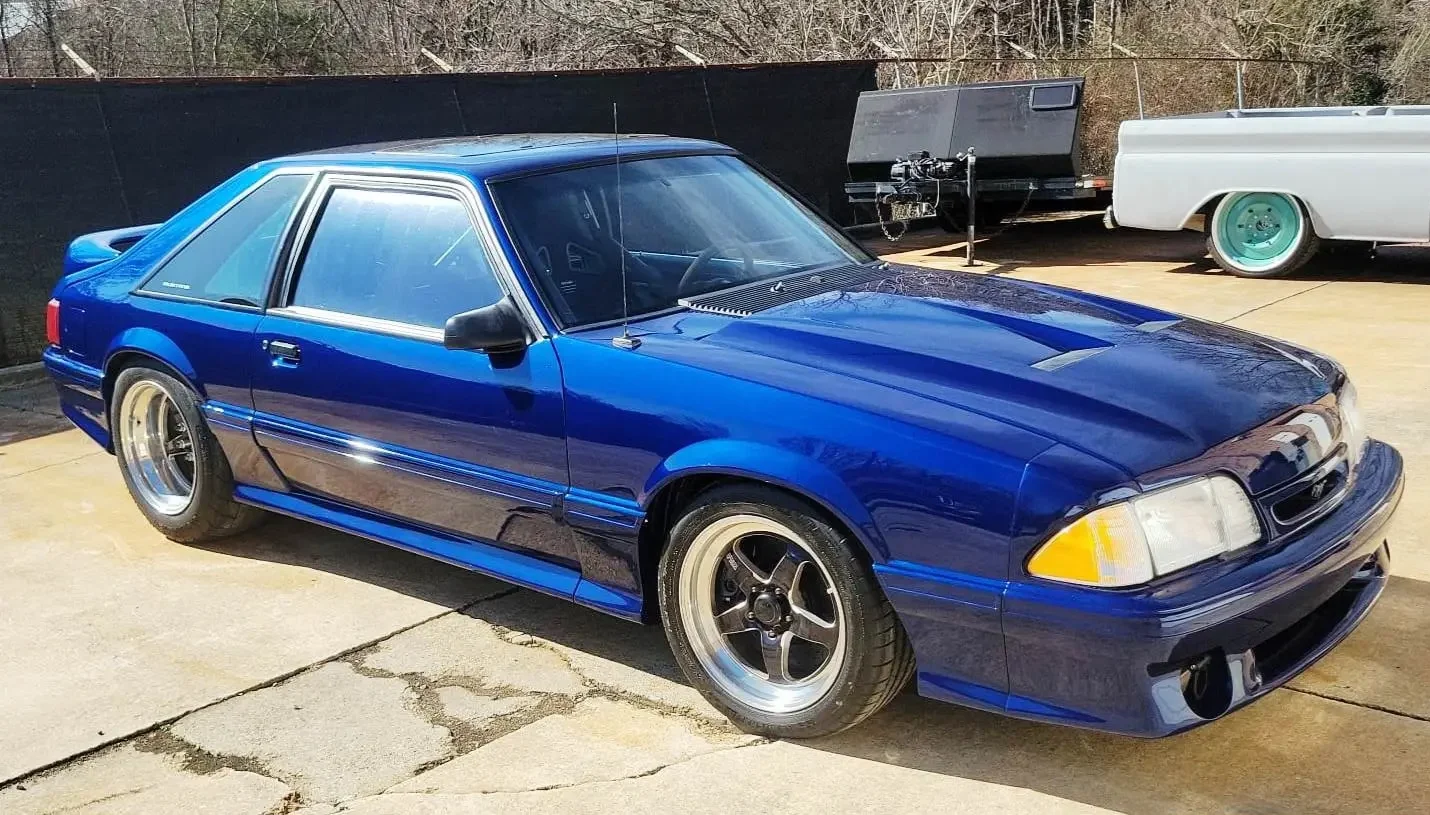

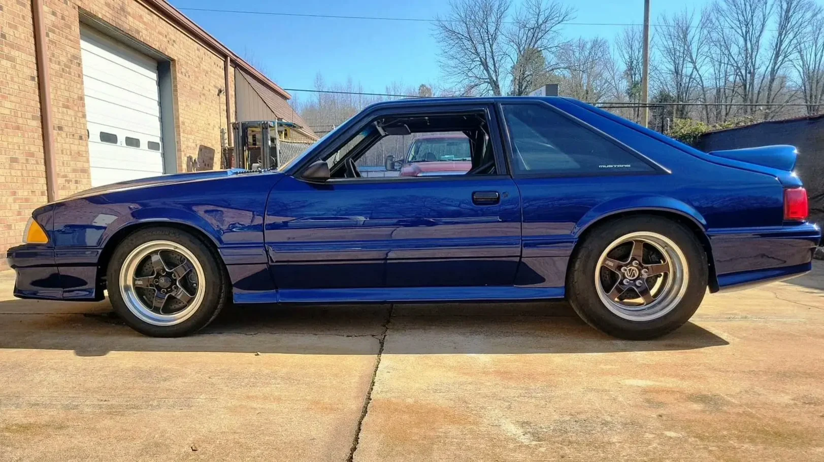

Cowls are actually designed to take air from the high pressure area and feed a closed off carburetor with cold air. I guess they made it into our fuel injected cars because so many like the style. I have mine on for the looks, and weight savings -- it's a Kaenen & is probably the lightest available foxbody hood -- and they can also help when you have a taller motor and/or intake. They definitely do allow the air to vent at idle, as I can see the distorted air from the heat rise. I'm not sure how effective they are at cruise or high speed for cooling the engine bay, but I would imagine they hurt radiator flow to some degree. My personal favorite, and likely to be just about best for the radiator is the '03 Cobra-style heat extractor hood. Can't get over how good it looks on Father Time, too:
It was the right call for Father Time, and gave me the 2" Kaenen Cowl hood to swap out Black Jack's stock hood for free:
If this is hijacking, I'm happy to pull the post back down.
Anyways, I still think your louvers will be better than a cowl hood for radiator heat extraction, and frankly it's more unique & better looking when done right, IMO.
Reactions: General karthief, 85GT4V and RaggedGT

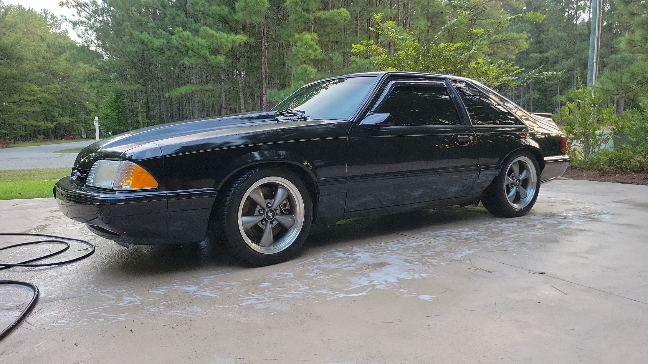

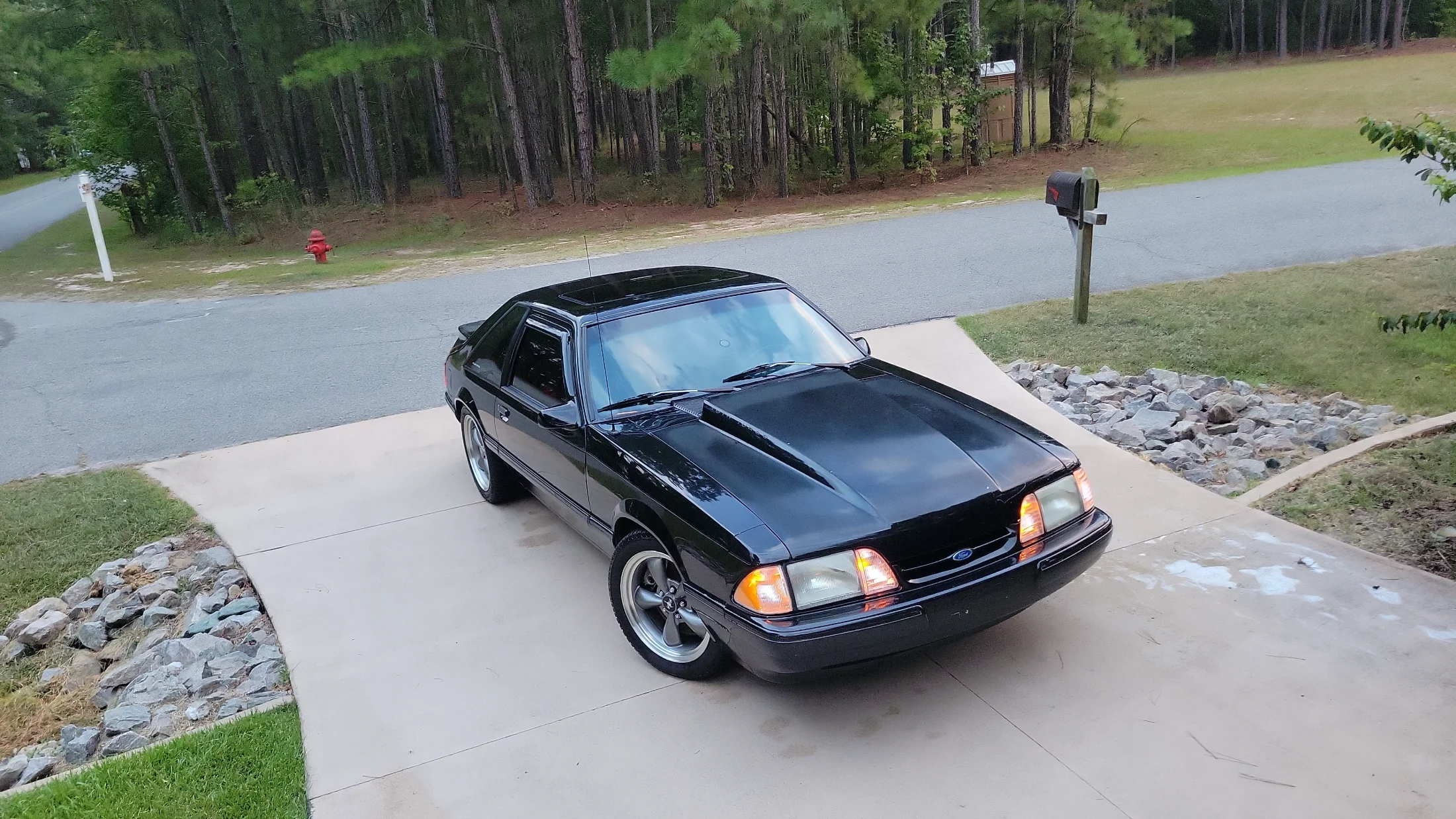

Ya the 03 style hood is fantastic. A new hood just wasn’t in the budget… not that the race louvers were cheap, but cheaper for sure.
“When it’s done right” haha I’ll be cutting up my hood myself so that is yet to be determined!
But I also think they will look good, unique at least for my area… I rarely see foxes let alone any with louvers.
Both your cars look great!
Reactions: FastDriver

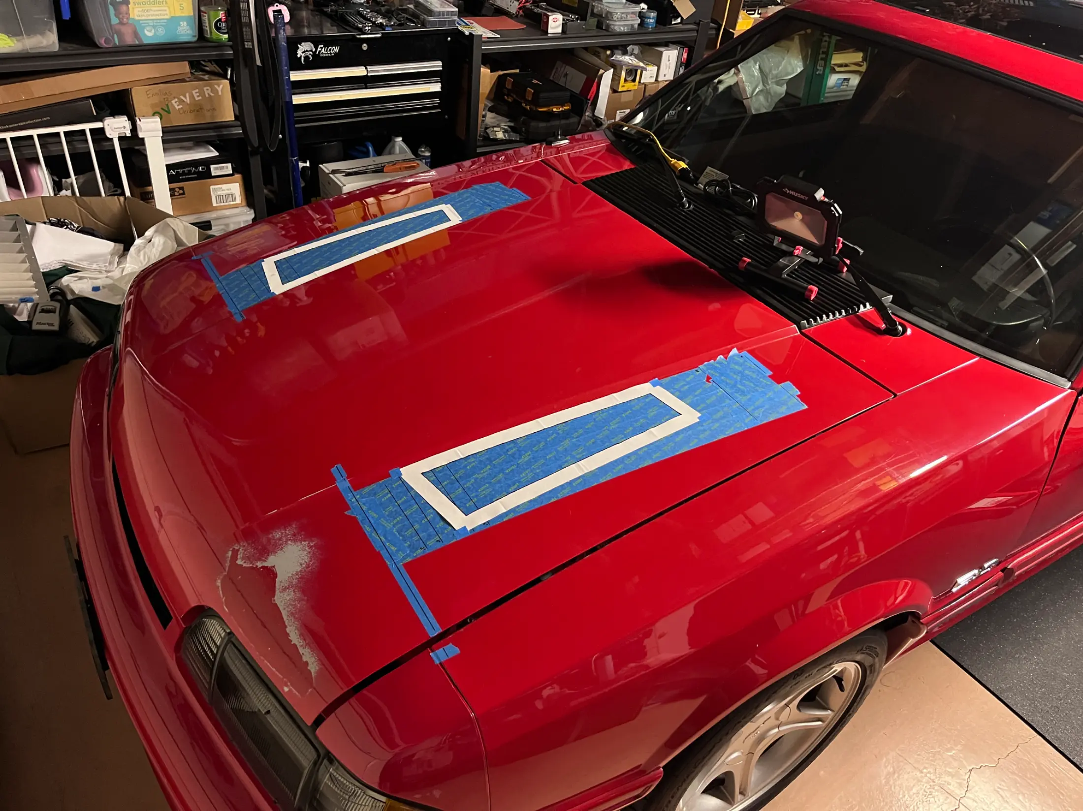

Alright I marked 2”, 3”, 4”, 5” and 6” back from the radiator. Moved the louvers starting at each measurement multiple times, stood back and looked, adjusted again, relooked, etc etc.
Then I thought to myself… what am I doing here? 1” adjustments forward or aft is not going to make a difference for me. So I split the range difference and put them starting on inch 3. Not sure when I’ll actually be able to make any cuts, but this is where they will go:

Front to rear looks good to me. Maybe a dumb question, but it looks like you're putting them as close to the middle ridge in the hood as possible. My intuition would be to try and space them with equal distance to the inner ridge on one side and to the edge of the hood on the other at their widest point. The earlier pic seemed to do it that way. Seems a purely aesthetic decision to me.
Another thought, those fins dip down quite a bit. I can't imagine there would be a clearance issue underneath, but it's something I'd want to measure to be confident before I cut.

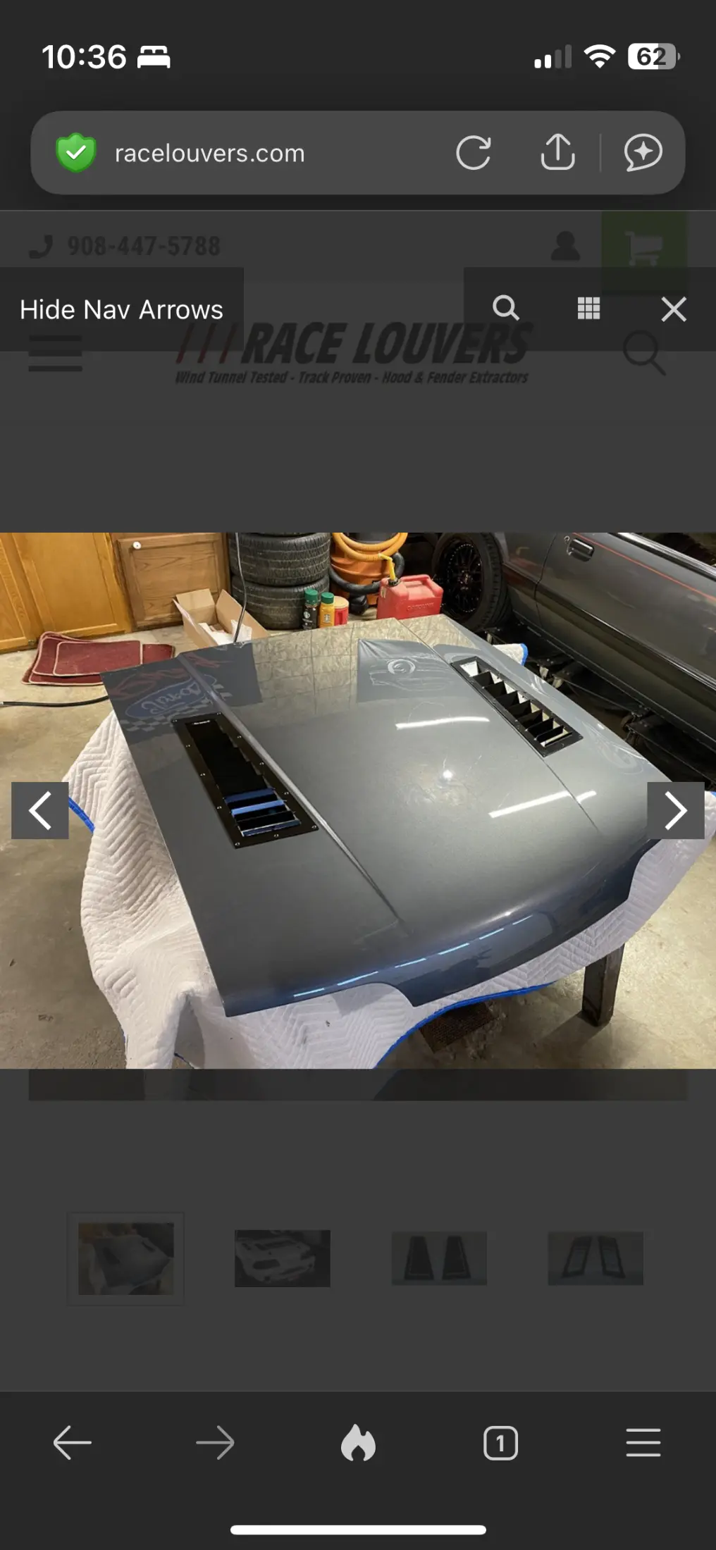

Only reason I have them placed so close to the stock ‘cowl’ ridge was this photo taken from Racelouvers.com website:
I just assumed that’s where they needed to go. Lol
I will definitely check clearance because yes the fins do extend downward quite a bit. Eyeballing it, I should be behind the supercharger head unit mostly above the discharge piping, but will verify. Drivers side shouldn’t have much in the way I don’t think.

Looks great! Better than I thought.

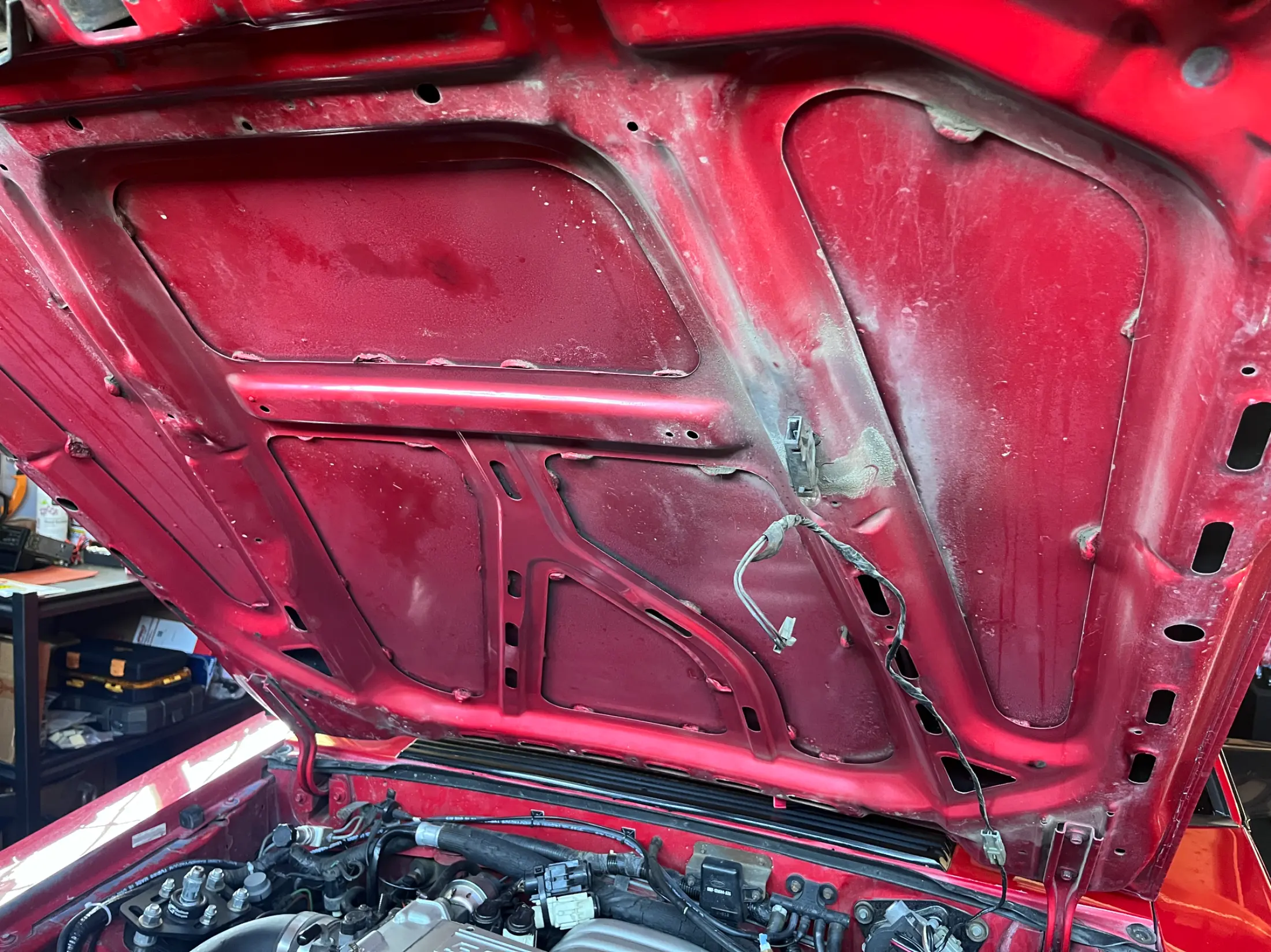

Its too bad they did not have a picture of that hood from Racelouvers.com showing the underneath side. I am wondering how close they are to the hood structure.
Just eyeballing it right now it looks like none, they should go right in this open areas like to the right of my hood light but on each side:
I need to more accurately determine how close they get to the long hood structure the hood light attaches to though.
Reactions: FastDriver and AeroCoupe
