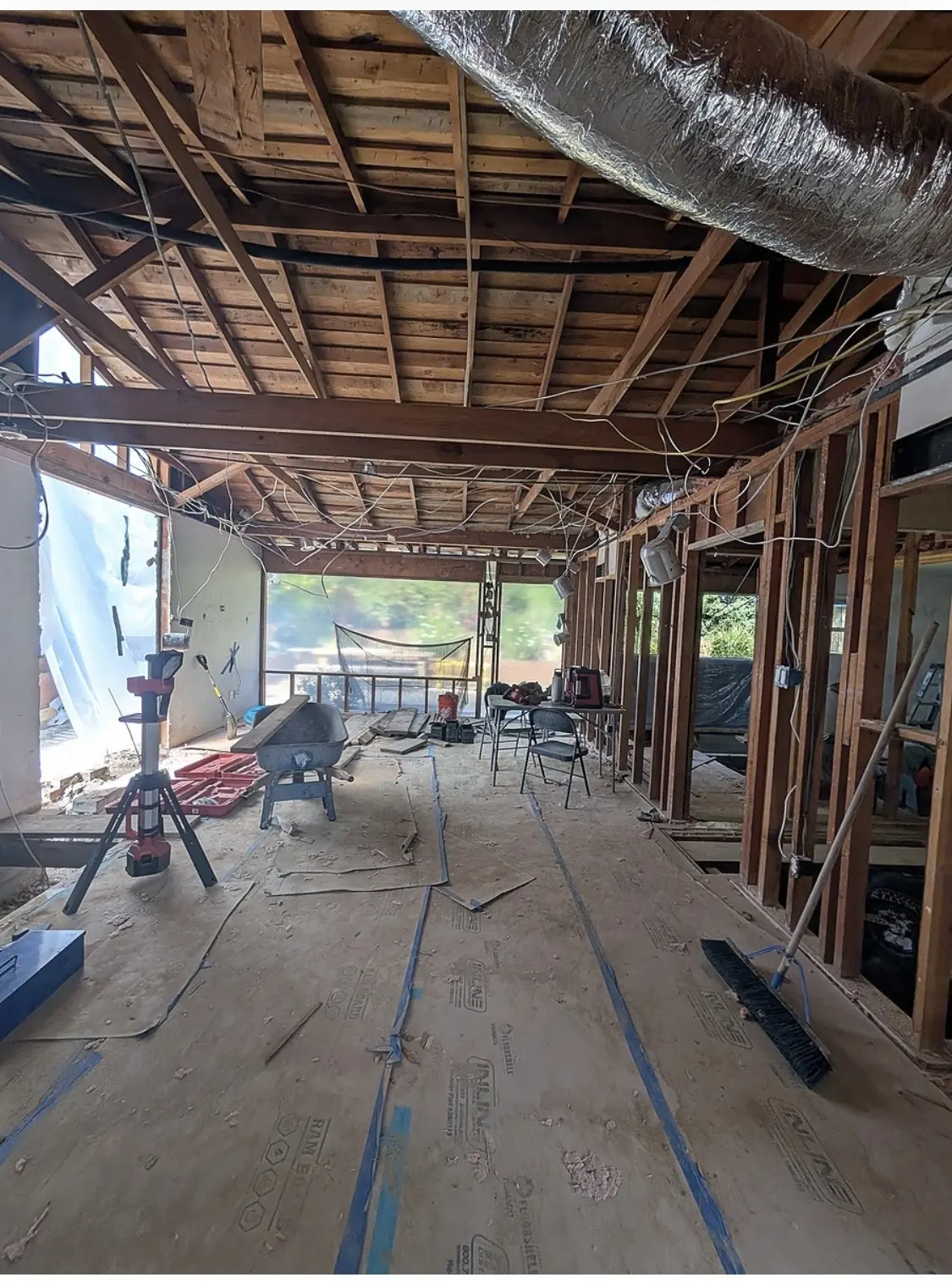

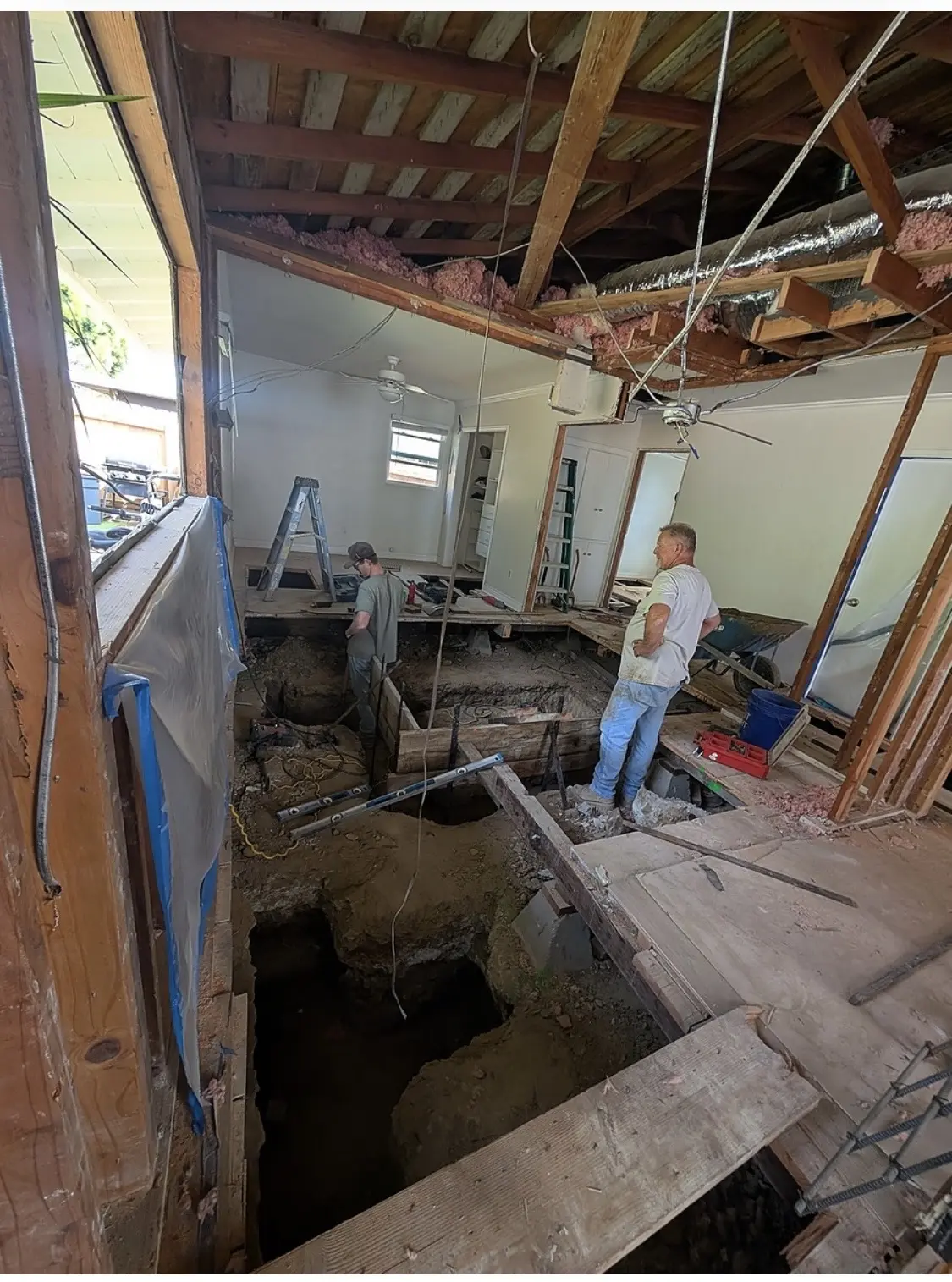

And if anyone is curious how the house project is going:
Reactions: bird_dog0347, 91AOD5.0LX, DadLife0724 and 1 other person

gkomo said:
And if anyone is curious how the house project t is going:
Nothing a little bit of duct tape and some drywall mud won't fix....
None required. This is the new Cali-Bohemian.
All the kids are doing it.
Reactions: General karthief, idareu, DadLife0724 and 1 other person
