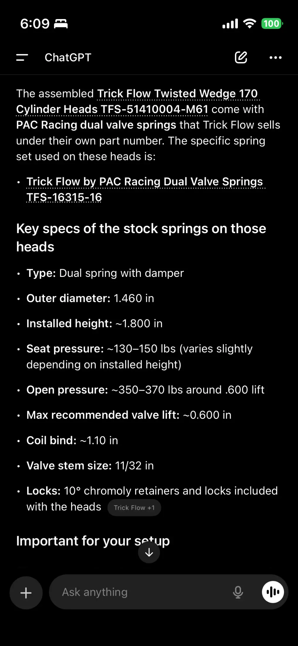

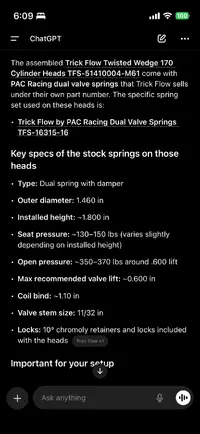

Was kind of back to thinking about the engine rebuild… one quick question is regarding roller rockers. With the TFS twisted wedge 170cc heads, stock bottom and stock cam, should I run 1.7 rockers to gain a little bit of extra lift with with the HO cam? ChatGPT says lift will be .472 with the 1.7’s as opposed to .444 with the 1.6’s when utilizing the stock cam. And also just verifying I need 7/16” stud mount rockers?
If you do all of that, and add boost, I might be worried about whether the springs are up to the task.
I don't know what springs come with those heads either or if you selected something else.
Couldn’t find too much information about what “upgraded valve springs” means in the description except for this sentence from trick flows website:
Assembled Twisted Wedge 170 cylinder heads arrive ready-to-run out of the box with top-quality valvetrain components to ensure great durability and longevity. This includes stainless steel valves, bronze guides, PAC Racing valve springs, thread-in 3/8" or 7/16" rocker studs, and chromoly retainers.
Also I guess you can do either 3/8 or 7/16” stud mount rockers?
Edit: ChatGPT says:
