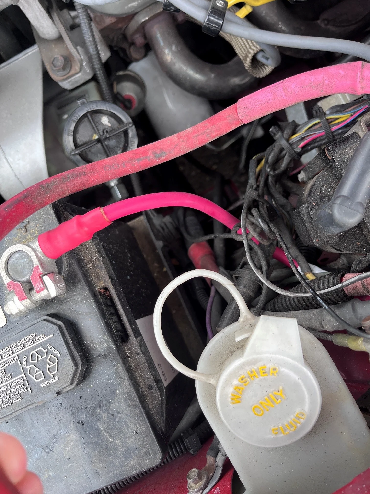

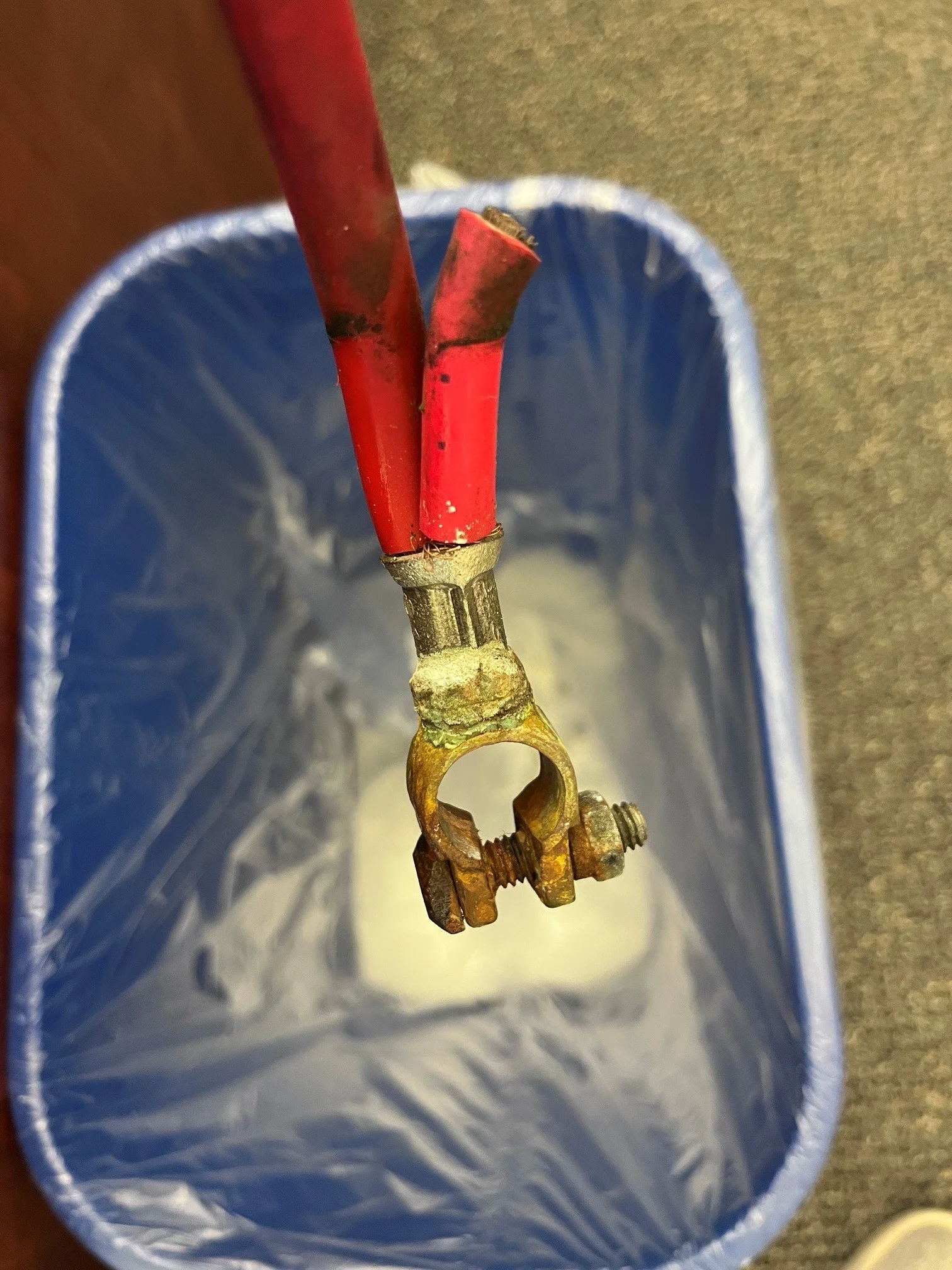

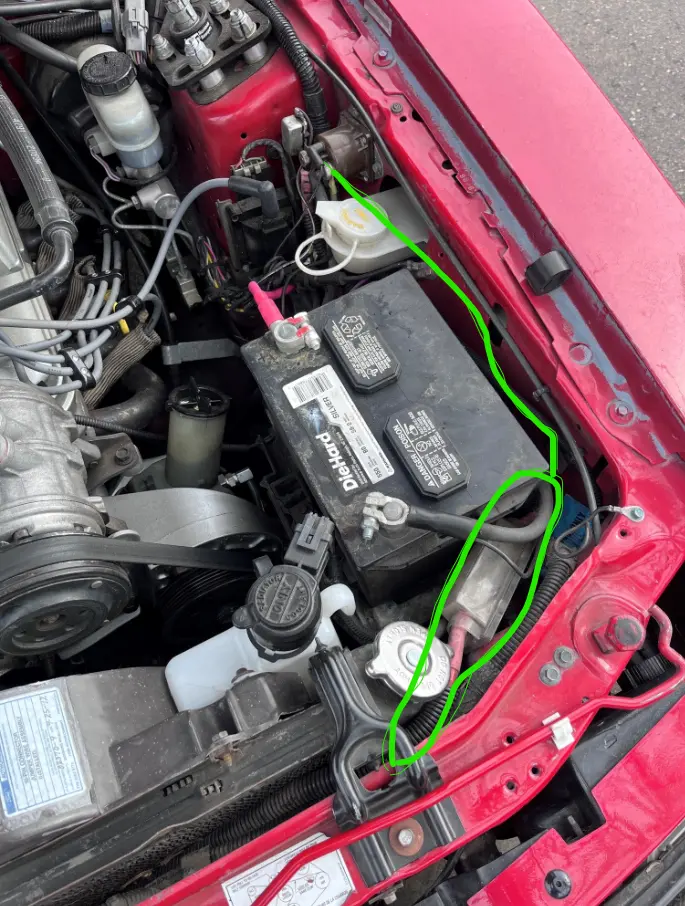

Back to the battery cable.
Here's the alternator cable with the fuse which i think is fine, just need to know if it running to the solenoid is better/worse than directly to the battery (from @AeroCoupe 's post saying dealer choice i guess it doesn't matter, unless it does because now my charging current flows back through the now smaller positive battery cable?):
and for reference here's the old positive battery cable i replaced. What it looks like the PO did was use a 2awg cable but a 0awg terminal and he stuffed two 'extra' wires in there so the terminal would work with the 2awg cable:
Now i just have a clean well built 4awg positive cable.

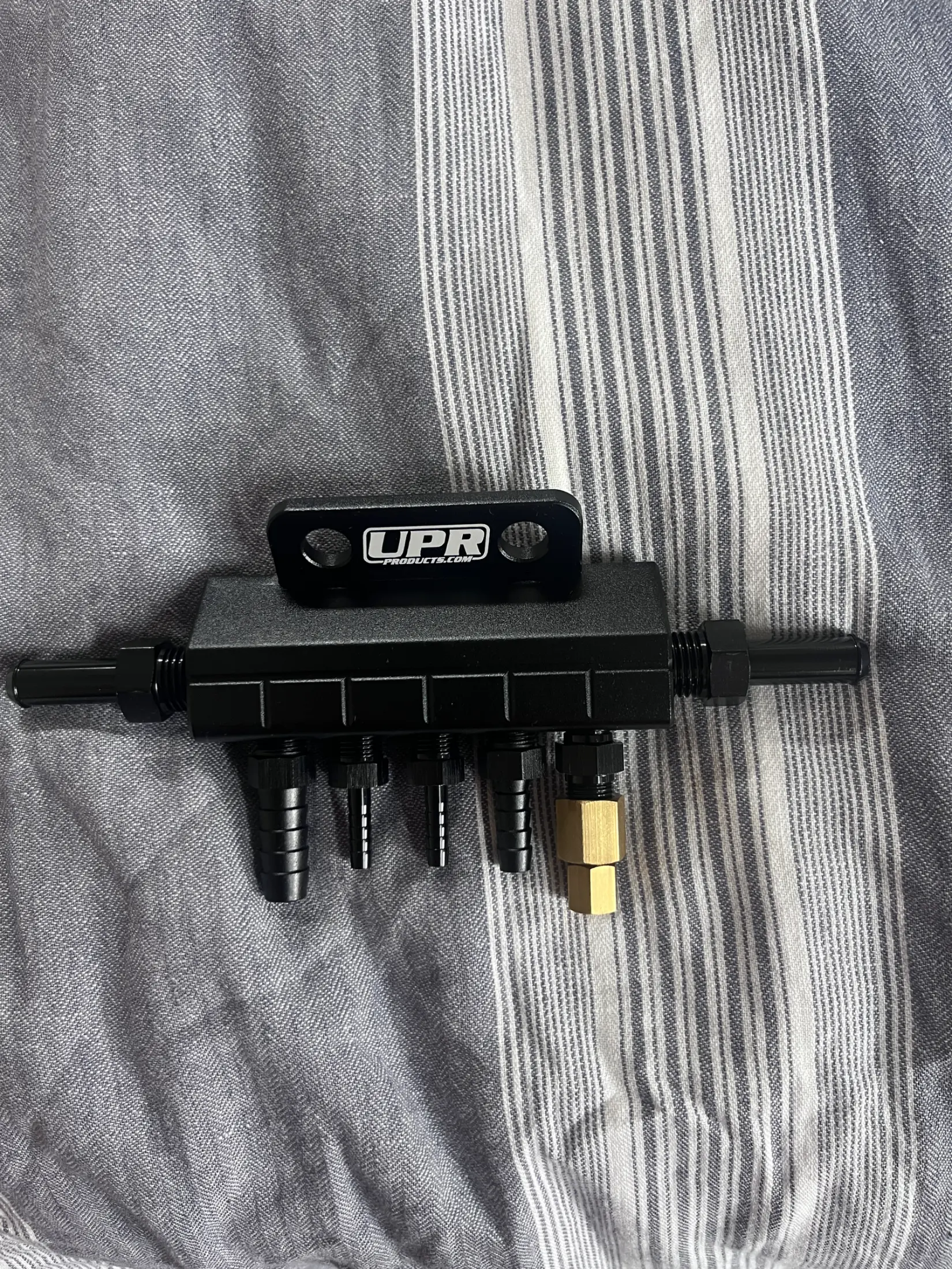

Well I may have done something right. Bought the correct NPT adapter to have a dedicated boost gauge line once I can get this installed finally:
I’ll take small victories with every other damn problem I’m experiencing.

Yeah man you are good either way. I would definitely look to see if he also upgraded the battery ground wire. I highly recommend you go battery to k-member and k-member to the block.

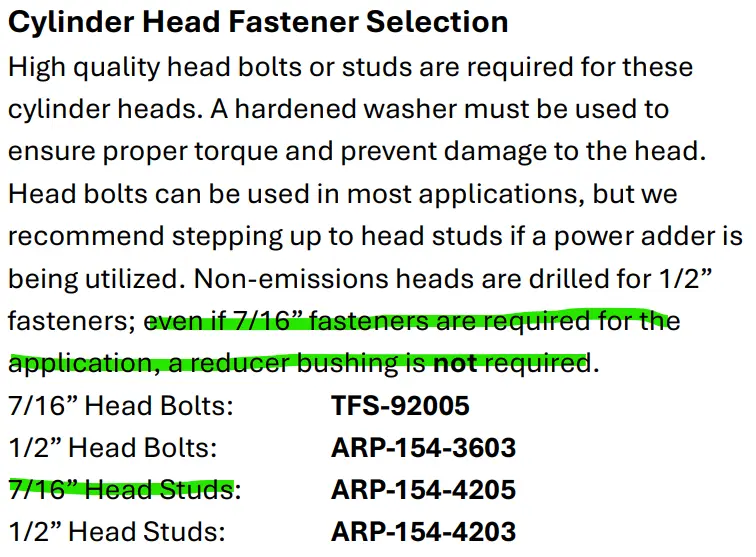

One thing I forgot to mention is to check the head bolt hole size on the heads. My guess is they are 1/2” and if that is the case you will need some machined bushings.
https://www.summitracing.com/parts/tfs-51400419?seid=srese1&gclid=EAIaIQobChMInLOM3vzjkwMVpYfCCB13myBEEAQYBSABEgIb7PD_BwE
As for the cylinder head alignment dowels you should be able to use the ones already on the motor. If you need new ones you can get them from most online stores:

Man this stuff makes my head spin. TrickFlow themselves recently sent me a Twisted Wedge specification sheet when i was asking about the guideplates and dowels and thermactor plugs. There is a note on it, shown here:
I have the ARP-154-4201 which are the 12pt 7/16" "Pro Series" studs, the ARP-154-4205 P/N listed above in their specification sheet seem to be the exact same ARP studs (12pt 7/16") but with reducer bushings.... so yes looks like i will need to buy reducer bushings. But i get it now, the Trickflow heads have a hole for 1/2" bolts/studs, our 302 block takes 7/16" bolts/studs so you need the reducer bushings to center the 7/16" bolts/studs inside the 1/2" head hole.
I feel like this stuff would all make more sense when you're actually doing the work with parts in front of you. Maybe i should try and hold off and tackle this install myself (good learning experience) when i'm back in the house.
