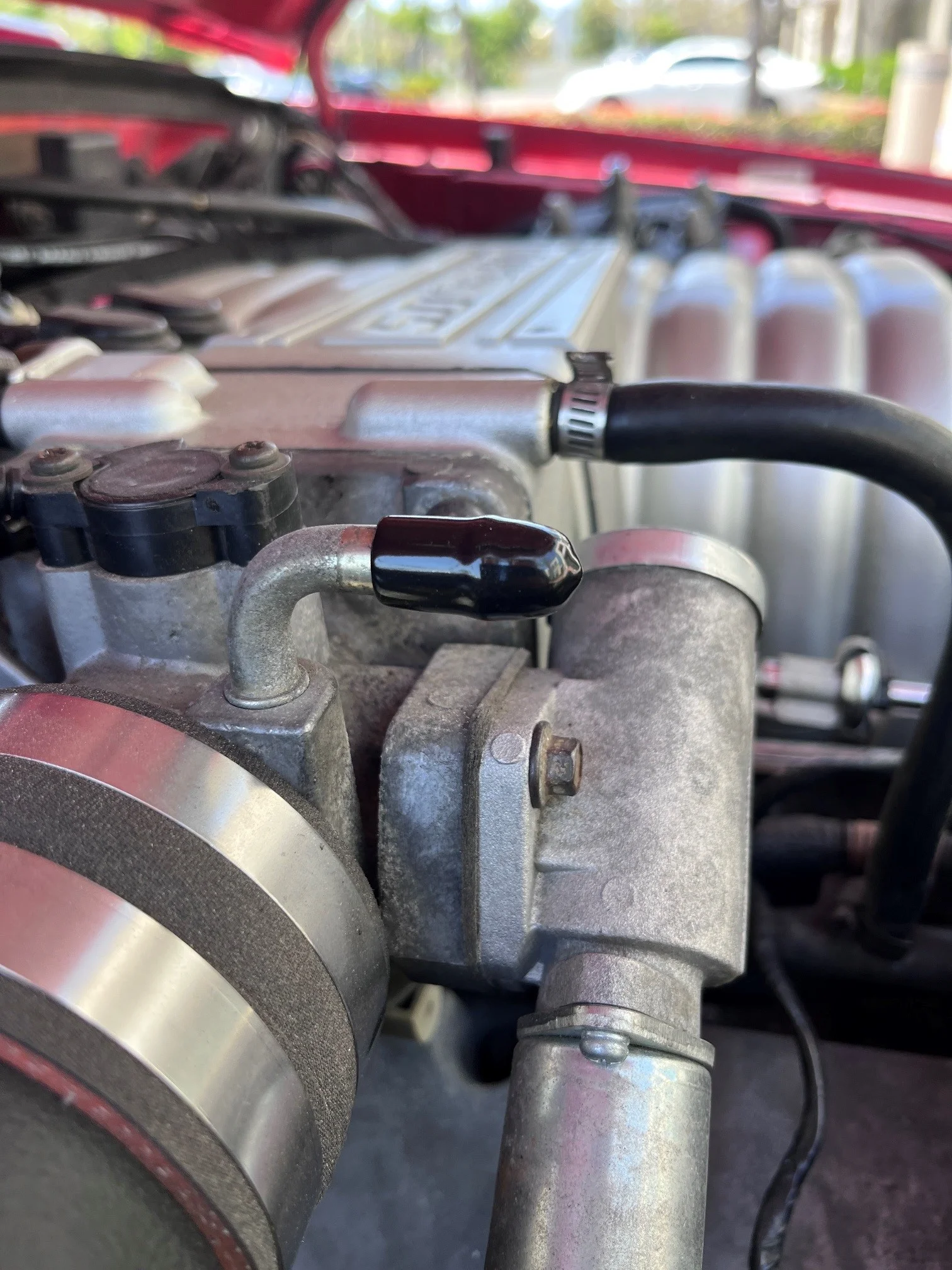

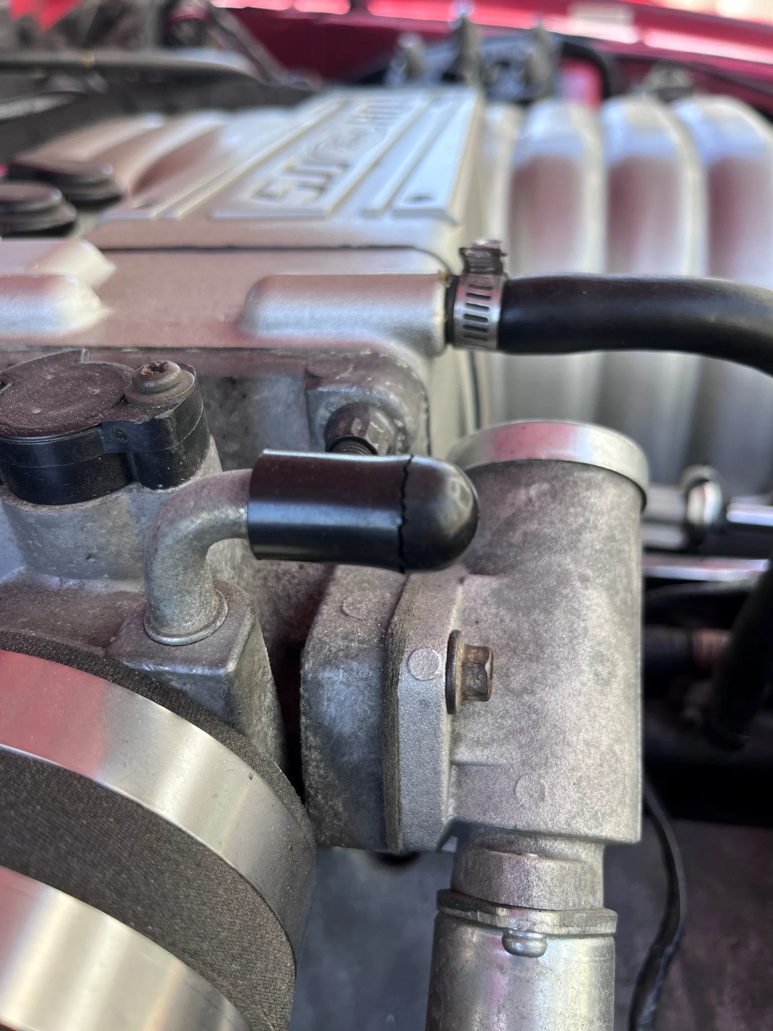

Was out adding just about a 1/4 qt of oil (not bad for the miles driven since last top off considering my issues), and noticed the cap on my Throttle Body was looking a little fubar. I believe this cap was new and provided with the Paxton kit. Surprised it looks like this:
So, I replaced it with a cap we have at work. However, i'll probably need to replace it again soon as i don't think the caps we use here are rated for high temps. They are just data cable caps to protect the connectors:
Edit: ya its going to be close. P/N is VC-343-16 and has a 'maximum continuous temperature" of 200 degrees and a "maximum intermittent temperature" of 350 degrees.

Yeah those vacuum caps don't last very long. I have them on my EGR spacer and have to replace them yearly. I am waiting to drop the MSPNP in the car and I am just going to delete the spacer. You could get some vacuum line and glue a copper tube cap in one end and then put it on that vacuum nipple on the TB and that would most likely seal it up for several years.

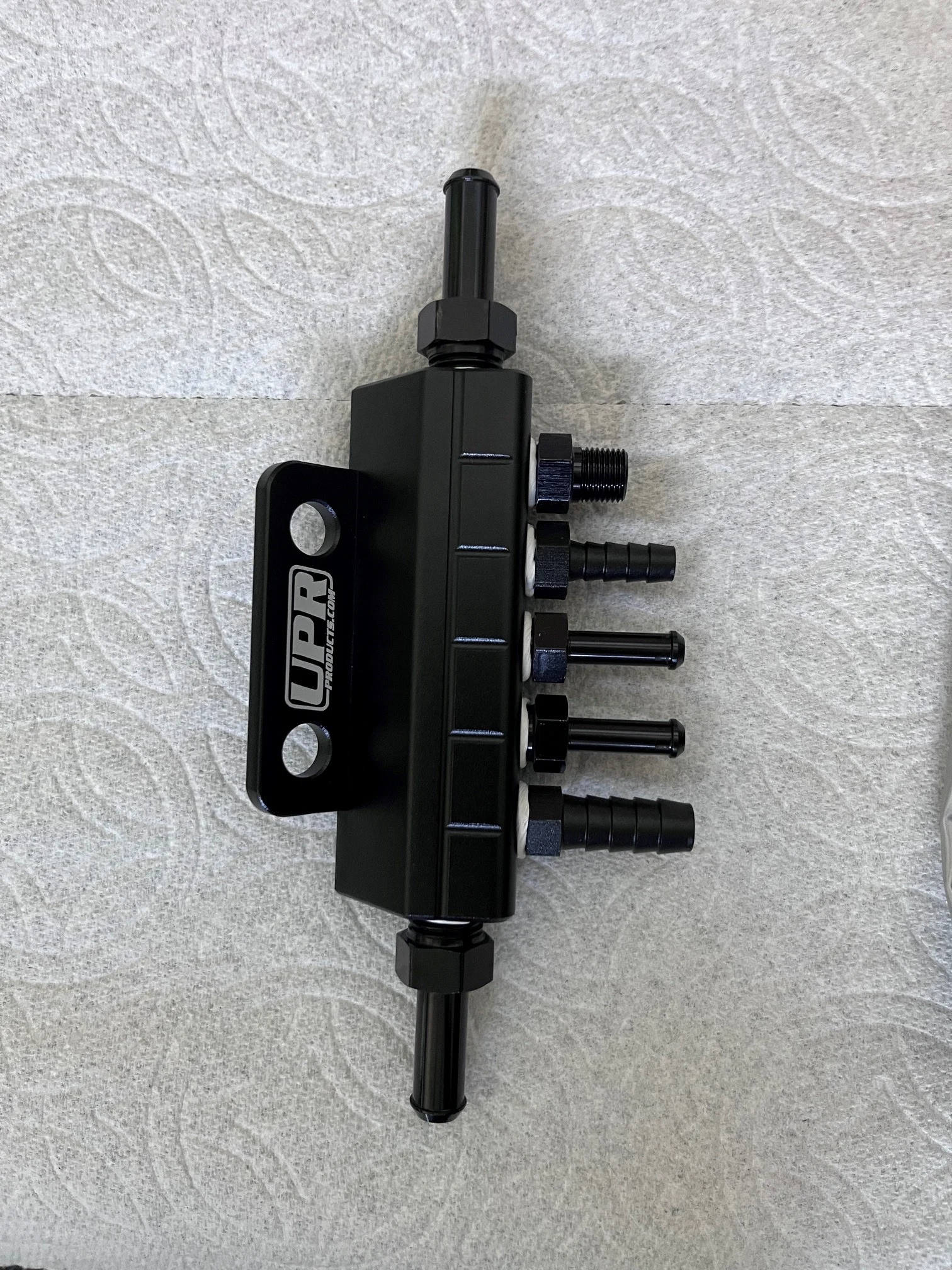

Got the UPR vacuum tree finished. May have went a little hambone with the thread sealer but it should be good. Only issue i foresee when putting it in, is the left most port, which i was going to designate as the 'source' port may hit the MAP/BAP (can't remember) sensor and bracket right next to the vacuum tree. So i may cap that one and use the left bottom most port for 'source':
The capped port will be used eventually when i install my bypass valve kit, which i already have.
I wish the UPR tree came with port plugs, or at least a couple. I guess i could have bought some instead of needing to cap unused ports.
But the vacuum lines will be (from left to right):
- Source
- Capped Off (?)
- FMU
- A/C
- S/C
- Boost Gauge
- Brake Booster

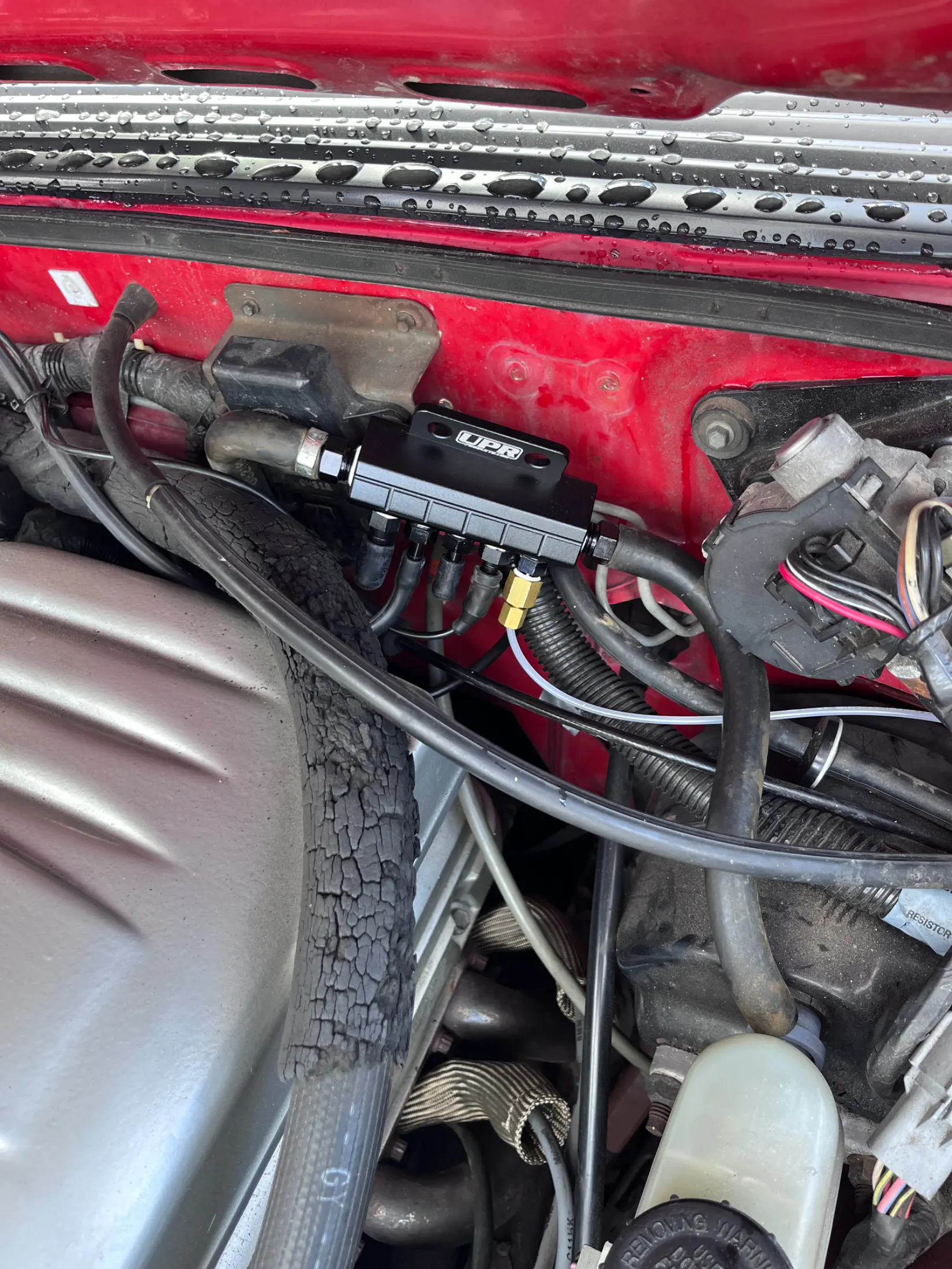

Got the tree installed. I need to trim both the booster and source lines as they are too long for the ports coming off the side of the UPR tree to mount the tree to the firewall. Like the lines can't be bent enough to get the tree close to the firewall. So it’s basically free hanging from those two lines and just hits the hood when it’s closed.
I also need real vacuum caps for the two open ports. I’m just using some from the vacuum pump kit for now, one is neon green and the other neon pink, lol.
I also need to buy some hose clamps just to be 100% sure all the lines are secure and leak free.
With that said I started the car up and it held 20hg of vacuum just idling. So at least I know the guage is working again.
Edit: the more i think about it, the more i want to redo most of it. I.e. redo vacuum lines (FMU line is a little short), redo my boost gauge line (its a little twisted up), real vacuum caps, etc. Basically make it look nice. Looks like garbage at the moment.

Vacuum caps came in but nothing else yet so here’s my temp situation:

I have the source going to the bottom left. That way its not hitting for MAP sensor. Then you can run one of the smaller lines behind the MAP sensor bracket to the left side barb. Just a thought.

Alright, swapped the source line from the far left to the left bottom. Now i'm able to just get the capped far left port to sit under the MAP sensor bracket. After removing the brake booster line from the far right, i can get the tree to sit flush with the holes in the firewall. However (and i should have thought of/measured beforehand) the far right port (for the brake booster) just won't work, the actual port, with no hose even connected to it, hits the wiper motor. I could probably clearance that to make it fit as i checked the bracket and where it hits is not important, but moving around ports is probably the best way to make it cleaner.
For some reason i had envisioned the two large vacuum lines coming/leaving from the sides then having all the small lines coming off the bottom, but i just don't think it will work like that.
Moving the source line to the bottom makes it 'better' but i still can't bolt it to the firewall in its current configuration.
