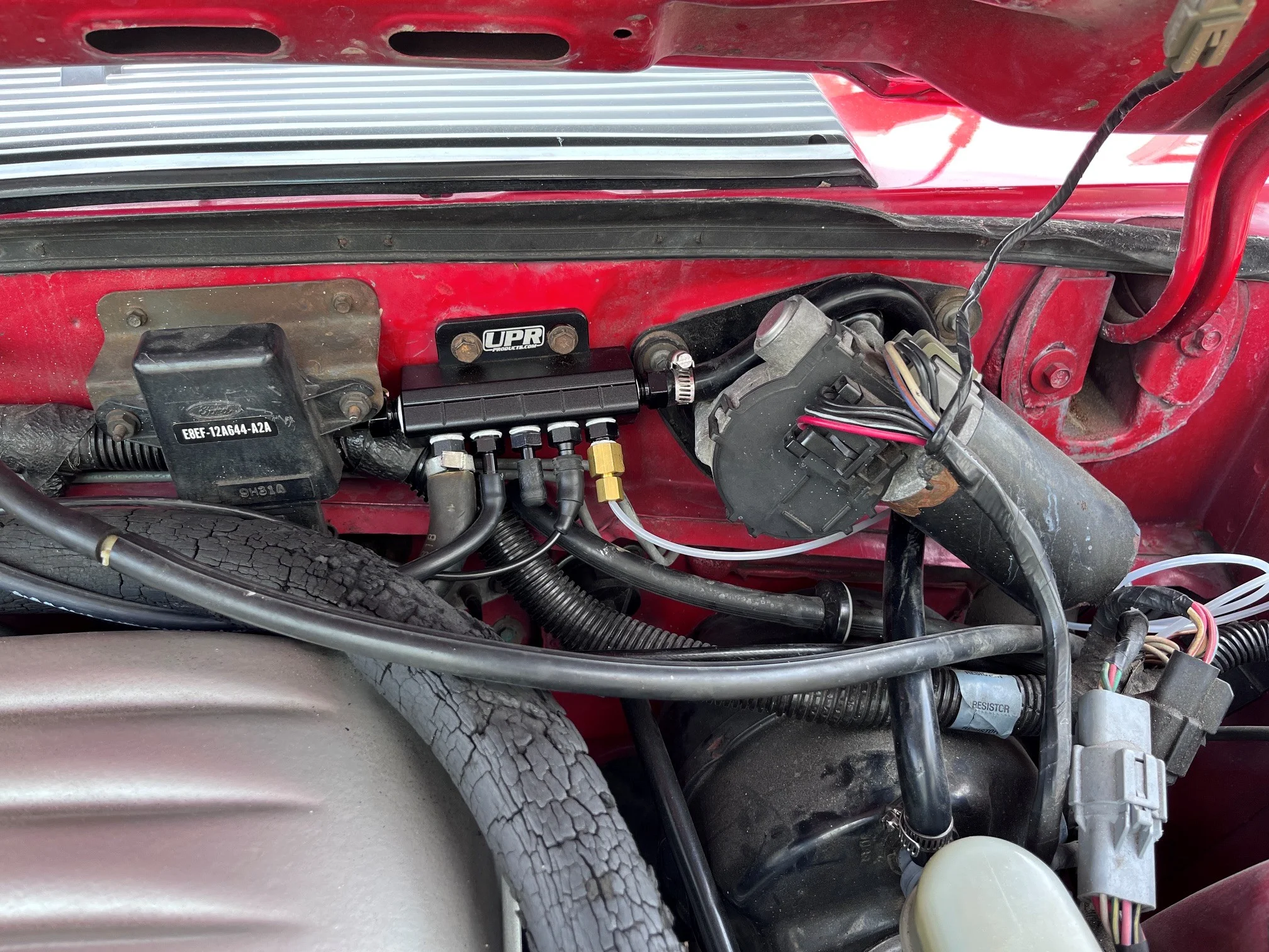

On another note, i was able to get my UPR vacuum tree bolted back to the firewall by running a new rerouted vacuum line from the brake booster:
No pinches in the line and its only like a couple inches max longer than the OEM one i took off.

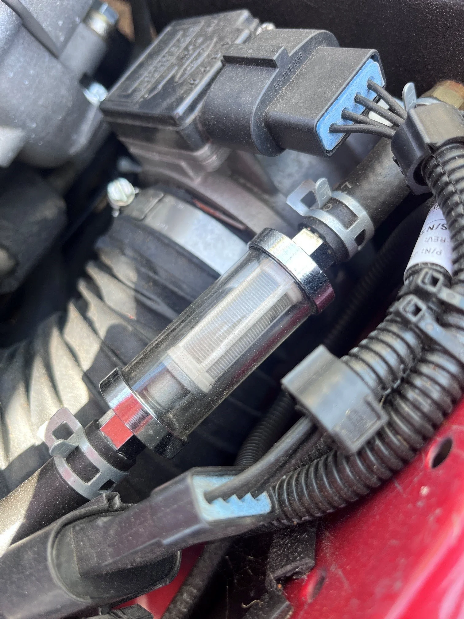

Since i don't have access to my smoke machine at the moment - if i removed my 'source' line on the vacuum tree and hooked up my little vacuum pump to that port, would the little pump be able to pressurize everything else connected to the vacuum tree to see if i'm leaking anywhere else within those connections? What would be left would be the FMU, Brake Booster, A/C, Cruise Control and Boost Gauge. Not sure if that pump is strong enough.
Also, I switched out my new Paxton oil fill neck to airbox filter with a clear one... i've never seen nor smelled (prior to getting the clear filter) oil in this, but i'm starting to see some. Would this be any indication of something wrong?
Its kind of hard to see but the filter has some light oil like from the halfway mark going right towards the airbox. Its pretty faint in the picture. By 'wrong', i mean like does that mean my PCV can't keep up with the crankcase pressure?
