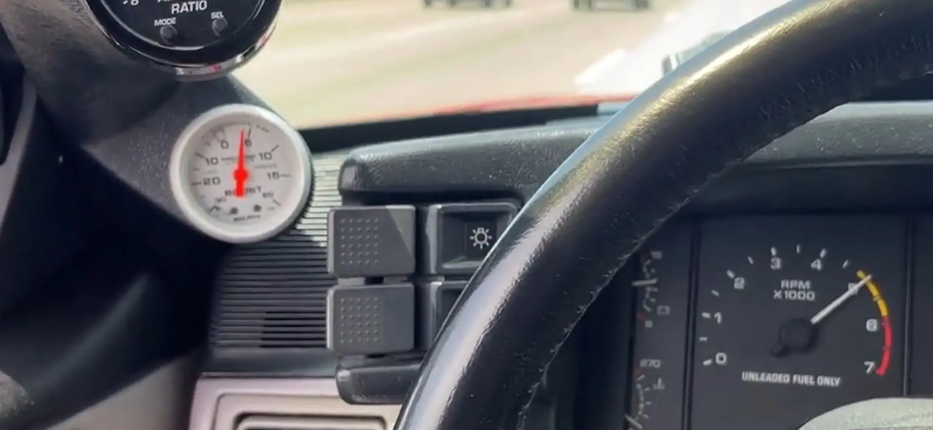

The AFR gauge showed in the 10’s on that pull… is that too rich? Gauge is kinda hard to read on video but I rewatched and rewatched the video on my phone and I can clearly see 10’s.

Ok I stand corrected on the boost psi. Revved it out until it cuts out and I think I saw almost 5psi.
So ya here’s a video of it going up till it does its cut out thing:
View: https://youtu.be/0K3bLIA253k?si=6UADcjYUTxYW0ApW
Nice. Looks like a solid 4psi at 5k.
I can't really hear what's going on there at the end. I really doubt it spart blowout at those levels, but its easy and cheap to try.
