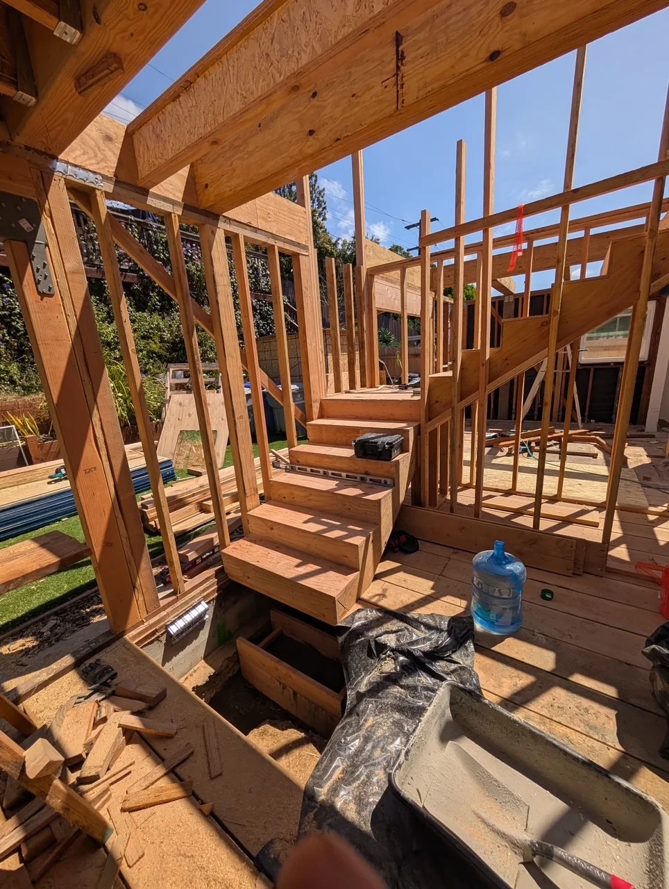

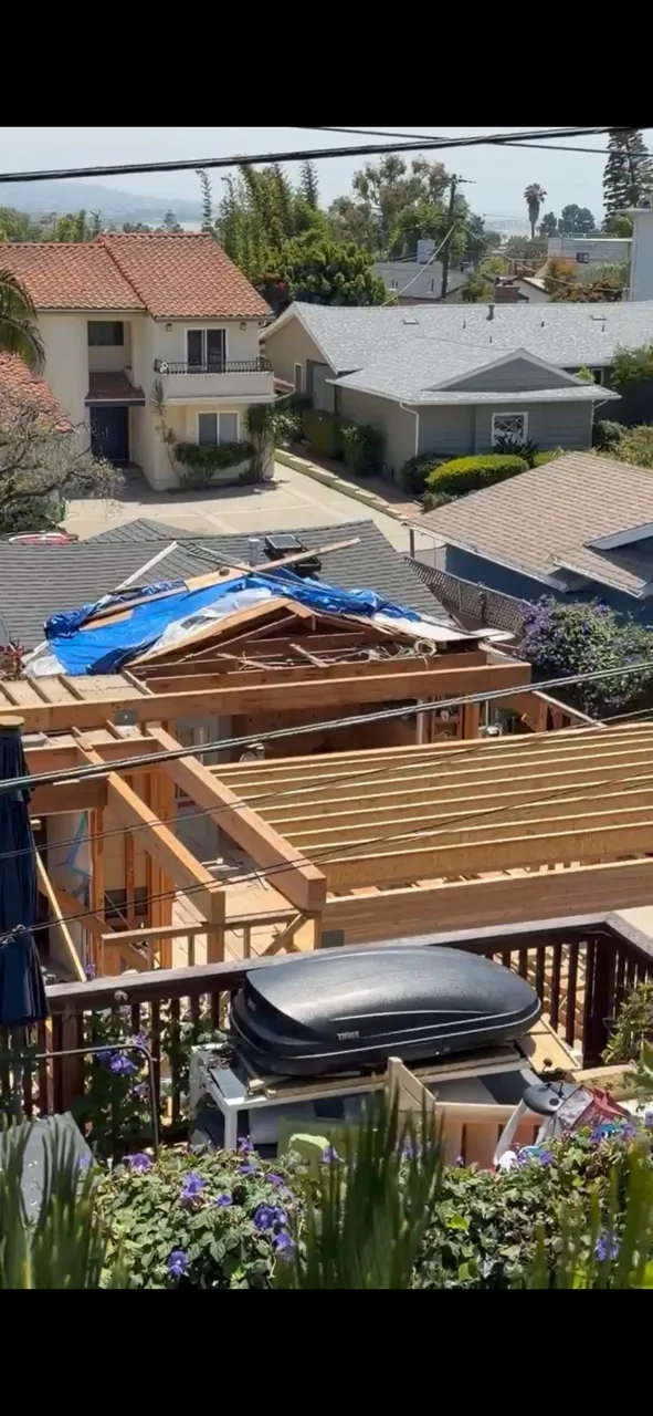

Man, I just want to be back in my house already! So much to do with the car. Framing is underway... construction PM said the second story should start next week:
Backyard neighbor took a video, this is just a snapshot.
Reactions: 91AOD5.0LX, 85GT4V, nicholase and 1 other person

Ooo we got stairs!
Reactions: 85GT4V, DadLife0724, nicholase and 1 other person
