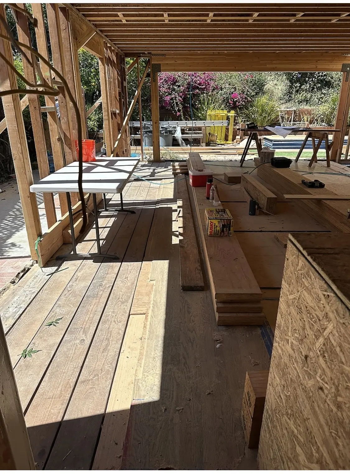

Still no car updates… except when I was out replacing the FMU vacuum hose a younger mom pushing her baby walked by and said “rad car I love it!”. Kinda surprised me. Anyways, more home updates:
Here you can see where that damned expensive bi-fold door will go. They have it framed in:
Should make for a nice indoor/outdoor space.
Don’t mind our jungle for landscaping. We’ve stopped all efforts on landscaping during this process.
