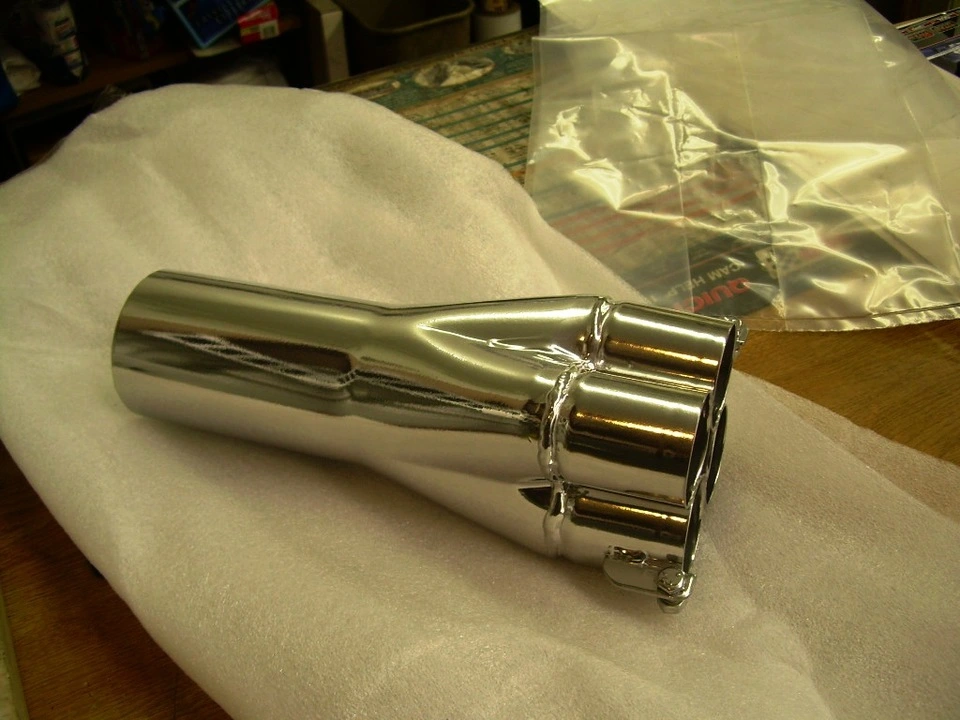

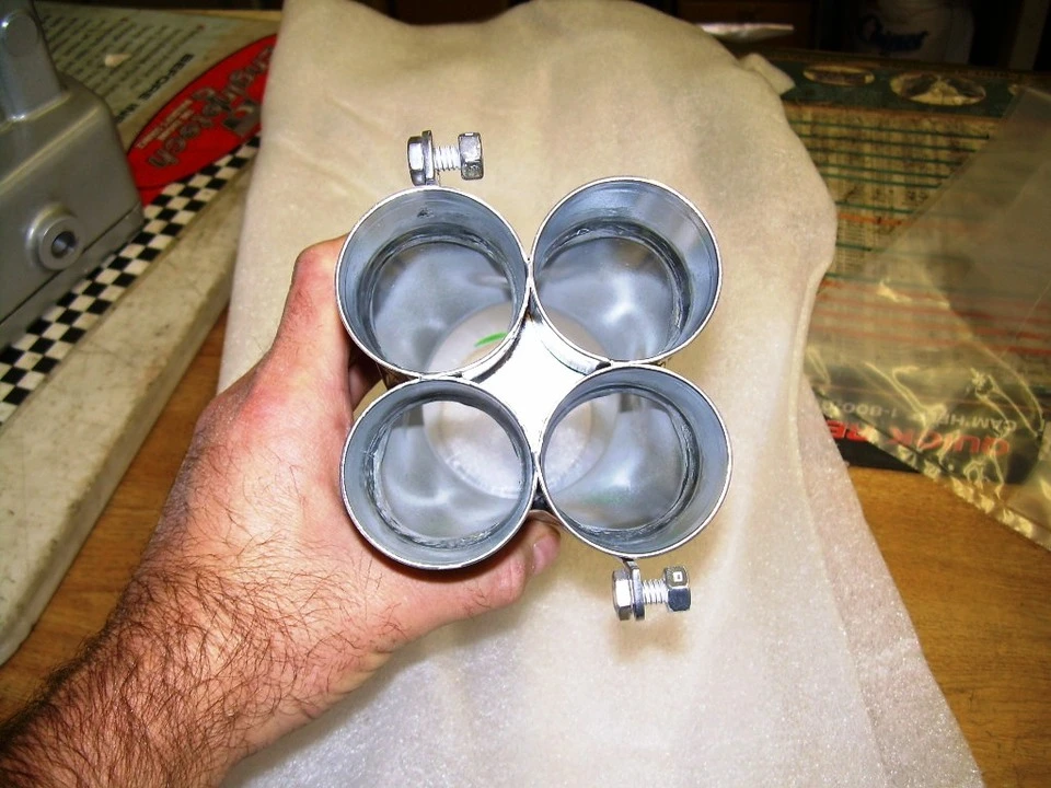

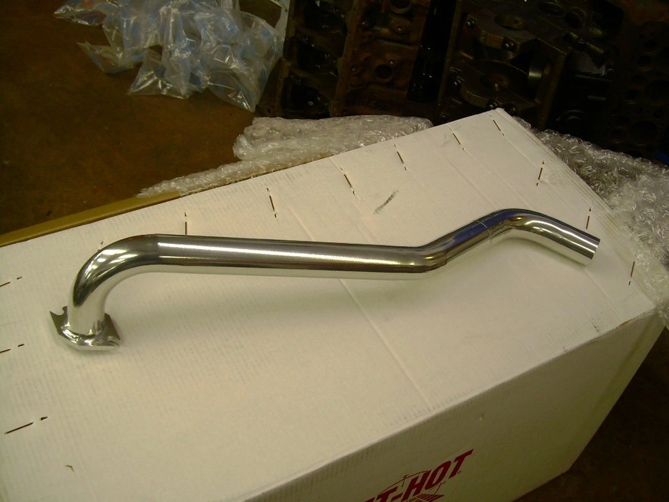

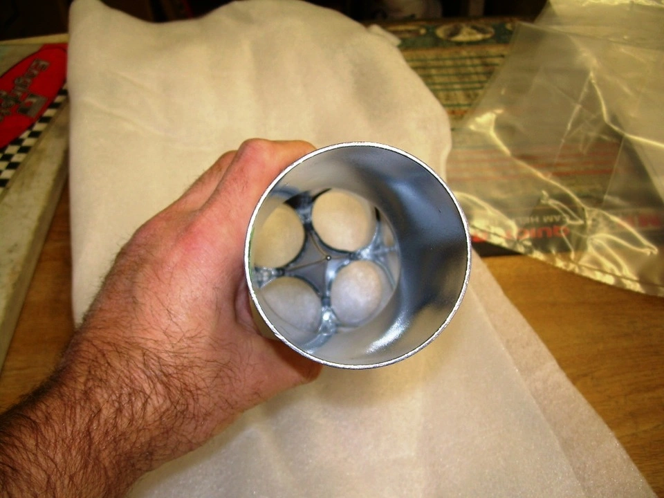

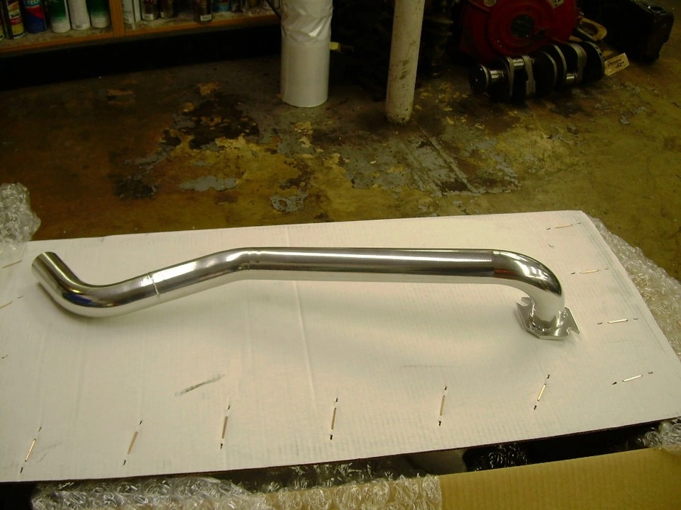

for those who haven't seen kooks, here are a couple of pics of mine ... they are jet-hot coated ...

They don't always seal. Most of the time when you get everything together they seal just from being a nice tight fit. I've had to use orange silicone on mine before though. My car is so loud I usually can’t tell if mine are leaking or not.
Orange silicone? I might have to find some of that, my pass side header is leaking at the collector. Driver side is nice and tight.
Make sure to put the silicone on the individual tubes not inside the collector. That way any excess gets pushedout where you can wipe it up rather than into the collector where it becomes a big rubber glob that restricts your exhaust. I figured that out the hard way.
