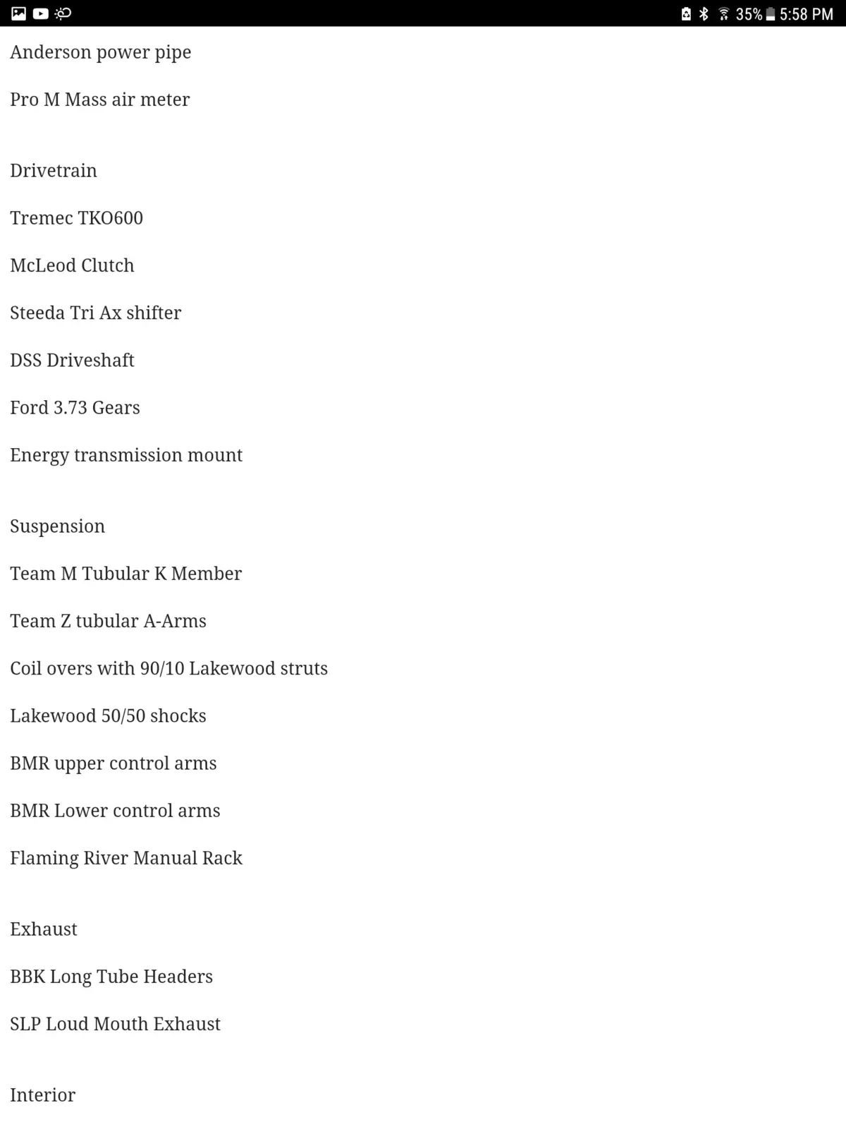

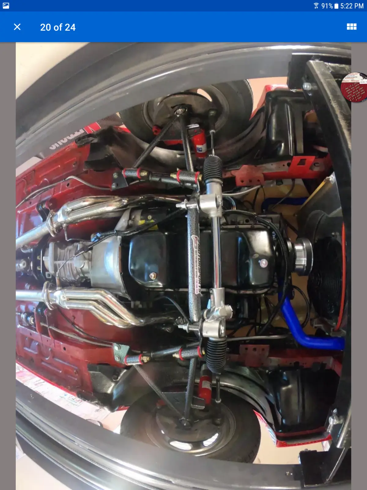

Thanks for the reply. Here is a pic of my front suspension. Here's a screenshot of what I have installed. Can you recommend an OEM-ish spring/strut that will work with my current aftermarket suspension? Thanks

Unfortunately you will not be able to run OEM type springs on that suspension due to the tubular lower control arms lacking spring perches. You'll need to stick with coil overs, or swap to stock style arms, which may not be possible with that particular k-member.
Do you know which brand coil over is on the strut? I do not believe Lakewood makes coil overs.
No, I'm not sure what they are. So another coilovers that isn't a "drag type" would be an improvement then? Any specific one you can recommend? Thanks again.
