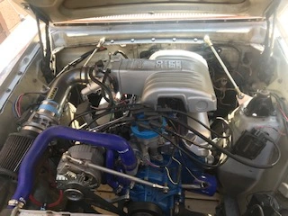

I recently transplanted a 1987 EFI 5.0 engine into my 1960 ford falcon. Changed from speed density to mass air but otherwise pretty straight forward swap. Because of the year of the falcon I removed all emissions crap-no cats, not EGR-just motor.
I rigged a check engine light and it is losing its mind. Ran some codes with a test light and they are all coming back emissions related. Not sure what to do to bypass this.
Also, engine is running really rough and sluggish-even had a couple of mild back-fires. Had 1.3V on the tps so I fixed that, put new 02 sensors on, all plugs are new, everything was completely disassembled and cleaned during the swap so there is no clog anywhere. Used a new after market fuel pump that is supplying about 38 with car running which is a little low but within specs. Fuel regulator seems to be working well, timing is correct-but it just sounds like I have a big cam in it-sort of lopes and is FAR from the extremely loud but steady purr of my brothers former ride.

To my knowledge no 87s were mass air. If it is a 87 computer it's speed density and can't be modified for mass air. You'll need to get a mass air computer. Since you are running a auto the A9P would do the trick.
Also check your MAP in a SD car it connects to the intake manifold for vacuum. In a mass air car it becomes a BAP and has no vacuum line connected to it.

So am I correct in assuming you converted the car to mass air, and now it's going haywire? How did you convert it? What harness did you use? Did you repin the ecu? What directions did you follow? Finally, did you swap the ECU out when you did this? If not, then that is your issue.
Still, you need to pull the ecu and ID it. There's a 3-digit code on the box we need ot ID if it's an auto or 5-spd ECU. This matters in recommending which ECU to purchase, and how to jumper the o2 harness, although 1987 harnesses didn not use this jumper.
