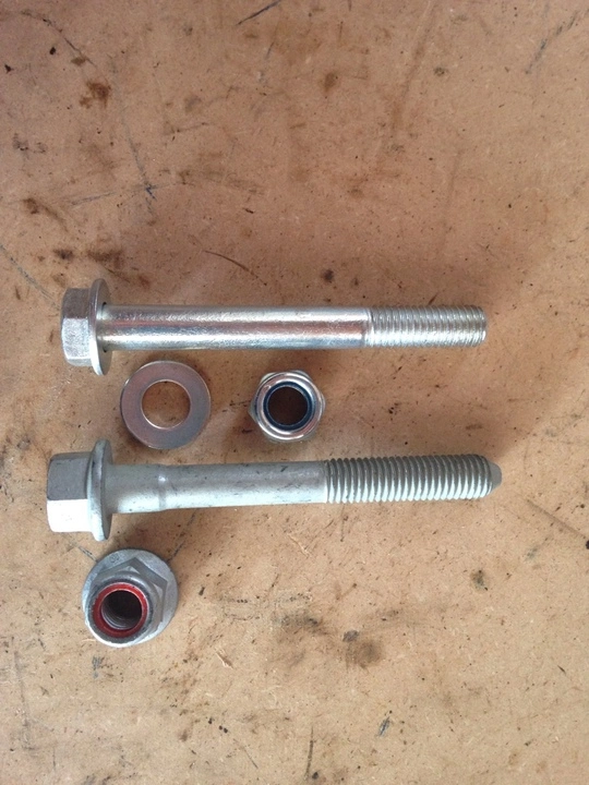

On the subject of the proper grade LCA hardware; I bought that hardware set from LRS earlier and comparing it to the original hardware it was obvious they were not comparable quality. I wanted to get the car done ASAP so I used them anyway and when I went to torque the LCA bolts to spec they immediately stripped out.
After some searching and calling around I found a Lincoln dealer (they really sell only Lincolns) 2 hours away that had the proper OEM grade 10.9 flange bolts. For what it's worth the guys at the parts desk said suspension hardware should always be grade 10.9 (Grade 8 SAE as already mentioned). The difference between the bolts is night and day. The hex head is taller for more bite from your socket, the tip is tapered, it's the proper coating, etc...
In LRS' defense when I called, Jay said if I send him a picture of the striped bolts he'll give me a credit for the kit. Problem is I can't even get the nuts off now, I guess I'm gonna have to cut them off but I just haven't had the time to work on it yet.
Picture of the new OEM Ford bolt next to LRS':

If LRS is using poor quality Grade 5 bolts then that's a shame. Quality can vary depending on who manufactured the hardware. I've worked a lot with both grades 5 & 8 bolts and neither of them should strip unless you're over torquing the hardware. It's easy to get a nut cross threaded and mess up threads but that's not the bolts fault.

Ya know since you guys brought up this hardware issue now I know it wasn't just me. I also had problems with the bolts stripping on a SVE rear control arm kit I bought and installed on my '88 a couple years ago.
I ended up re-using the old stock hardware from my old control arms.

I was using a torque wrench, I wanted to do it right the first time. The other side with the new Ford bolt torqued to spec perfectly with no problems.
