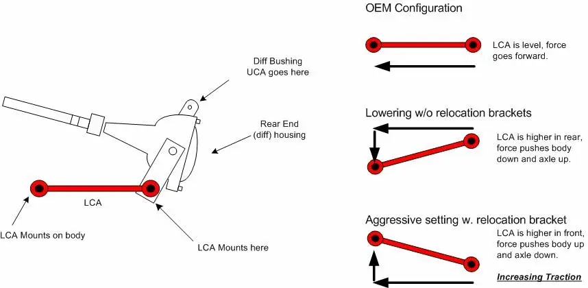

OK, I see that a lot of the different LCAs recommend relocation brackets. if I change the LCAs with stock height(I plan to keep stock GT springs) - Do I still need to get relocation brackets? Or will it work well with the regular stock mount points?
I like to reference this picture. As stated above, you don't typically need relocation brackets unless you lower ride height or want a more aggressive setting. The stock setting is neutral which gives some leeway for the tires to break loose. A negative slope is more aggressive (in a simple sense, think of the wheels having more force pushing them down into the ground) and can lead to more traction but you probably won't take full advantage of that in stock form. You do not want a positive slope because it will result in more traction issues (opposite effect of negative slope configuration). You can call and ask the vendor if there a specific reason why they recommend relocation brackets with their products. The typical recommendation I've seen for street cars is neutral or slightly negative slope.
