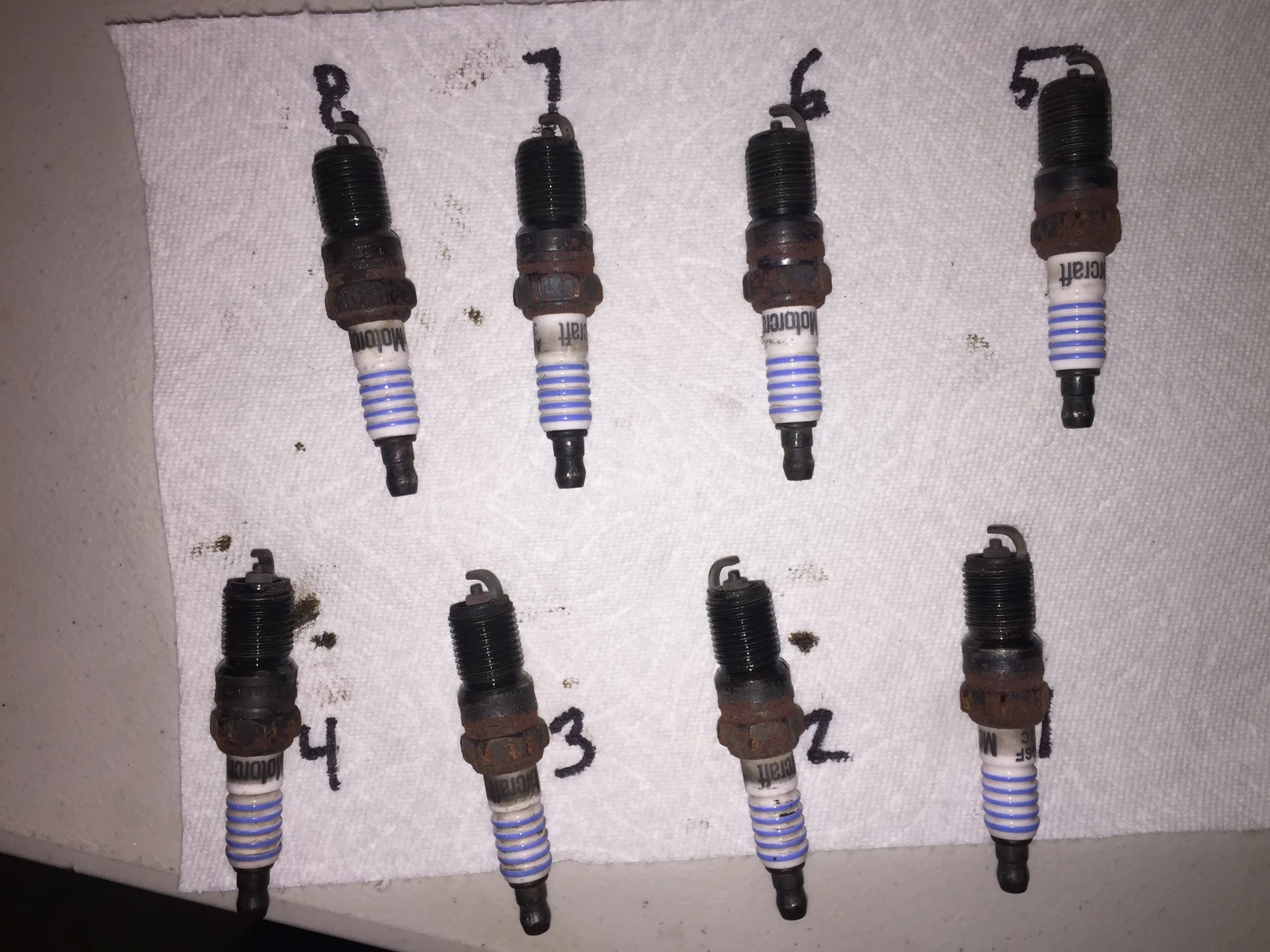

Those plugs don't look all cruddy like you have bad rings, how long they been in there?
3 months/200 miles at most
General karthief
Mod Dude
Aug 25, 2016
28,142
10,761
213
polk county florida
Jan 4, 2018
#22
  • Jan 4, 2018
  • #22
That explains that, what did the old plugs look like?
I can guess
Cruddy
fredfifty
5 Year Member
Nov 23, 2011
318
57
59
SF Bay Area
Jan 4, 2018
#23
  • Jan 4, 2018
  • #23
Not at all, these were plugs i took out prior. No idea on miles on them....im guessing quite alot....atleast 10-20k miles
I can guess
Cruddy

Those plugs don't match that cruddy header either
Indeed. Thats why im hoping its just a valve seal that went bad just after i put the new plugs in.

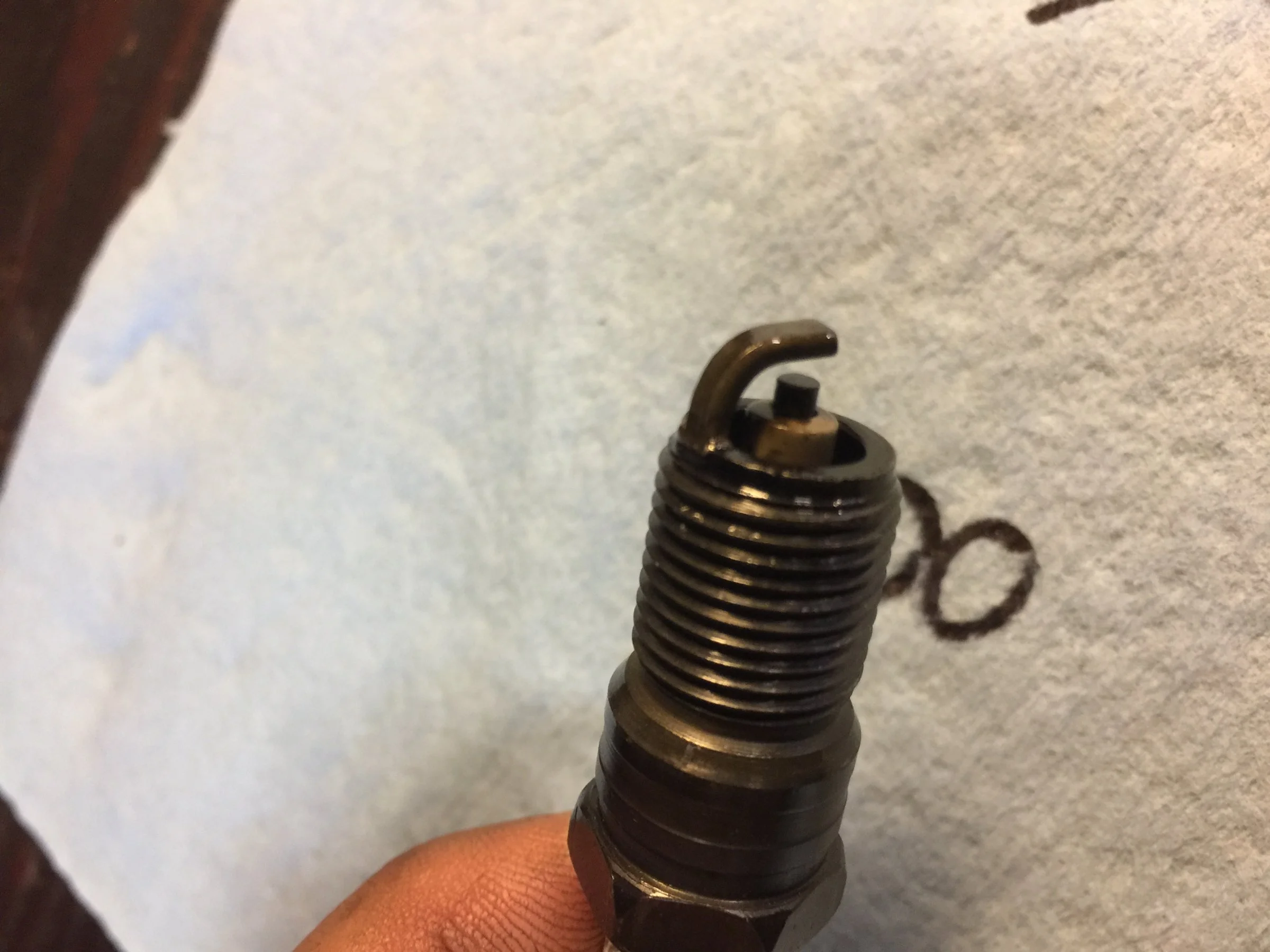

karthief said:
My compression gauge will hold pressure untill you hit the Schrader valve, am I missing something?
What did the #8 plug look like?
Here is #8 plug

General karthief

Squirt a little oil in the hole and see what happens
