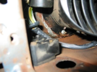

I have a leak where the inner cowl panel (metal behind kick panel) meets the firewall and cowl above.left of water pump. It is rusted out allowing water to flow in. I just had the car painted, came out beautiful, I am being told in order to fix it I have to take out the cowl and fenders to fix it. This would ruin my paint job #1 and at this point fairly costly. The guy at NPD said I could use POR-15 to seal the opening from inside the car. Any thoughts or suggestions would be appreciated.
If you want to do it "right" you know already what has to be done. Front has to come off the car, windshield out, dash out as well, drill a couple hundred spot welds....
Most other methods are just patch work IMO. To get an idea just how bad your cowl is you can pull out the fresh air exchanger on the drivers side, and the heater cowl on the passenger side.

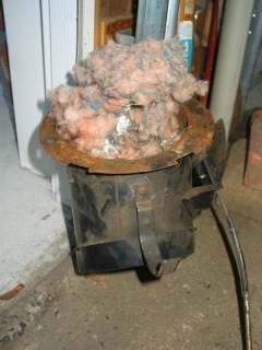

Best of Luck & I feel your pain <Mouse + Nest = Drip!>

Although cowl leaks are fairly common in older cars, don't overlook the windshield gasket. If it isn't sealed correctly, it will leak on the floor boards too.
There really isn't a good news scenario if your cowl is leaking. As tommytorino says, you can drop the air vent and the heater box and do some work through the hole (standing on your head.) Minor repairs can be done this way-it is just not fun (but neither is scratching your new paint.). Perhaps an aftermarket vent hat will help too. The cowl cover mentioned will also help, but you will need to remove it for the heater to function properly.
Tommytorino also made a good point in that once you get the water stopped, you should pull your carpet and check out those floor pans.
