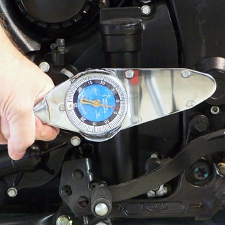

To measure the preload you mount a large socket on an inch-pound torque wrench, like this:
(really should be a dial-type)
and rotate the pinion in its normal direction of rotation, noting the steady-state torque required to turn it. It might be, say, 15in-lbs. Remember this number.
Take the pinion nut off, remove the drive flange, oil slinger etc and replace the seal. When you re-assemble it, don't just impact the pinion nut in place. Instead, tighten it and measure the torque to turn the pinion again. Keep tightening the pinion nut until you see the same number -- e.g. 15inlbs -- you saw before taking it apart.
You have to sneak up on the torque (preload). If you go too far, you'll crush the sleeve and won't be able to get back to the desired preload without replacing it.
